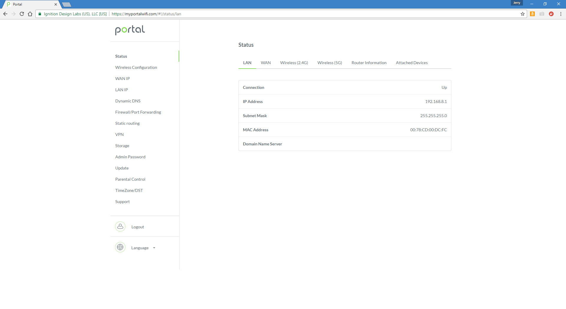

Portal's web interface
Setup is dead simple. You can use an Android or iOS app to set things up but there is also a web interface for people who prefer it. All the standard features like forwarding and MAC filtering are available, and while there were a few early hiccups the software has continuously been updated and there are no pain points for most users.
