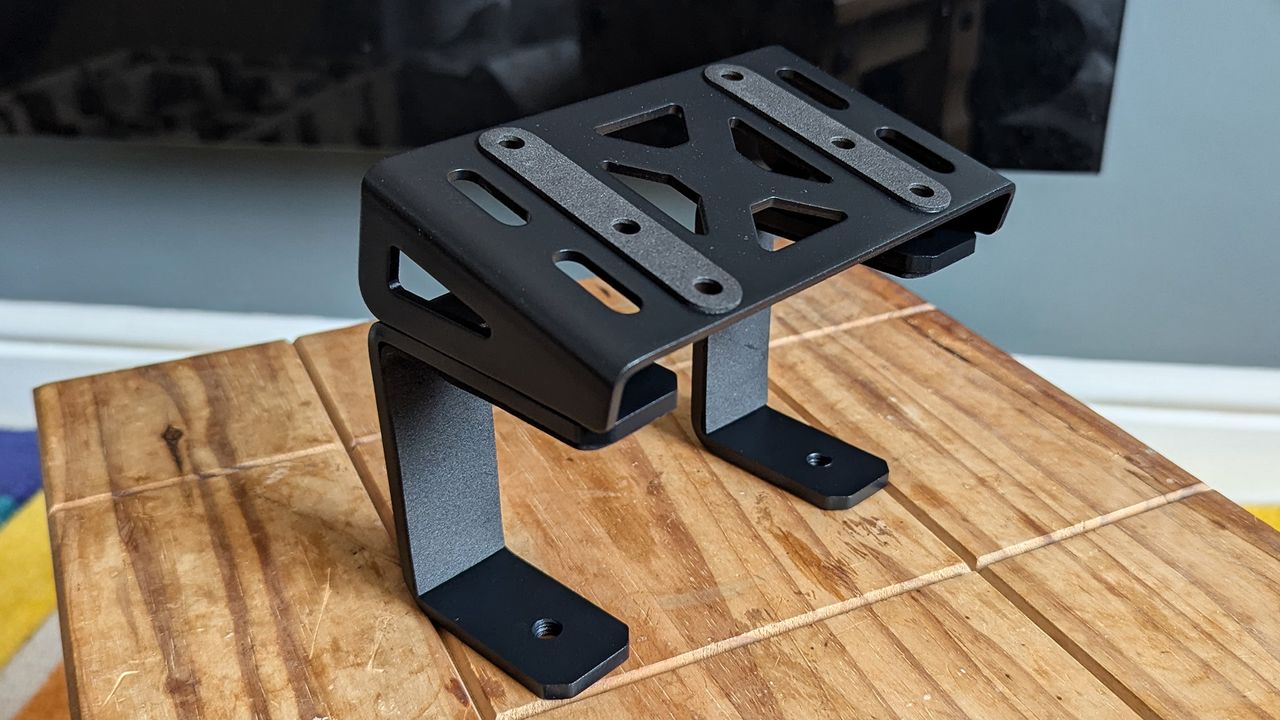

Despite the build-it-yourself nature of many direct drive wheelbases and rims, MOZA includes everything you need to start sim racing on Xbox and PC. It might seem daunting to someone who never set up a racing wheel separate from a servo base, especially with the several bags of tiny screws and accompanying pint-sized tools. Still, there aren't too many necessary steps to connect everything; it just takes patience.

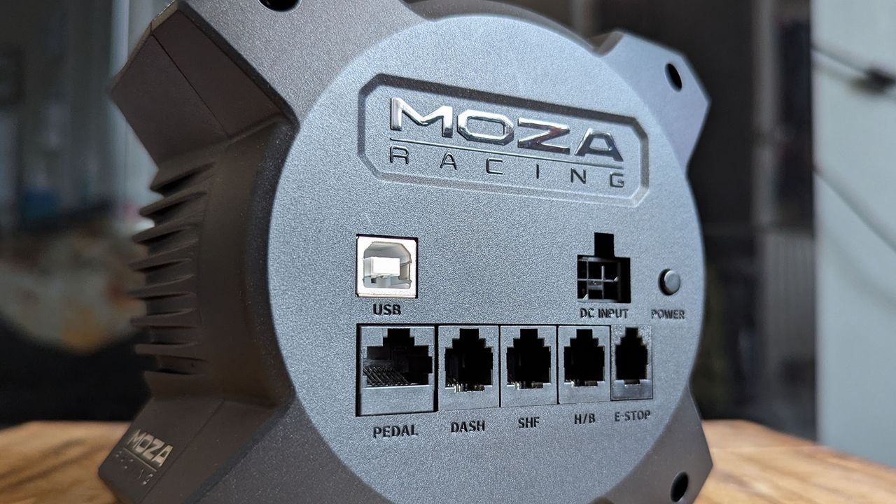

First, the included desk clamp requires a bit of fiddly construction to attach two tiny cups that help support it on the underside of whatever sturdy surface you have. From there, four M6 screws fix the clamp into the R3 DD base with spacers in between. After that, it's an excellent time to connect the SR-P Lite pedal board, power supply, and USB-A to USB-B cable, carefully managing each as you go to keep things tidy and minimize the risk of accidental disconnections.

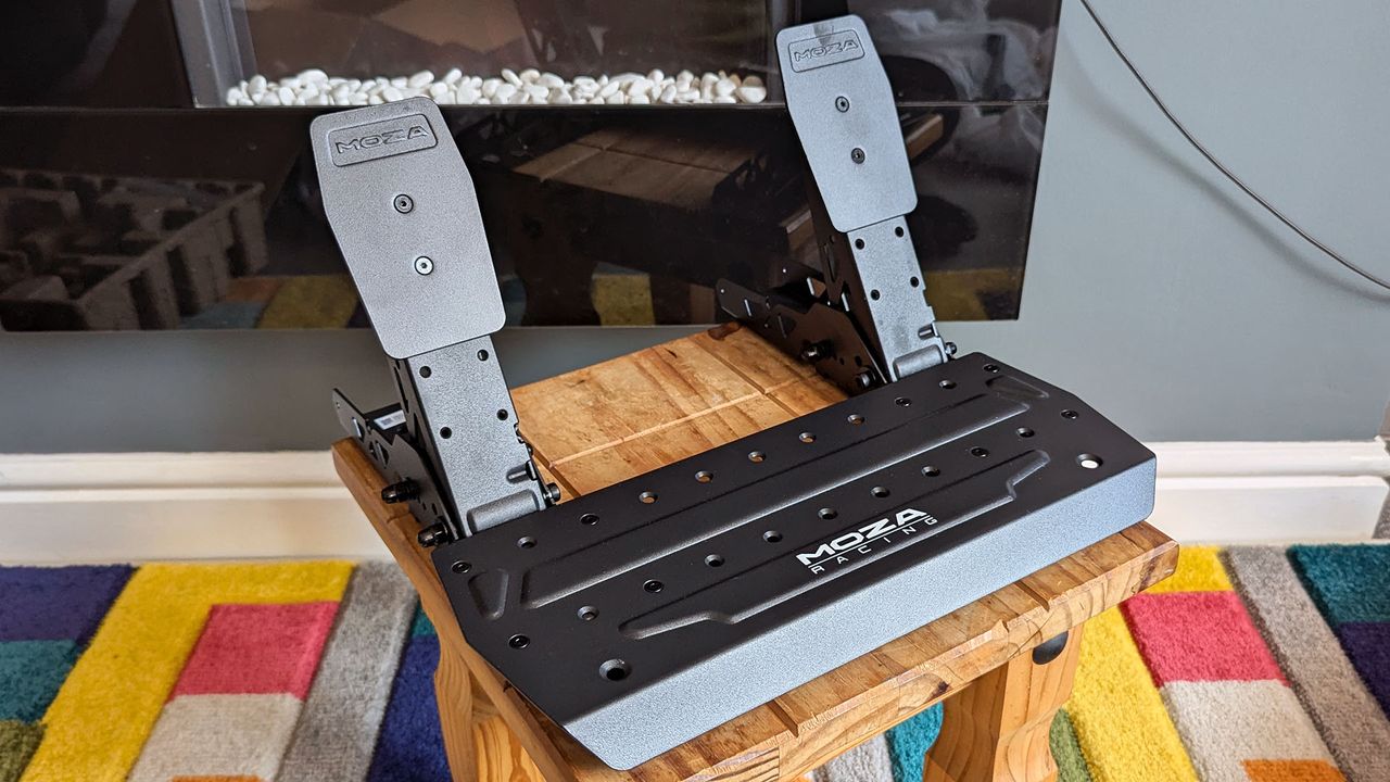

You can adjust the gas, brake, and additional clutch pedals on the SR-P Lite board for spacing, and the pedal plates themselves can move up or down by removing the nuts with an included spanner. Ideally, I'd recommend fixing the entire footrest onto something static like a foldable racing wheel stand because they're ultra-lightweight and highly susceptible to slips during intense gameplay. Otherwise, the wheelbase connection is accessible by default from the left side.

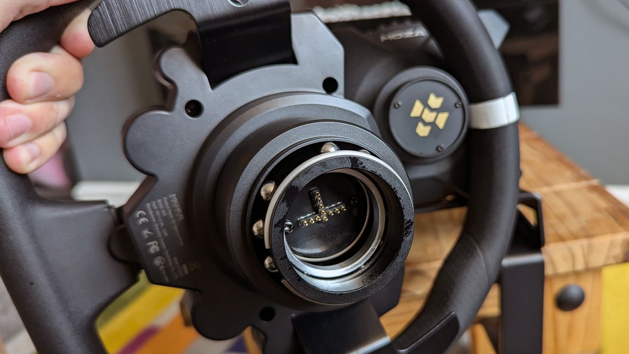

Finally, the R3 DD direct drive base uses a ball-bearing setup to connect MOZA's quick-release wheels, such as the included MOZA ES rim. I only need to check that each sphere indent aligns with the proper pattern on the neck of the wheel and apply a firm push to click it into place. When I hook up the AC power and USB cable to my Xbox, the whole thing comes to life with a press of the rear power button and boot into 'Xbox mode' as standard (pressing and holding S1 and S2 changes to PC mode).

As compact and adorable as the R3 DD base is, its 3.9Nm motor is surprisingly robust. Considering I've tested direct drive bases pushing their torque almost too high, like with Thrustmaster's 10Nm on the T818 and Logitech's 11Nm on the G PRO, this plucky little servo puts up an admirable fight with considerable power in its force feedback alongside the ultra-smooth luxuries of a direct drive system. Pairing it with the included desk clamp makes sense at this range, preventing the destruction of weak tables.
For years, I've recommended Thrustmaster's T248X wheel for Xbox because it struck a balance between price and performance, but you had to settle for a hybrid motor that exhibits some granular feedback during small turns. With MOZA's R3 bundle, Xbox gamers have a truly affordable way to access the best technology for sim racing without needing to go all-out on a dedicated cockpit, though they might 'graduate' to that later.

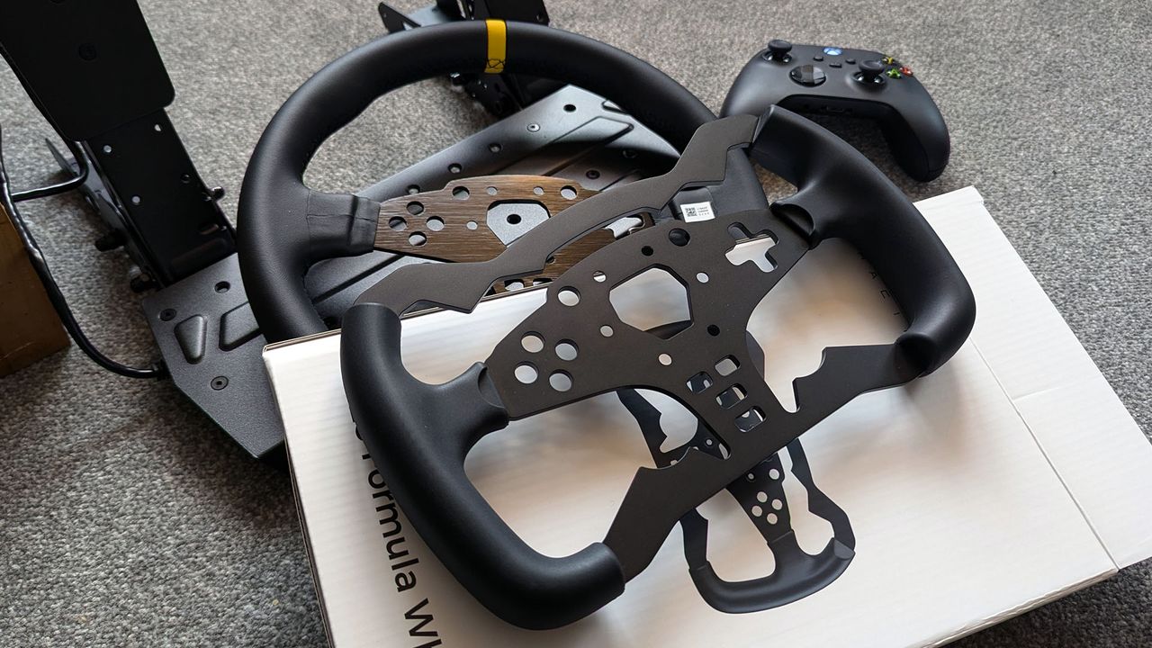

Modular wheel rims also give MOZA an edge over the competition, as it only takes the removal of a few simple screws to swap to an F1-style ES Formula plate that retains the face buttons and inputs of the standard rim. Want something bigger for loose drifts? Swap to the 12-inch round ES wheel mod with the same method. It's that easy, even if it feels more manual than the quick-release system on the neck of the rim.

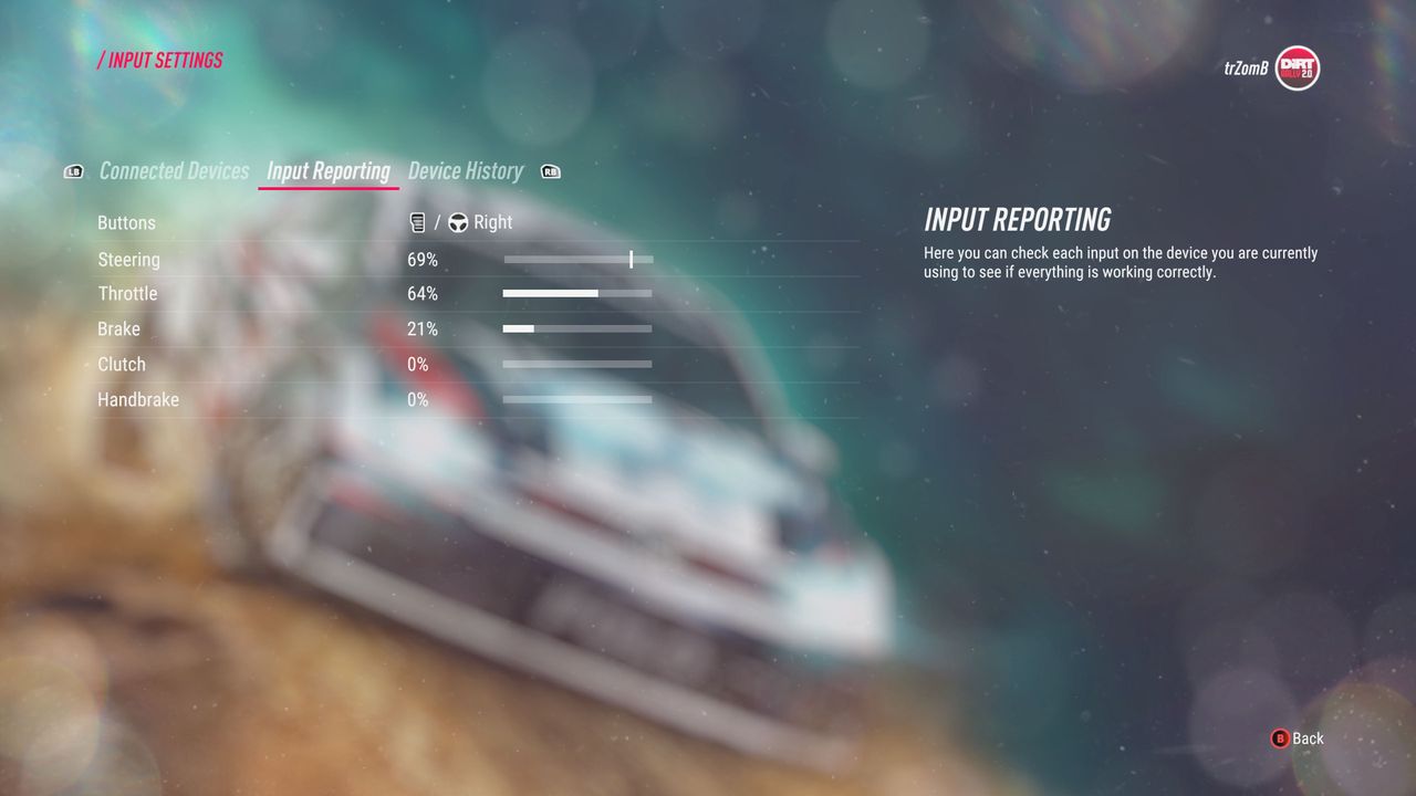

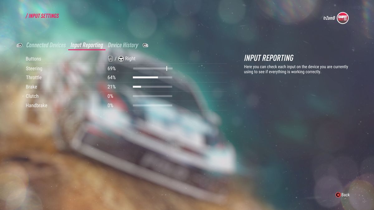

On my Xbox Series X, the R3's RPM meter flashes from its sides to the center to confirm a successful connection, and the d-pad navigates my dashboard as it should. DIRT Rally 2.0 even has a section in its settings to show live feedback on the steering percentages and the pressure detection of each connected pedal. You can further customize settings via the MOZA Pit House app on PC or its MOZA RACING app on Android via Bluetooth, but the defaults are smooth and forceful enough.
