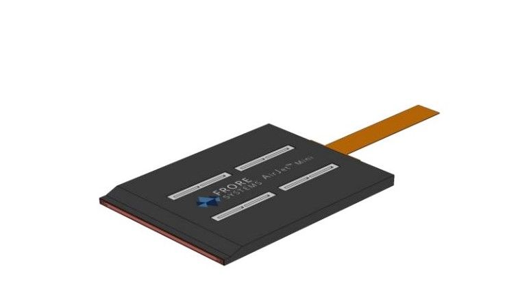

Image of Frore Airjet mini inside a Steam Deck
Frore says the Airjet Mini will let the Steam Deck run cooler and fit a bigger battery. (Image credit: Frore)

Frore's claims in official advertisements almost seem too good to be true. 5.25 watts of cooling with only 1 watt of power consumption means that devices like the SteamDeck could run much cooler while removing the fan completely, allowing an increased battery to be used. Per the Frore explainer on handhelds, this would lead to less power consumption than the fan, around 10 degrees cooler, and longer battery life.

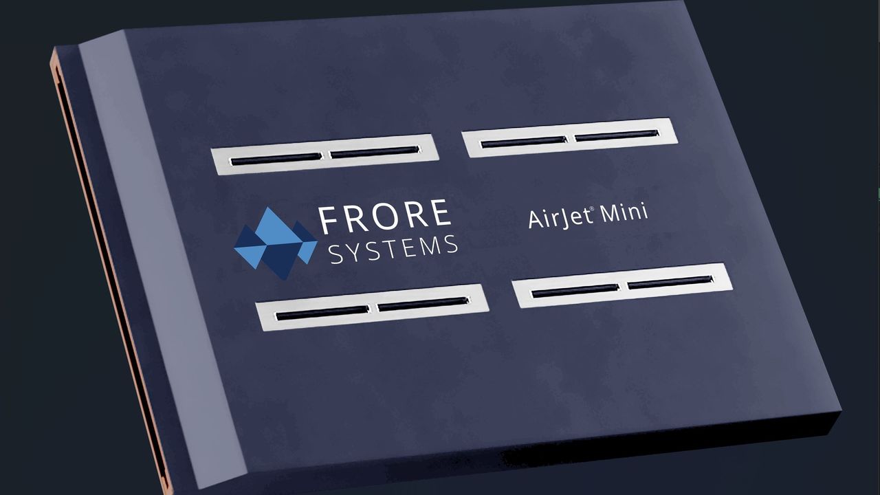

The R&D that went into the Airjet was substantial. The actual technology is cutting-edge and will be hard for others to replicate for some time since Frore had to create new manufacturing methods to create the chips they use. For those of us who want all of the in-depth details, Frore provided a PDF about the Frore Airjet. Breaking it all down, here are some key specs for the Frore Airjet Mini:
  • Total heat dissipation - 5.25 Watts
  • Maximum noise inside the device - 21 dBa
  • Maximum power consumption - 1 Watt
  • Back pressure - 1750 Pascals
  • Dimensions - 27.5 x 41.5 x 2
  • Weight - 11 grams
  • Dustproof
It's a marvel that that small cooler can provide so much cooling. Frore sees a future where their Airjet is cooling devices such as solid-state drives, tablets, mini PCs, fanless laptops, handheld gaming devices, VR headsets, and even smartphones. Plenty of phones are becoming powerful enough to play some AAA games, and Xbox's head Phil Spencer agrees they need to be relevant on mobile devices. Android and iOS phones will have a hard time staying cool as more and more demanding games make their way into our pockets.
Inside AirJet, tiny membranes vibrate at an ultrasonic frequency, generating a powerful flow of air and removing heat from a spreader at the bottom.
Frore
