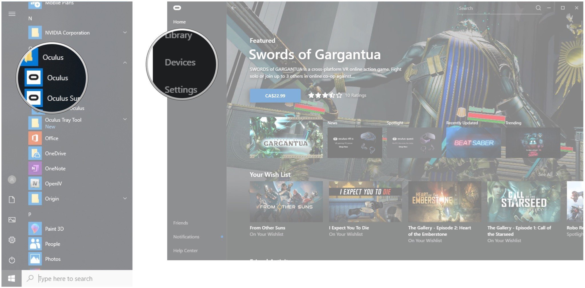

  1. Launch the Oculus app from your taskbar, desktop, or Start menu.
  2. Click Devices.
