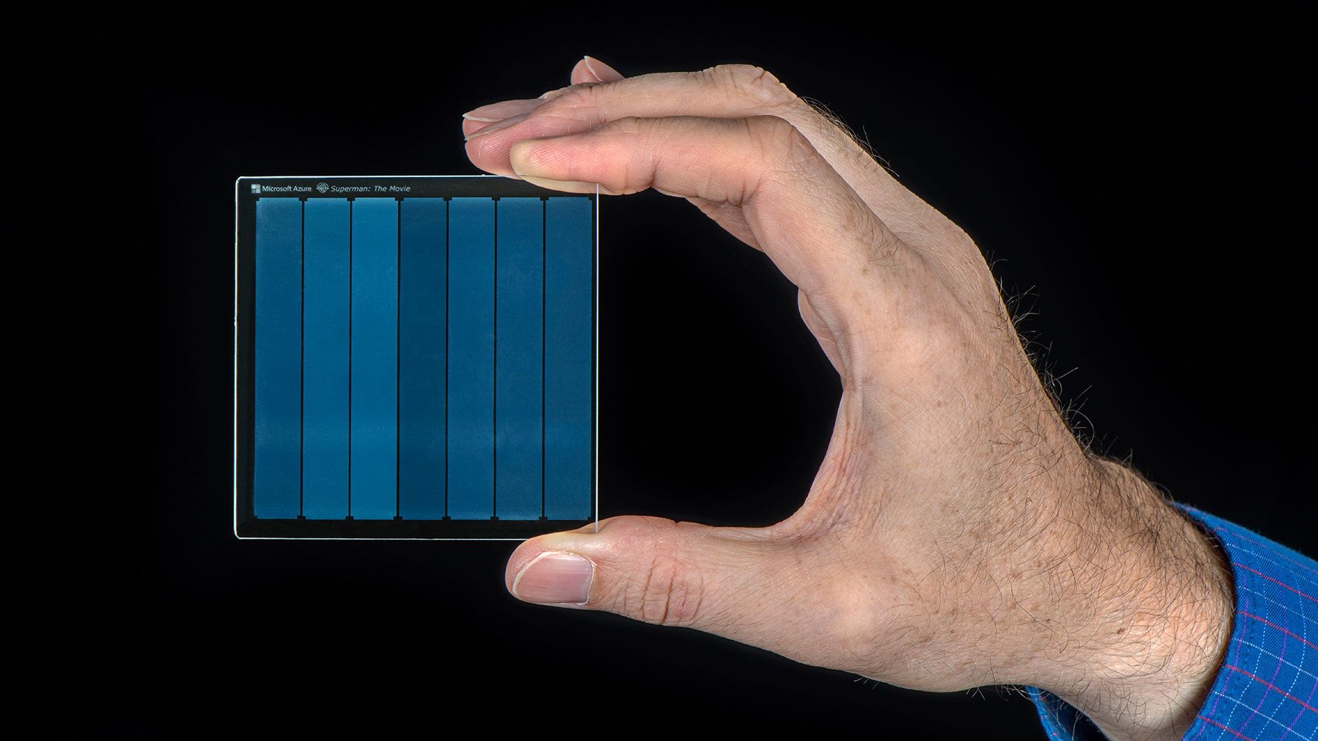

The research paper published in Nature details how the team can store hundreds of layers of data on a piece of glass that's just 2mm thick. When we first saw Project Silica in 2019, the machinery involved in writing data to glass was massive. Microsoft said it was working on miniaturizing the process.
That claim is now a reality. Reading data from glass used to require three or four cameras; now it only needs one. On the right side, the devices have been simplified to the point where they're easier to create and calibrate, speeding up the entire writing process.
As an example of Project Silica's progress, Microsoft's team was able to fit 4.8TB of data onto a piece of glass measuring 2mm by 120mm (or about 0.08 x 4.72 inches). The data is separated into 301 layers and was written at a speed of about 3.13MB/s.
