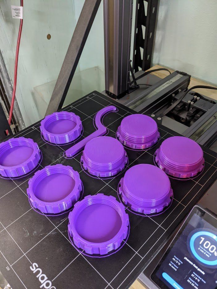

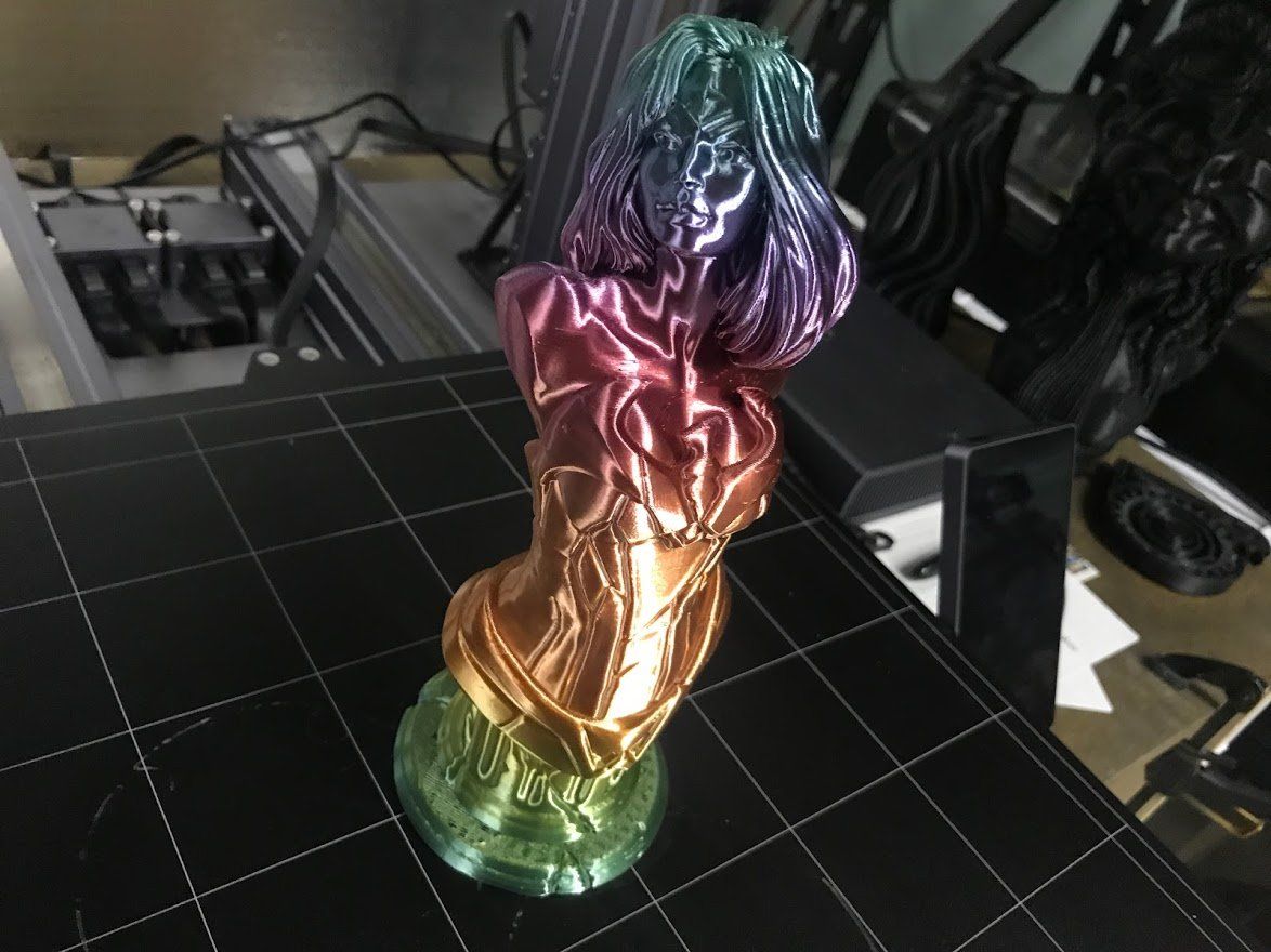

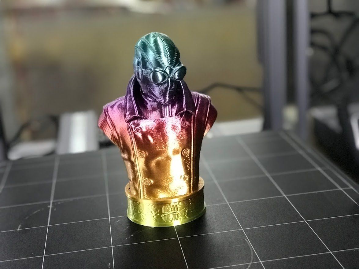

The 3D printed models the Snapmaker 2 was able to produce have been amazing. Each model I printed came out excellent after a little fine-tuning, from a small Wonder Woman statue to a full-sized Mandolorian helmet. Luban, the software the Snapmaker comes with, isn't the most powerful 3D printing slicer, but it is easy enough to use your preferred slicer for better results. The Mandolorian helmet took a massive 125 hours to print and worked flawlessly. As a standalone 3D printer, the Snapmaker 2 does a fine job.

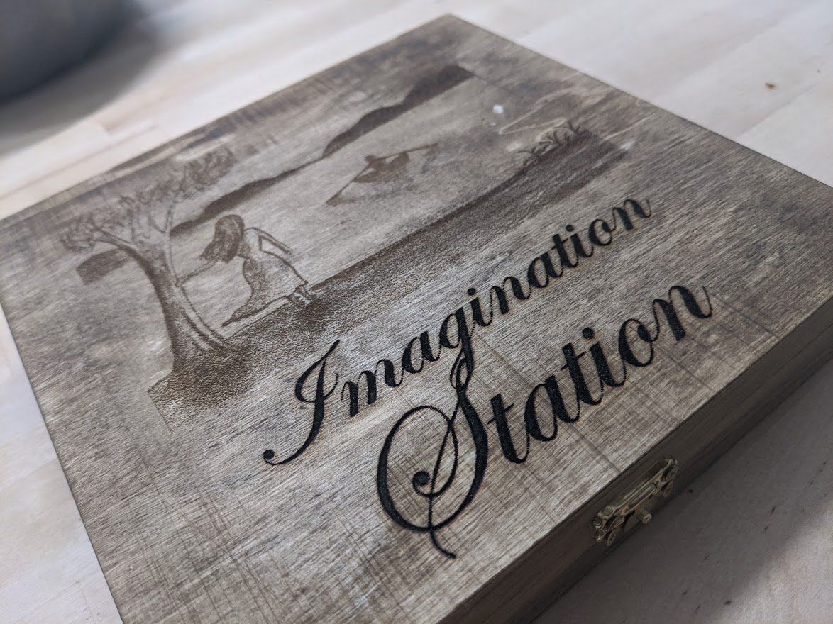

Happily, however, the Snapmaker isn't just a 3D printer. It's also a laser engraver and a CNC mill. The laser module allows you to burn designs onto various materials like wood, leather, or plastic and can create incredibly detailed designs on the right material. I made this "imagination station" for my wife, where I laser cut one of her sketches in the top, adding a title underneath it. It was straightforward with the Luban software, by importing the image, tweaking brightness, and hitting go. The Snapmaker deals with everything else you need. Just make sure to open the window to allow the burning smell to dissipate.
