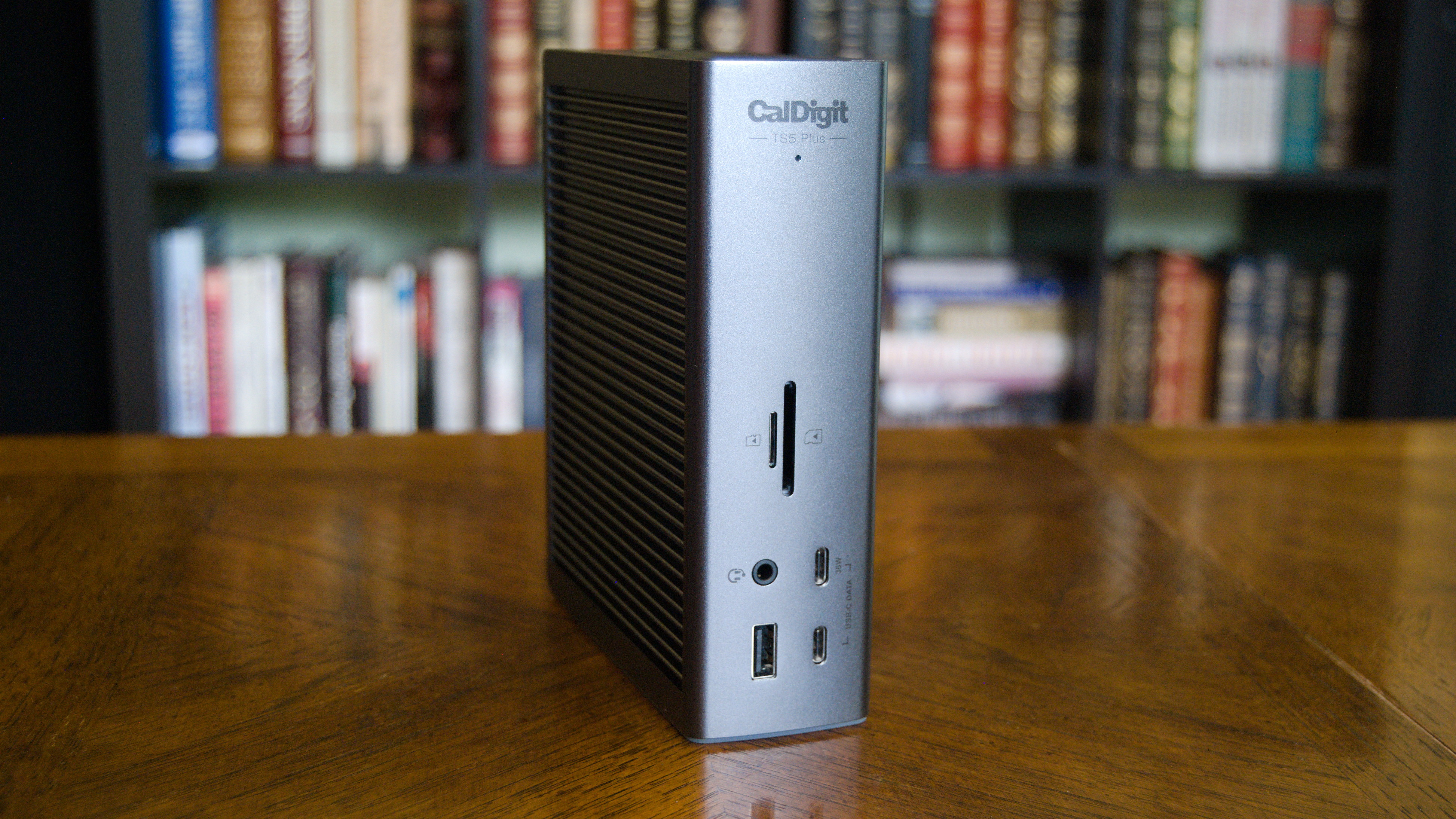

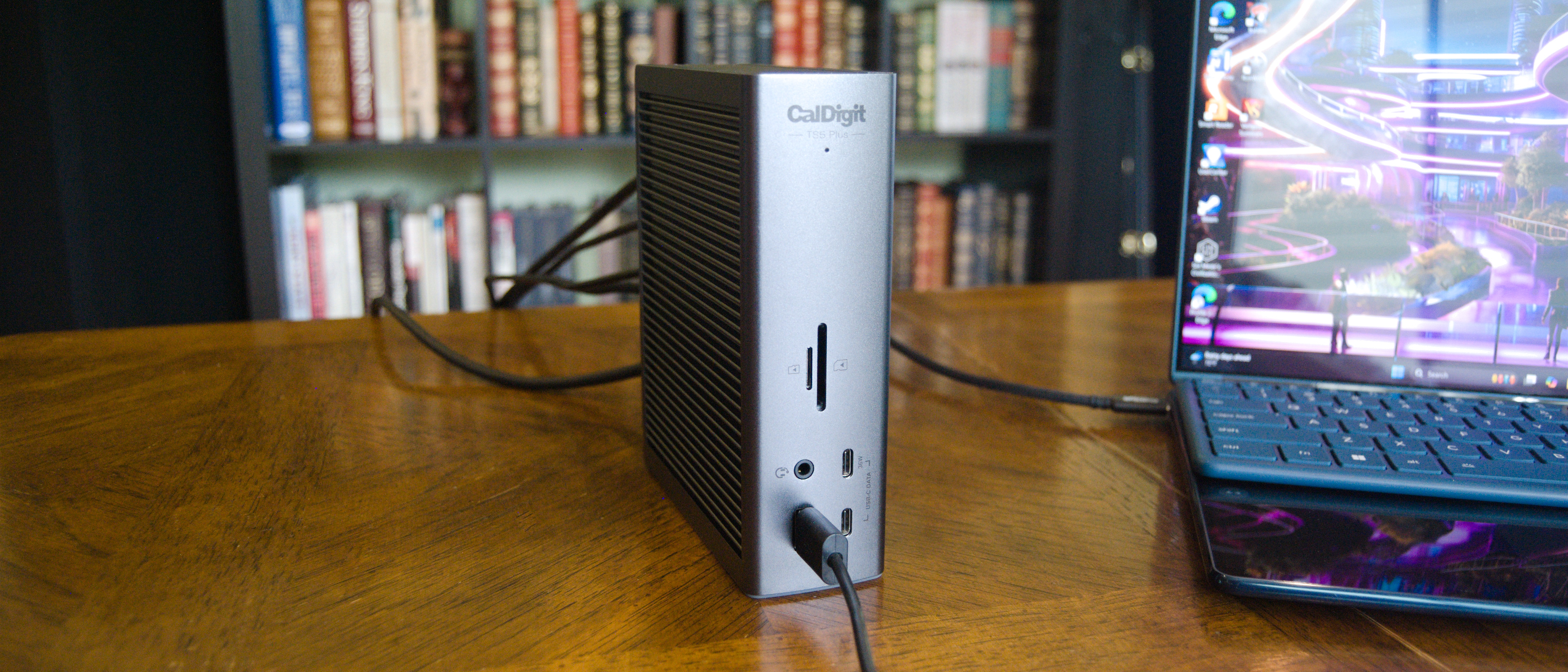

The CalDigit TS5 Plus in action, standing vertically on a wooden table and connected to a laptop, with more cables connected on the back. (Image credit: © Future)

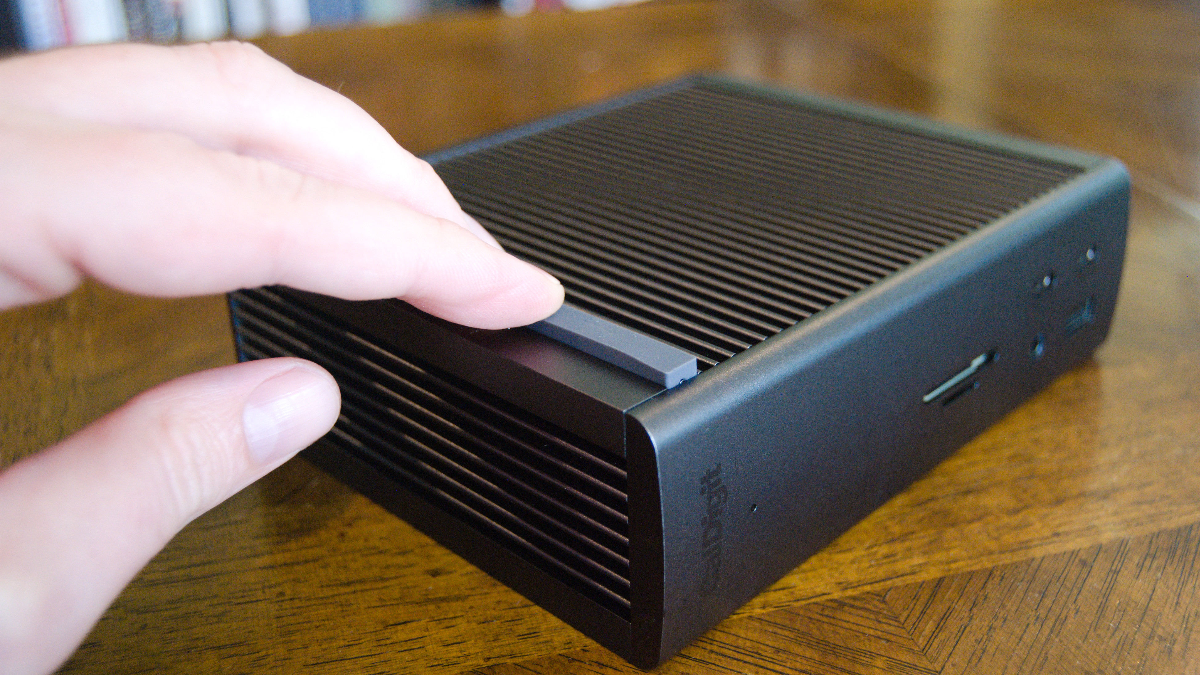

The CalDigit TS5 Plus sitting on a wooden table, with a view at the dock's ribbed panels and the attachable feet for horizontal mode. (Image credit: Future)
CalDigit has firmly established its design language over the years, and if you're familiar with its Thunderbolt Station hardware, the new TS5 Plus doesn't have many surprises from an aesthetic angle.
The dock is built from a solid chunk of aluminum that weighs about 1.98 pounds (0.9kg). A lot of the weight is shaved off thanks to the ribbed panel design on the top and side panels.

Not only does this give the dock a unique look, but it also helps dissipate heat that accumulates when you're putting the dock to task with multiple connections and data transfers.
A built-in rubber strip on the "bottom" of the dock keeps it in place on your desk, but that doesn't mean the dock has to be used vertically.
I typically prefer using a dock sitting horizontally, and CalDigit accommodates users like me by including a couple of rubber strips that can be added to the ribbed panels. Vertical or horizontal, the dock isn't going anywhere and is less prone to scratching.
The TS5 Plus is larger than CalDigit's other docks, including the standard TS5 without the "Plus" designation, but it's not so big that I'm wondering where I'll fit it on my desk.

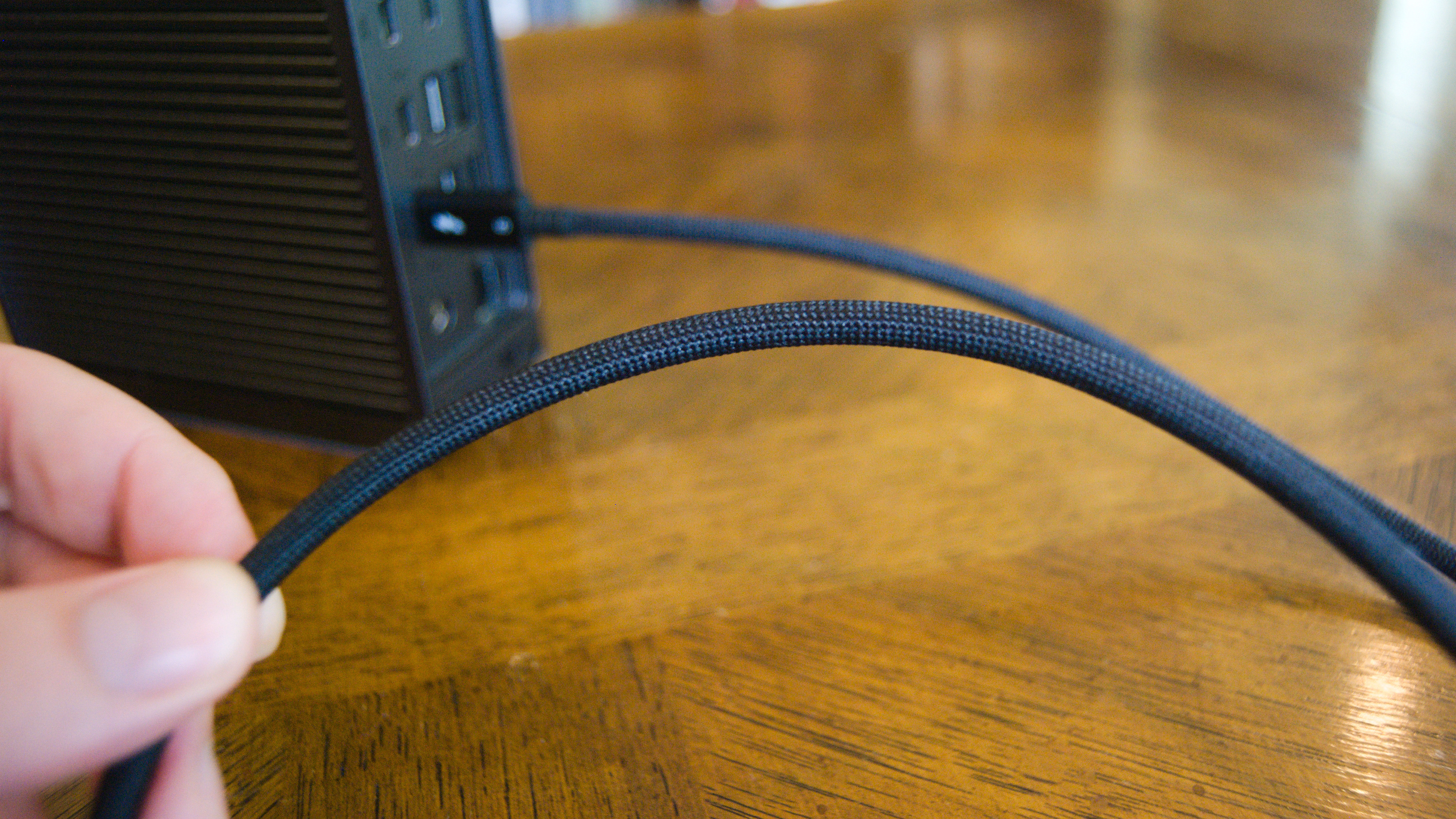

A look at the braided Thunderbolt 5 host cable that comes included with the TS5 Plus. (Image credit: Future)
The included one-meter Thunderbolt 5 cable with 240W charging for your laptop's host connection now comes in a braided variety, a nice upgrade that's bound to last longer than a standard plastic hookup.

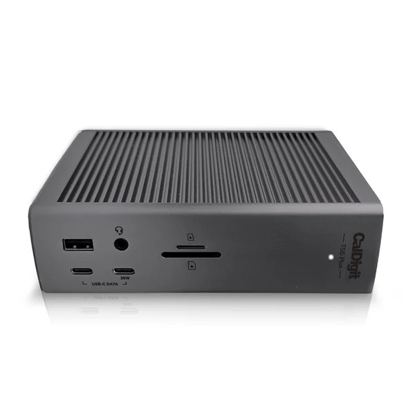

The TS5 Plus standing vertically on a wooden table with front ports, including SD/microSD card readers, 3.5mm audio, dual USB-C, and USB-A in view. (Image credit: Future)
The main attraction of the CalDigit TS5 Plus, especially for power users, professionals, and creators, is the selection of 20 total ports. That's five more than the standard TS5 and two more than the aging TS4.
The front of the TS5 Plus includes dual USB-C 3.2 (Gen 2) ports capable of data transfers up to 10Gbps. One offers 36W of charging, the other 7.5W. There's one USB-A 3.2 (Gen 2) port at 10Gbps with 7.5W charging.
👉 Related: Thunderbolt 5 vs. Thunderbolt 4 vs. Thunderbolt 3 vs. USB4 vs. USB 3
A 3.5mm audio combo jack and dual slots for UHS-II SD/microSD 4.0 cards are also included on the front; they can be used simultaneously.

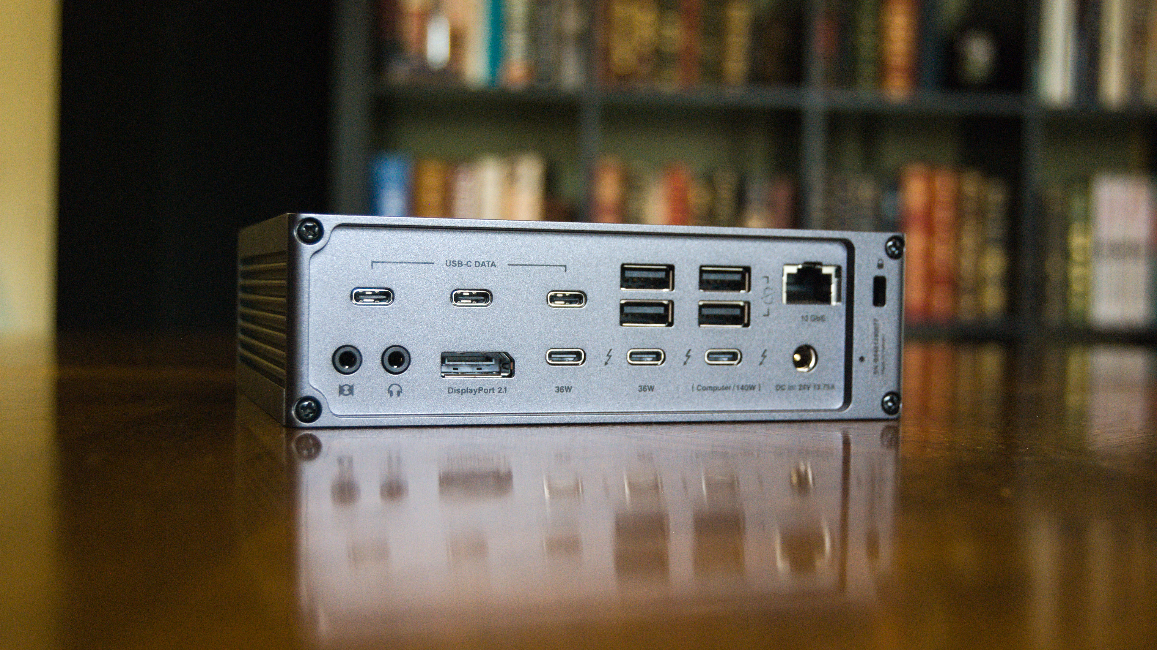

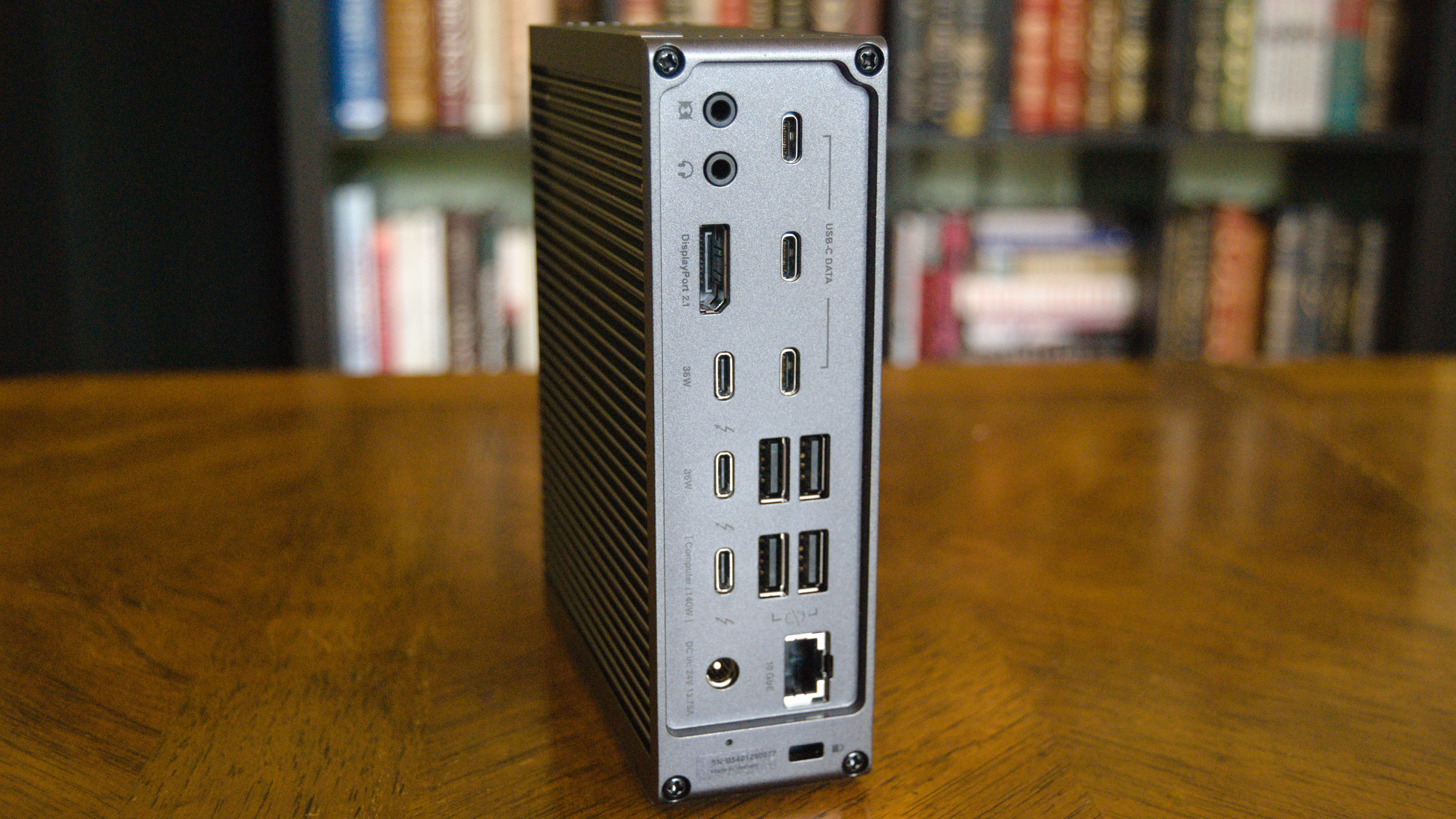

While the front of the dock might appear to waste some space, the back of the dock is completely filled with ports. It's not like CalDigit just decided to make this model bigger because of its name. This also makes it easier to hide connected cables.

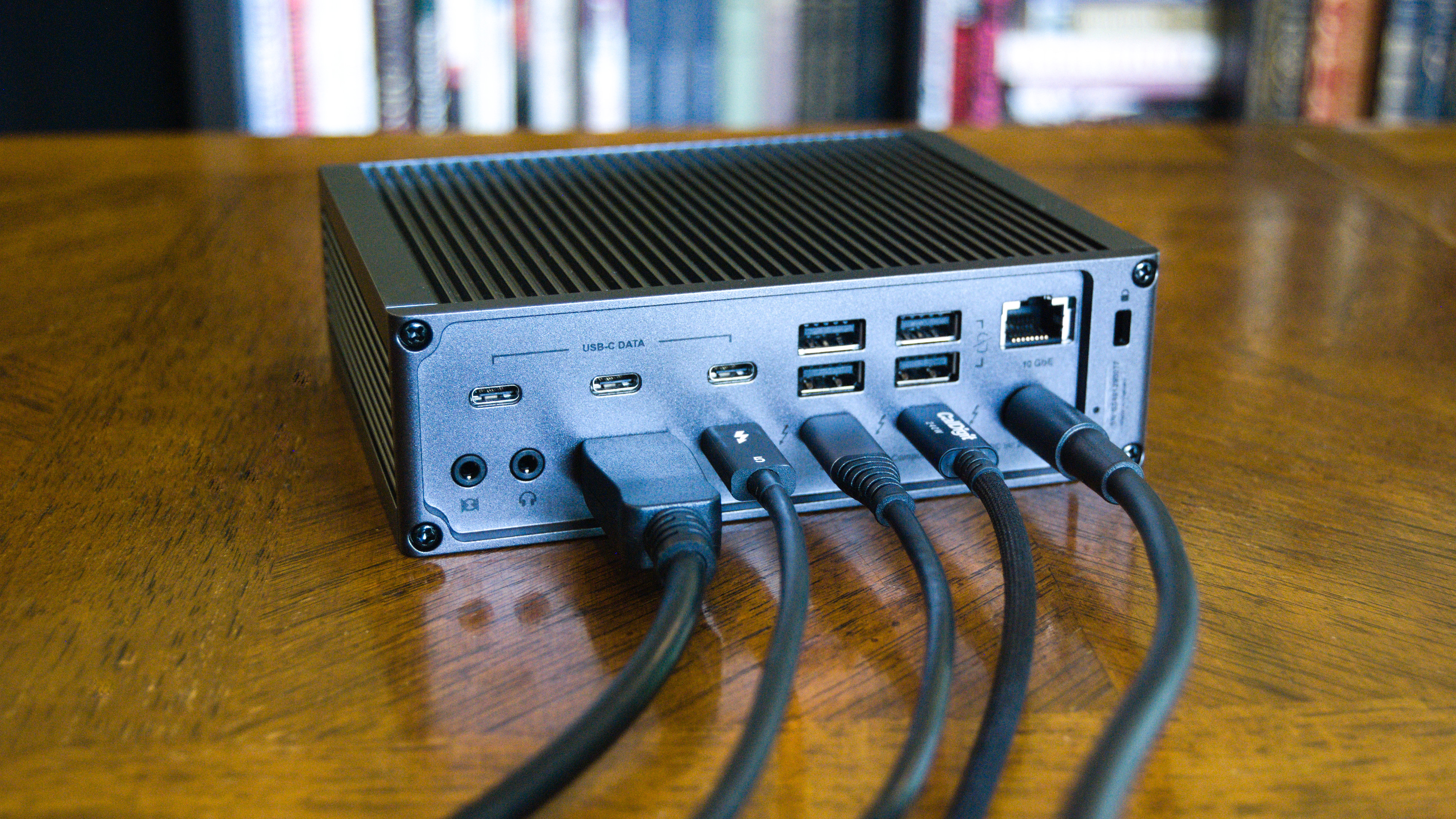

The TS5 Plus sitting horizontally on a wooden table with all of the rear ports, including multiple USB-C, USB-A, Thunderbolt 5, DisplayPort, 3.5mm audio, and 10Gb Ethernet, in view. (Image credit: Future)
Three USB-C 3.2 (Gen 2) and four USB-A 3.2 (Gen 2) ports each at 10Gbps offer up to 7.5W of charging power. Two downstream Thunderbolt 5 ports each offer up to 36W of charging power and the standard 80Gbps bi-directional data flow.
Another first for me in the docking world is CalDigit's inclusion of two separate 10Gbps USB controllers. The first controller handles the front USB-C ports, rear Thunderbolt 5 ports, and the SD card readers.
👉 Related: Do Windows on ARM PCs support Thunderbolt 4 or 5?
The second controller handles all of the USB-A ports and the three rear USB-C ports. This ultimately keeps your bandwidth uncompromised when using multiple ports at once, and I don't know of any other docks offering the same setup.
The Thunderbolt 5 ports can automatically reaccommodate bandwidth to handle 120Gbps in one direction and 40Gbps in the other, which is especially potent for connecting external displays. CalDigit also includes a native DisplayPort 2.1 connection for a third display.

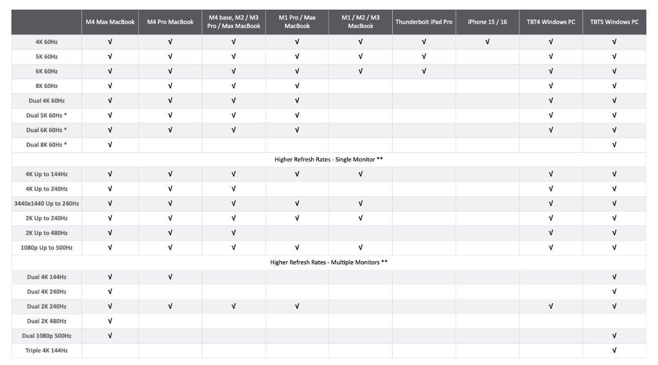

A look at the TS5 Plus external display support chart provided by CalDigit. (Image credit: CalDigit)
While I don't have the display hardware to test the true limits of the TS5, CalDigit's display chart should have the information you need. Using the TS5 with a Thunderbolt 5-equipped Windows PC, the dock will run up to dual 8K@60Hz displays or triple 4K@144Hz displays.
It's worth pointing out that when you get into resolutions beyond 4K, Display Stream Compression technology is required from the external monitors.
To compare, Plugable's new TBT-UDT3 that I've begun testing is said to support up to dual 8K@120Hz displays, so it might be a better option if you actually have that type of hardware on hand. For most users, however, dual 8K@60Hz or triple 4K@144Hz will be more than enough.

Rounding out the rear ports are dual 3.5mm in/out audio jacks, the Thunderbolt 5 host port with up to 140W charging for your connected laptop, barrel charging port, and a 10Gb Ethernet hookup.
That last feature stands out, as it's not something I've seen in any other Thunderbolt 5 docks; the competition typically tops out at 2.5Gb Ethernet. Considering the cheapest Thunderbolt to 10GbE adapter I could find costs about $180, it's an included perk that power users will want to note.
The TS5 Plus standing vertically on a wooden table with the rear ports, including multiple USB-C, USB-A, Thunderbolt 5, DisplayPort, 3.5mm audio, and 10Gb Ethernet, in view. (Image credit: Future)
