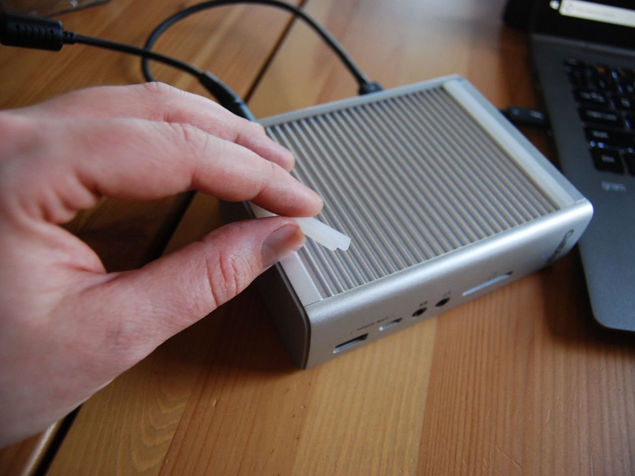

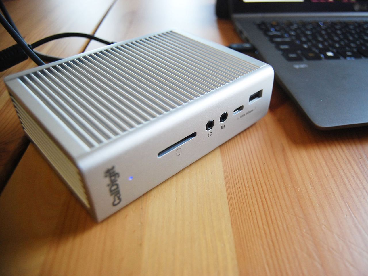

Most popular Thunderbolt 3 docks have a narrow rectangular shape that admittedly looks good, though they take up more room on your desk and can't stand vertically. Not here. It's kind of shocking how compact the TS3 Plus is when you pull it out of the box, with a boxy design that lets you stand it up. It has enough weight and an anti-slip pad on the bottom to keep it from shifting around too much, and there are optional rubber feet you can press on if you'd like it to sit horizontally. The corrugated surface hides dirt and smudges, and its aluminum construction feels durable. If something goes wrong, you can take advantage of lifetime support or the one-year warranty (which can be doubled if you buy from CalDigit).

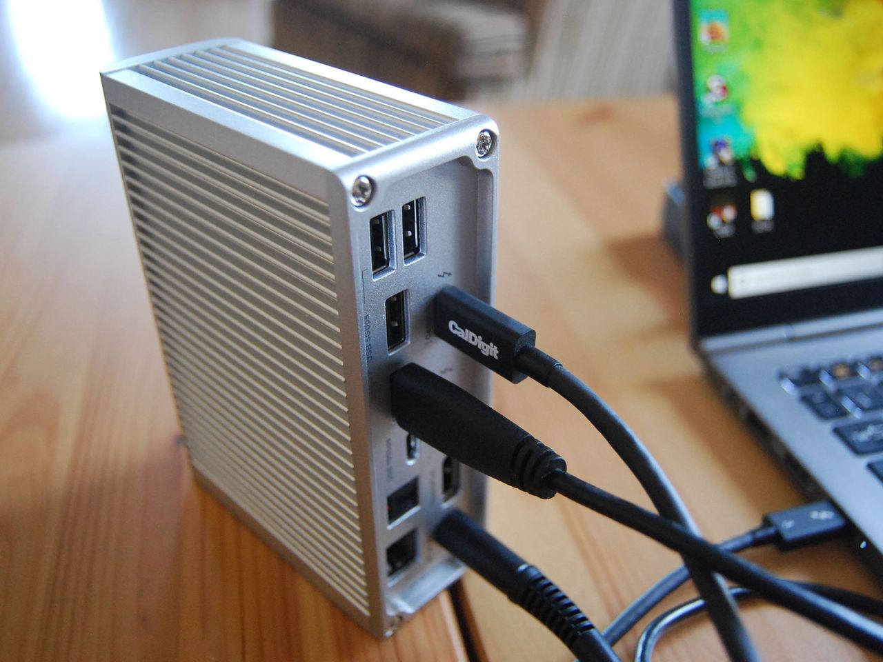

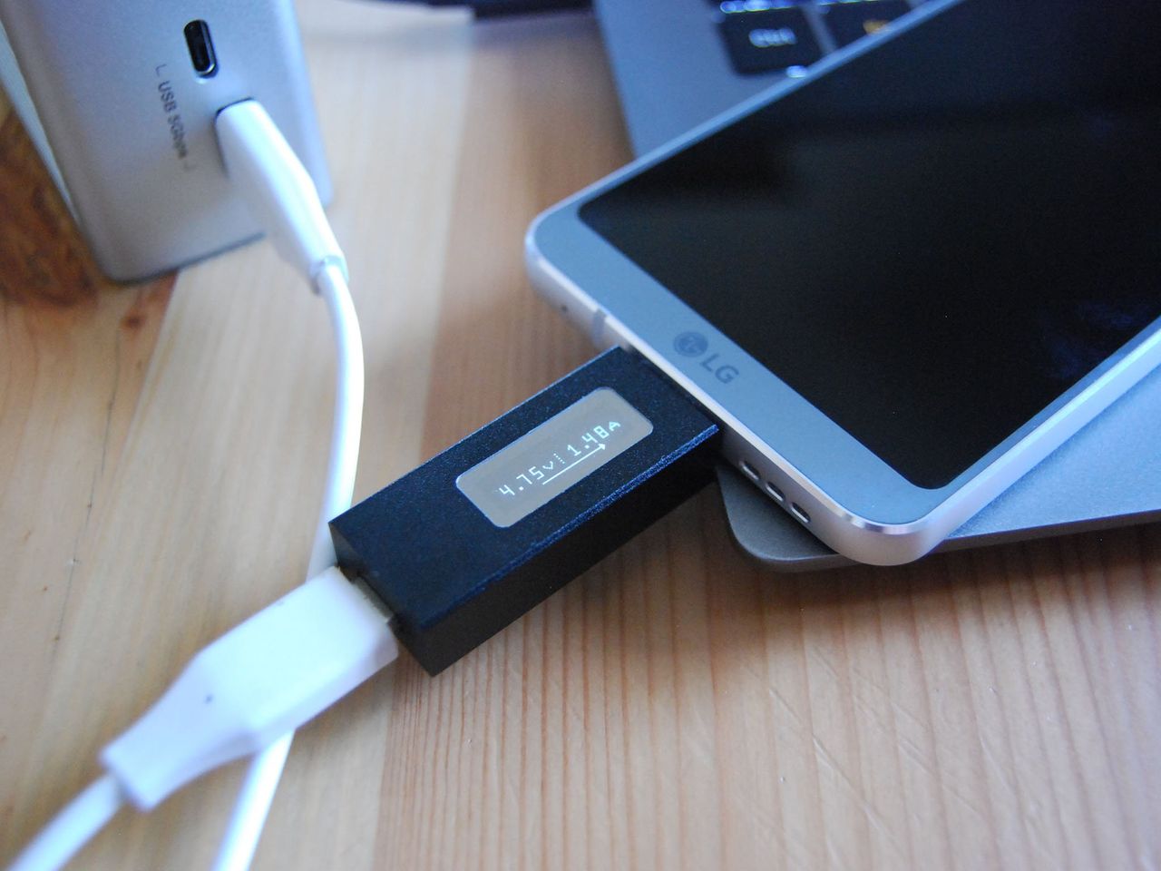

You plug the Thunderbolt 3 cable into your PC, plug the power cable into the dock, and you're ready to go. This dock is bursting with ports, and over the course of my testing I didn't run into a scenario where I was unplugging something just to make room for another device. Five USB-A 3.1 ports offer data transfer and charging, though they don't seem to be all the same when I tested with my Plugable USB-C voltage and amperage meter. The front port and the top four rear ports delivered 5V and 1.5A (7.5W) of charging, while the bottom rear port didn't seem to go over 5V and 0.5A (2.5W). The front and back USB-C ports likewise charged at 7.5W.
