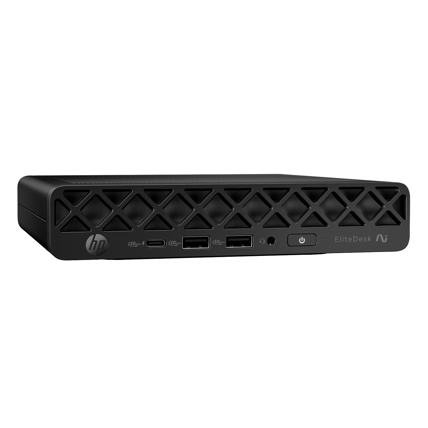

A look at the front panel on the HP EliteDesk 8 Mini (G1a), with dual USB-A, USB-C, and 3.5mm audio. (Image credit: Future)

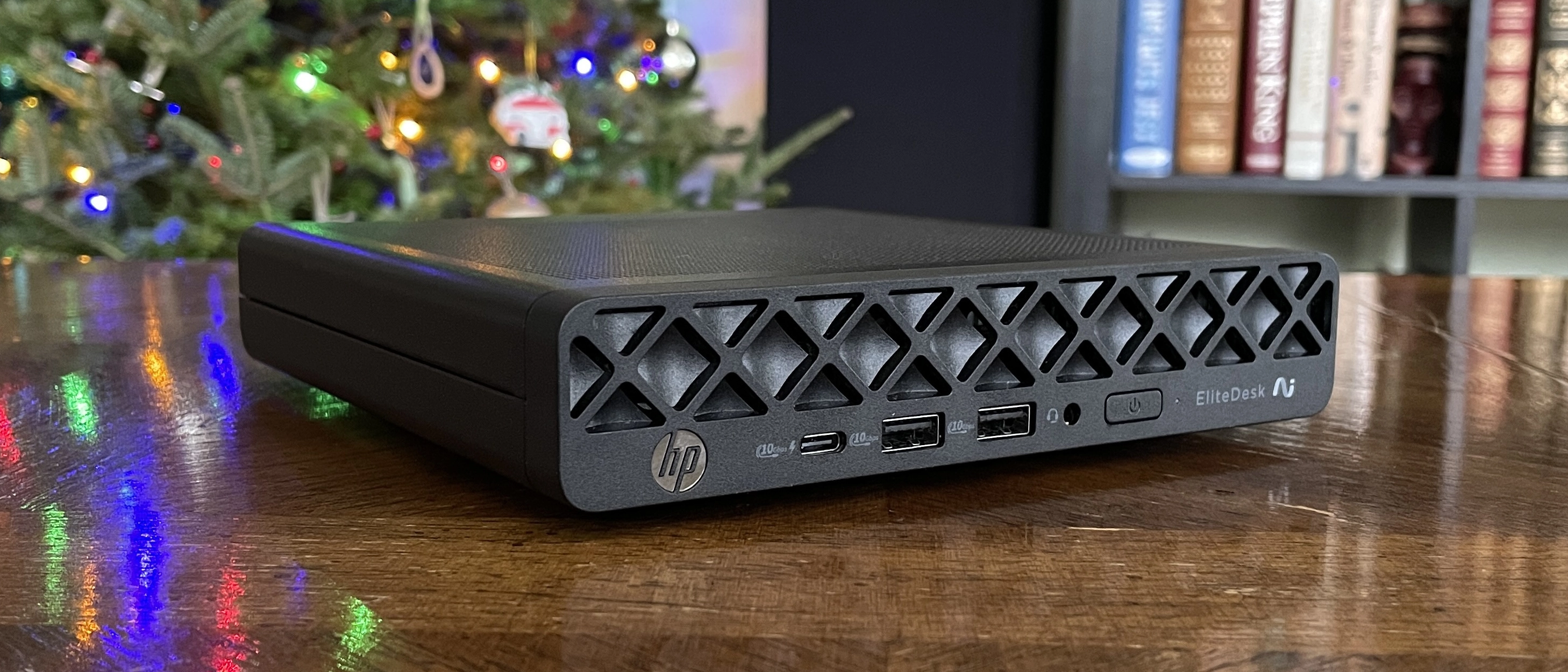

It measures just 1.35 inches (3.43cm) thin and is roughly 7 inches (~18cm) in width and depth. Weighing in at 3.13 pounds, it's no heavier than many laptops, and you shouldn't really notice it if you slip it into a bag to take with you. The chassis is a mix of plastic and aluminum, but it's as sturdy as can be.
The top panel is perforated to help feed the cooling fans with enough air, while the bottom panel has non-slip feet and pre-drilled holes for VESA mounting. I've been using the PC horizontally, but you can always add a vertical stand for an extra $2 at checkout.

The PC's front I/O — embedded in a stylized plastic faceplate —includes one USB-C 3.2 (Gen 2), dual USB-A 3.2 (Gen 2), and a 3.5mm audio combo jack for headsets. Here you'll also find a standard power button.

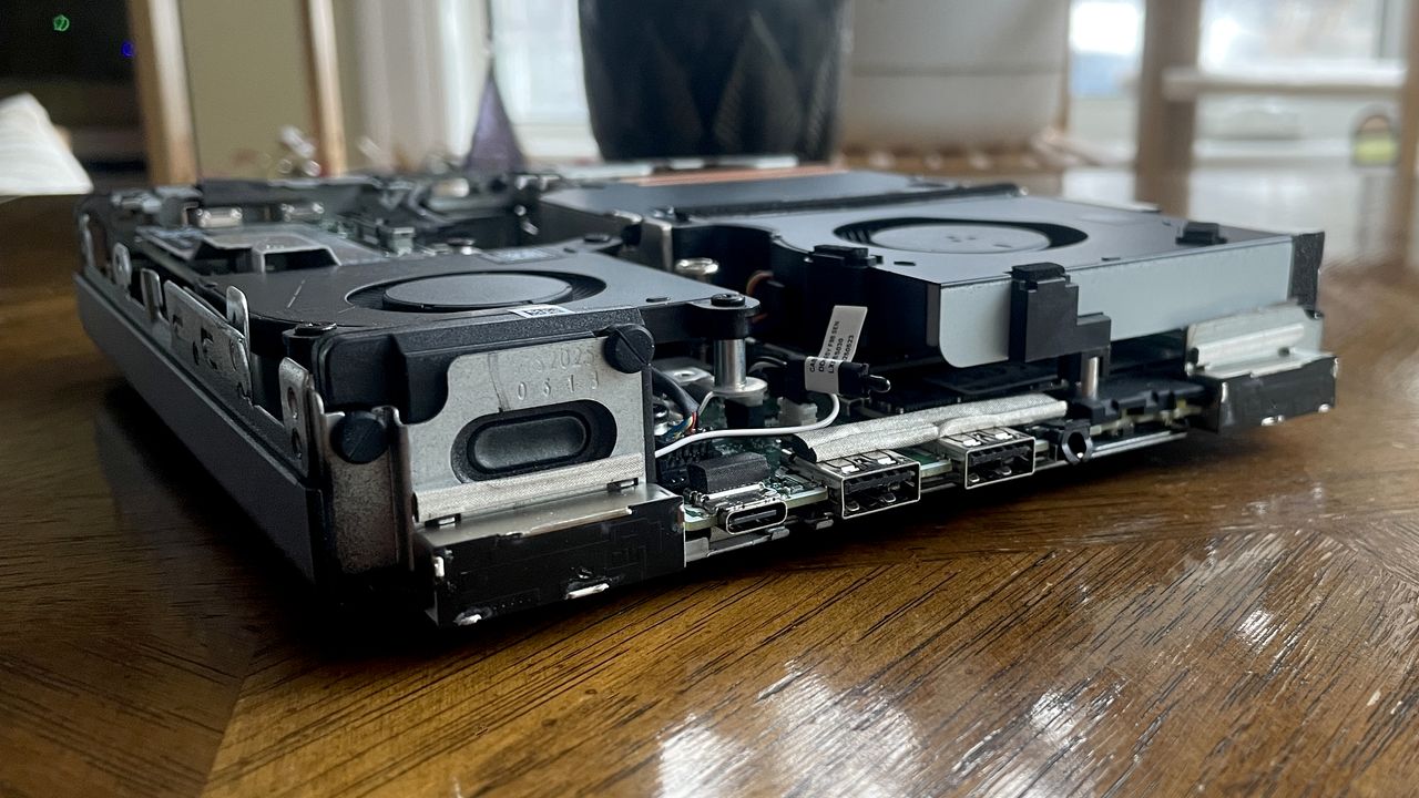

The internal hardware is packed in tightly, but HP made some smart decisions here to alleviate the upgrade process.

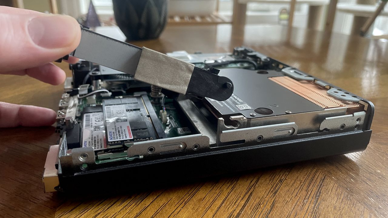

The top panel of the PC is easily removable with just a thumb screw holding it in place. The internal hardware is packed in tightly, but HP made some smart decisions here to alleviate the upgrade process.

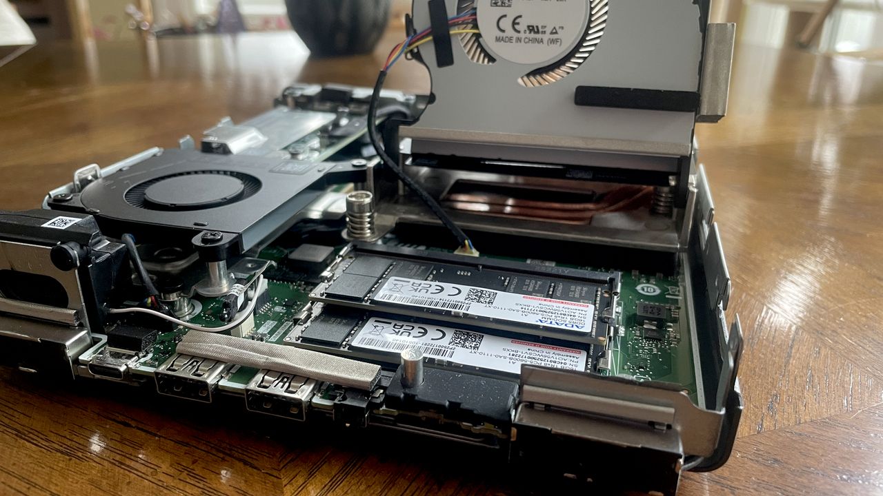

The main system fan is seated on channels that allow it to be lifted up and away from the rest of the PC. This reveals the dual SODIMM RAM slots for upgrades. The "loose" fan has dampeners on the sides to prevent rattling, and indeed, there was none during my time with the PC.
Unfortunately, the SSD isn't as easy to swap; it's located below the second fan that is screwed into place. Certainly not a dealbreaker. HP is focusing a lot on repairability for this mini PC, and just about every part that goes into it can be ordered from HP's PartSurfer market. That's a bigger deal now than ever as PC prices continue to rise due to a global RAM and storage shortage.
