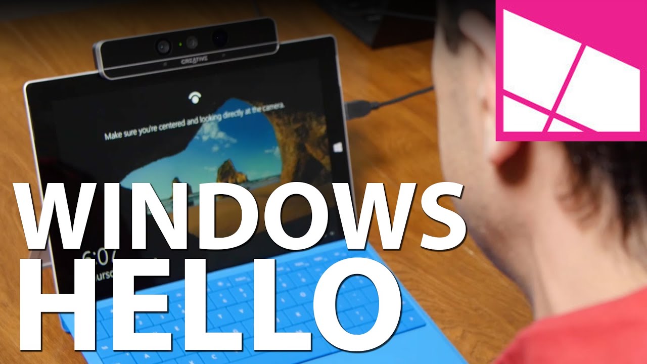

Facial recognition right now is being accomplished with the Intel RealSense F200 reference camera reference design. Some laptops are already using it (see here), and more will be in the coming year. That is the camera we have demonstrated on video as a development device that you can order from Intel.
The F200 is not tiny (Note: the F200 is front-facing; R200 is world-facing). For instance, it has three cameras, not just one. Those cameras are:
  1. Infrared
  2. 3D
  3. Traditional RGB (aka webcam)
Moreover, the F200 is more than just facial analysis as it can also be used for hand/finger tracking, speech recognition, augmented reality, and background segmentation.
YouTube YouTube
Watch On
The F200 is more like a full-blown Kinect camera. It also happens to be Windows Hello ready so that you can use your face to unlock your computer. It is chunky too, which is why it is harder to jam into a small bezel display.
