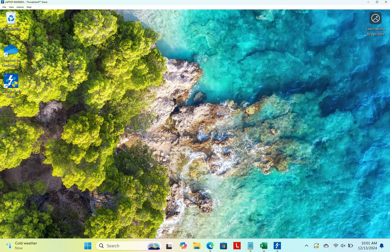

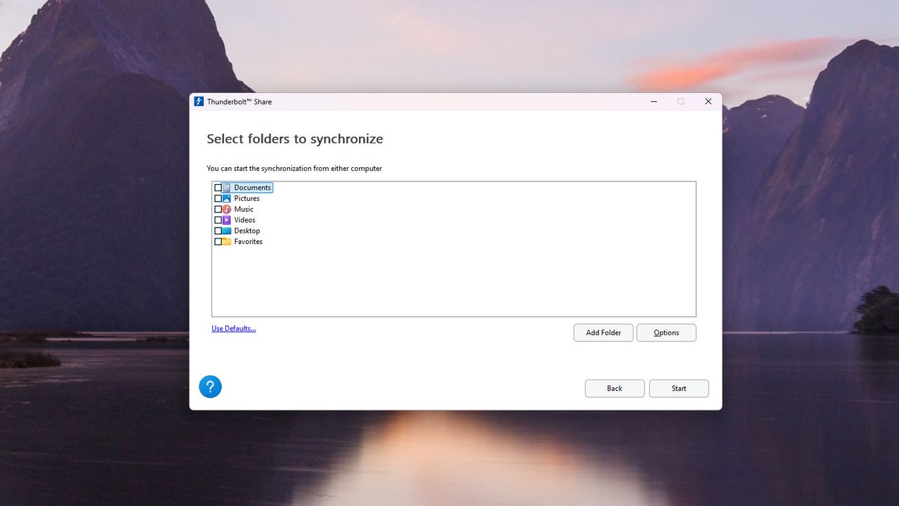

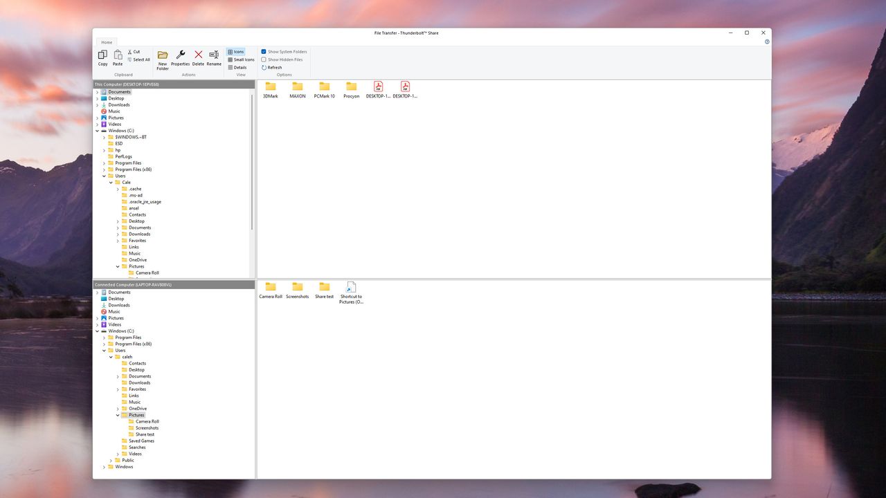

Thunderbolt Share has four main tools. Control Other Computer lets you take full control of the other connected PC, with the desktop showing up in a window on the main laptop. Drag & Drop Files opens a window displaying the File Explorer on both PCs for quick and organized transfers. The Sync Files tool allows you to choose specific folders to sync, keeping their contents the same across PCs. Transfer Data to New Computer is super useful when it comes time to retire an old PC without losing any of your data.
As I wrote in the companion piece, the almost complete lack of any latency and the speedy transfers between PCs are impressive, and I'm going to put it to use whenever I can. I foresee it being most useful when testing laptops, but for others, it will be a boon for multitasking and collaboration.
