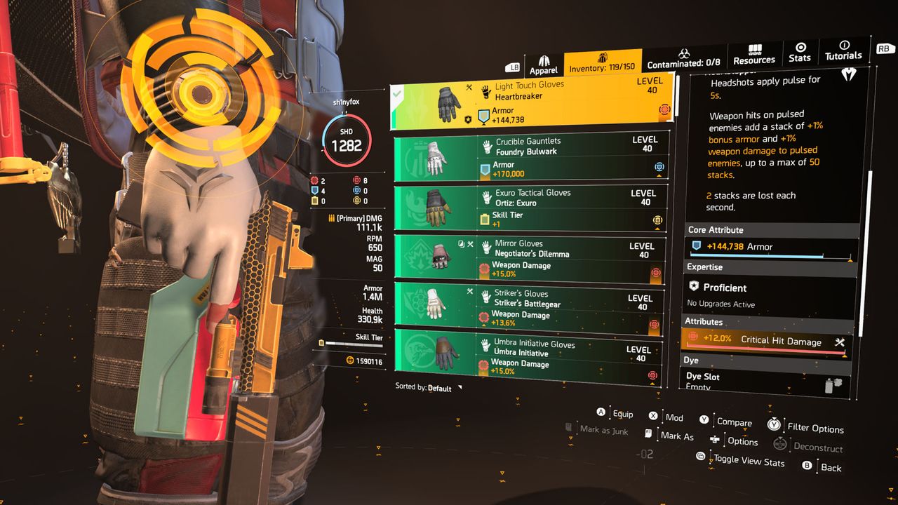

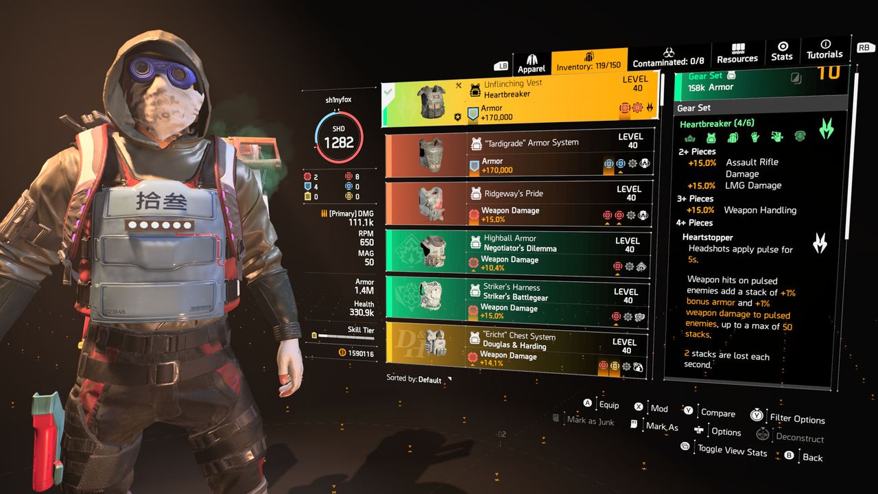

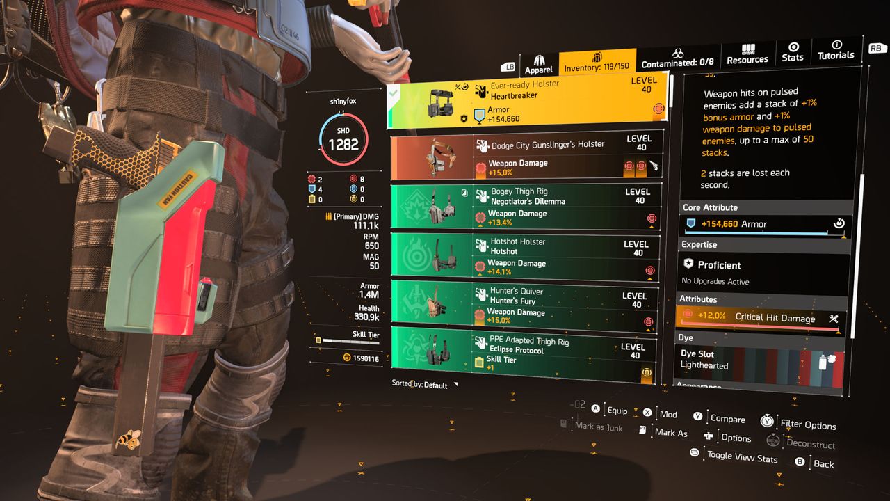

Gear: Four pieces of Heartbreaker, Coyote's Mask, Ceska knee pads

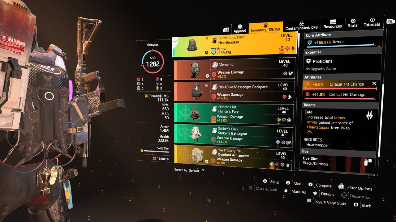

One of the key parts of this build is the Heartbreaker gear set. You want to run four pieces, in particular the chest piece and the backpack, to take advantage of the talents on each. Both talents only apply when you have four pieces of Heartbreaker applied, and they're both really useful.
Heartstopper is the brand set bonus, applying pulse for five seconds to enemies hit with headshots. Furthering that, weapon hits on pulsed enemies add a stack of 1% bonus armor and 1% weapon damage, up to a maximum of 50 stacks. Two stacks are lost every second, which is why you need to be pretty aggressive to keep them up.
By running the backpack and the chest piece, these numbers go up even more. The number of stacks doubles to 100, thanks to the chest, and the bonus armor is doubled to 2% per stack, thanks to the backpack.
This reliance on pulsing enemies is why you need to run Technician and have the Linked Laser Pointer attached to your weapons. It applies pulse without the need to hit headshots, so you'll keep ramping up those stacks much easier.
For gear mods, I'd recommend using critical hit chance and critical hit damage over more defensive choices. You should be good for armor with the Heartbreaker set and the bonus armor you'll generate, so bump your damage as much as you can.
To get Heartbreaker gear pieces, either farm missions where the brand is the targeted loot or hit up Countdown and set it as your preference.
