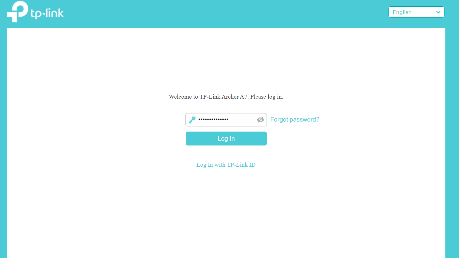

- Visit your router's settings page via typing 192.168.0.1 or http://www.routerlogin.net into a web browser.
- Sign in with your username and password. If you don't know these, look up the default ones in a manual or online.

- Head to a browser and open your old router's settings.
- Within its settings, look for internet, bridge, or repeater settings.
- For TP-Link routers, the option you need is under Operation Mode. Click Operation Mode.
