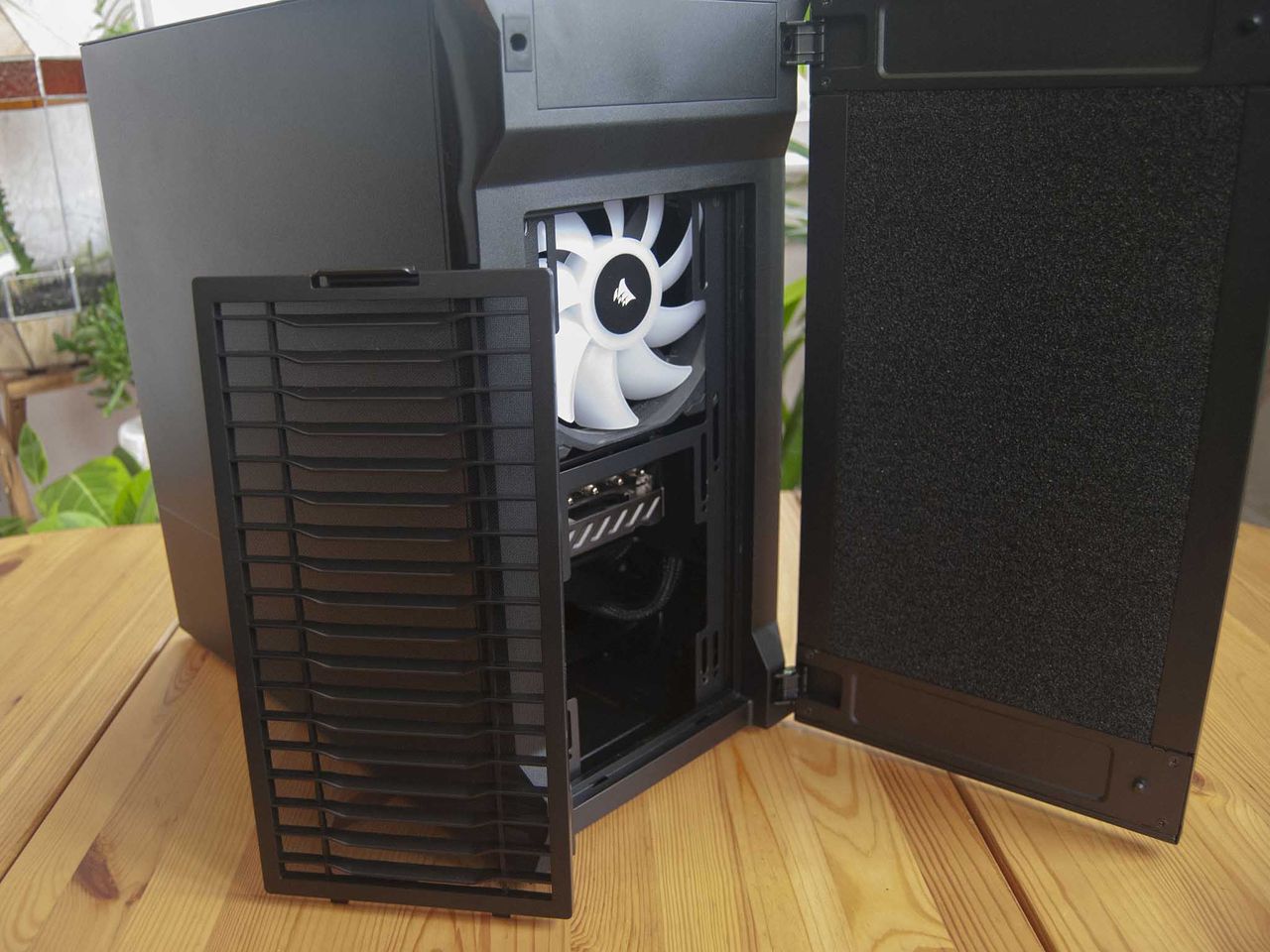

Building a PC inside the Silencio S400 was painless even though I went beyond suggested dimensions. My AMD RX 6800 GPU is about 330mm long, which is 11mm over the limit of the case. This caused issues with the stock 120mm fan; the mounts for the smaller size didn't go high enough to clear the GPU, but luckily I had a few 140mm fans lying around in wait.
The Silencio S400 makes PC building about as painless as possible, even when going over recommended dimensions.
Taking Cooler Master's "Make It Yours" slogan to heart, I removed the entire front section of the case, including the hinged sound-dampening door and dust filter. This plastic portion is held in by pressure clips so it was quite easy to get off. From there, I replaced the 120mm fan with the 140mm option (which could sit way higher in the case) and plugged it into the four-pin extender that can run up to three fans. This was also when I removed the optical drive cage. Those of you with oversized GPUs should also be able to get the case to work, but do note that going over the dimensions will remove the ability for a front radiator. You're pretty much cemented into a single 140mm fan up front.

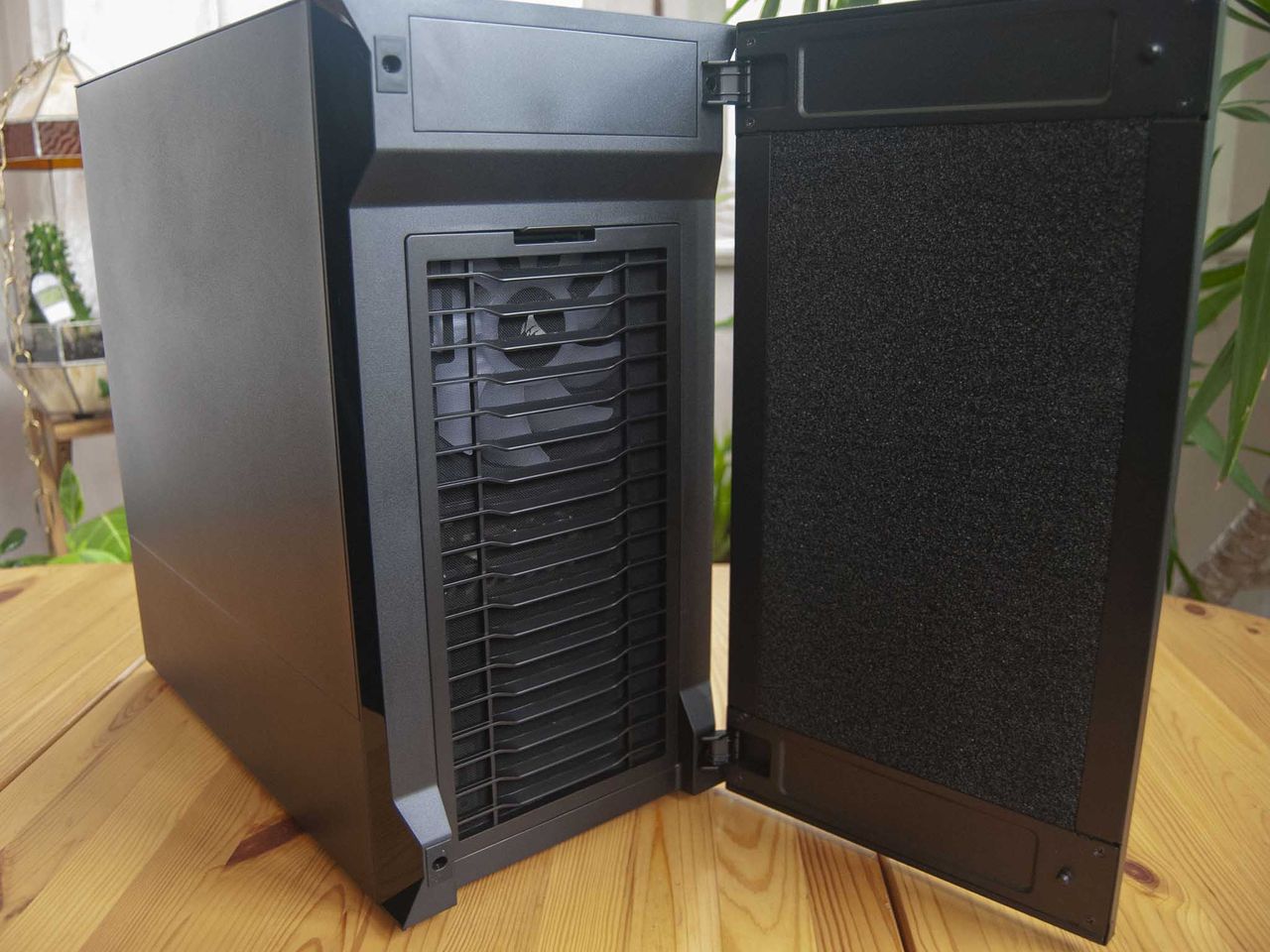

This case is all about keeping your hardware silent. To achieve that, the metal side panels have sound-dampening material on the inside. The front panel, which is hinged to provide access to the dust filter and optional optical drive, is also equipped with the same heavy material. I love the hinged design, as you can open up the PC to get a bit more air through if your PC is suffering with a particular task.

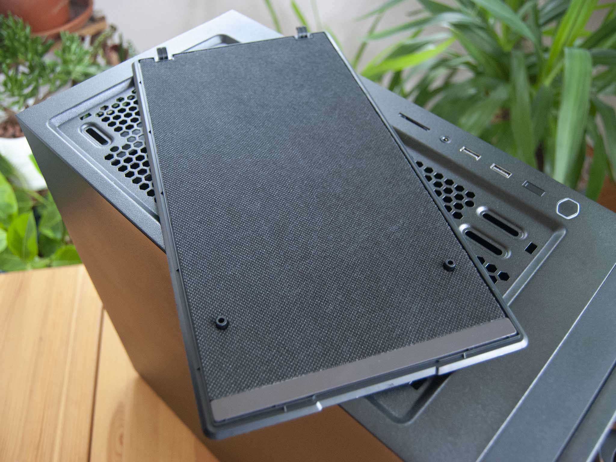

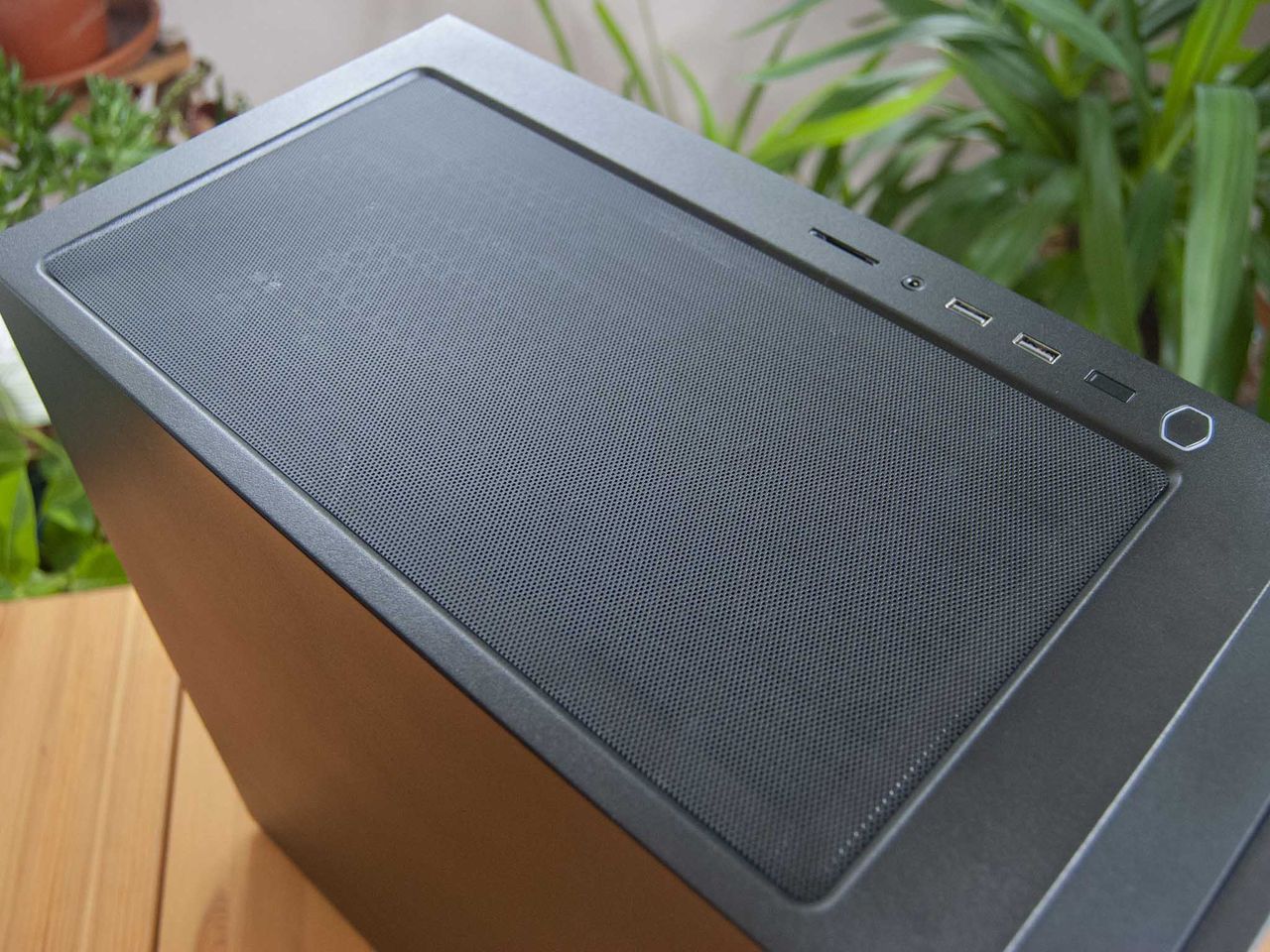

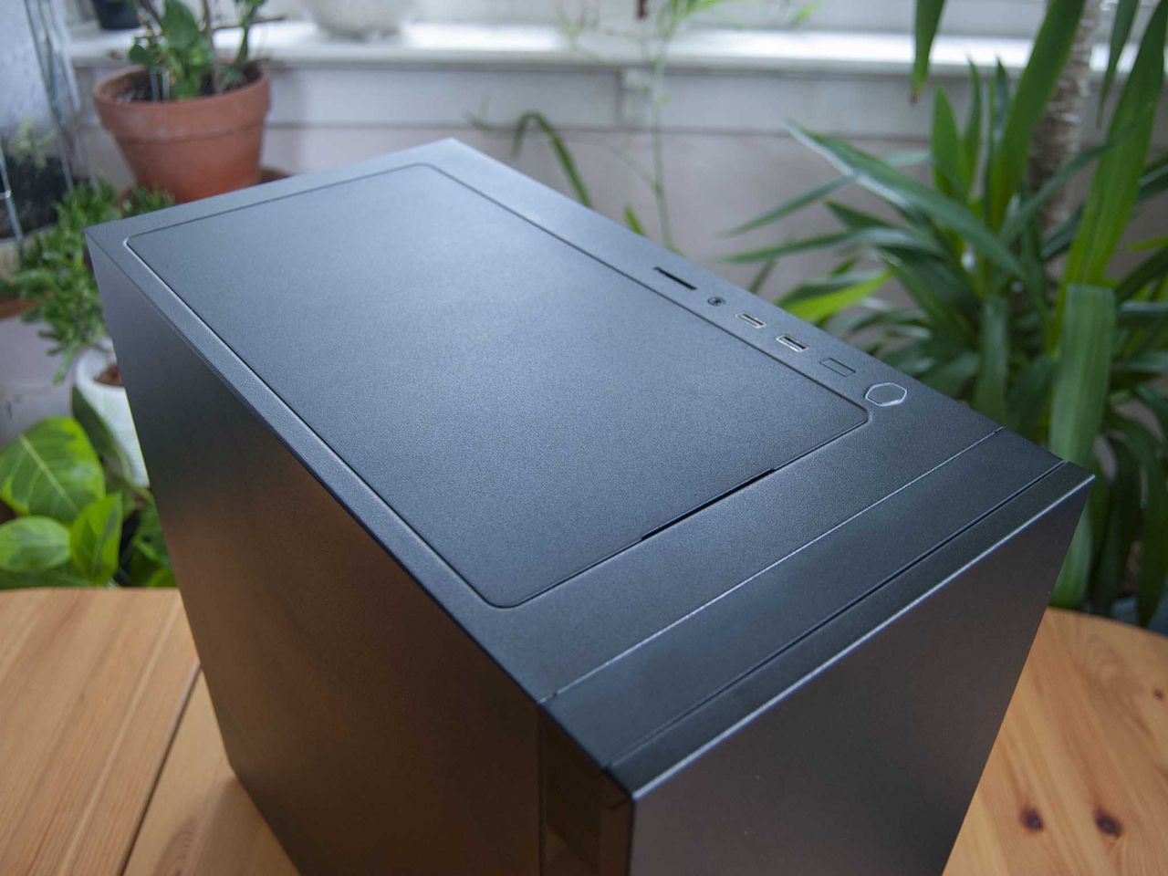

The top venting can either be covered with a magnetic dust filter for better airflow, or with a steel panel with sound dampening for less noise. Since I didn't mount any top fans, I primarily used the steel panel since it gives the case just a bit more of a complete look. And, as we will see, it didn't cause too much of a rise in temperatures. The back of the case is essentially left open as most cases are, but with it pointed away from you there isn't a whole lot of racket to be heard.
I tested noise and heat generated by the PC, both with the mesh top and the solid top, as well as while idling and while under load. The test system includes an AMD Ryzen 5 5600X CPU, AMD Radeon RX 6800 GPU, M.2 PCIe 3.0 SSD, and a Gigabyte AORUS Pro X570 motherboard. Keep in mind that I replaced the 120mm front fan with a 140mm fan to better fit the oversized GPU. I left the top open, though there is plenty of room for a couple of fans or a radiator.
Testing first at an idle, I measured 51.2 decibels directly above the PC with the mesh top installed. With the solid top, I measured 40.9 decibels, a significant drop. At this level it's safe to think of a quiet library, and that's if you have your ear basically pressed up to the PC. Testing noise at the front from about 2 feet away, sound actually went up by a couple of decibels when I replaced the solid top with mesh, from 36.1 to 38.2. This could have to do with the PC hauling more air through the front when the top grate is closed. Still, it's not a ton of noise.
Under load, I measured 54.5 decibels directly above the PC with the mesh top installed. With the solid top, I measured 43.1 decibels. From about 2 feet away it's significantly quieter even when the system is being stress tested. You can still definitely hear the system running, especially with the oversized GPU I installed, but this is still one of the quietest PCs I've built.

The case's foam feet (to cut down on vibrations) don't seem like they'll last long, especially if you're often moving the case around. And the top dust filter's magnets don't line up in the corner. It's all small, ultimately inconsequential stuff that I'm nitpicking here, and it's nothing out of the ordinary for a case this price. As for the front I/O, I appreciate the SD card reader but wish there was a USB-C port for better future-proofing.
