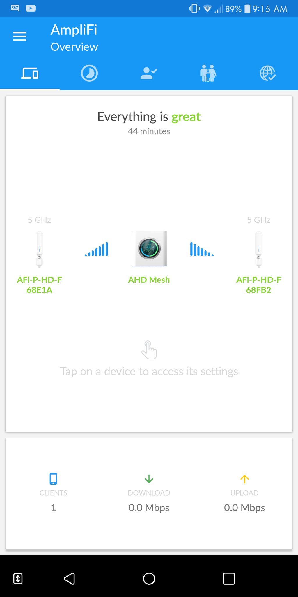

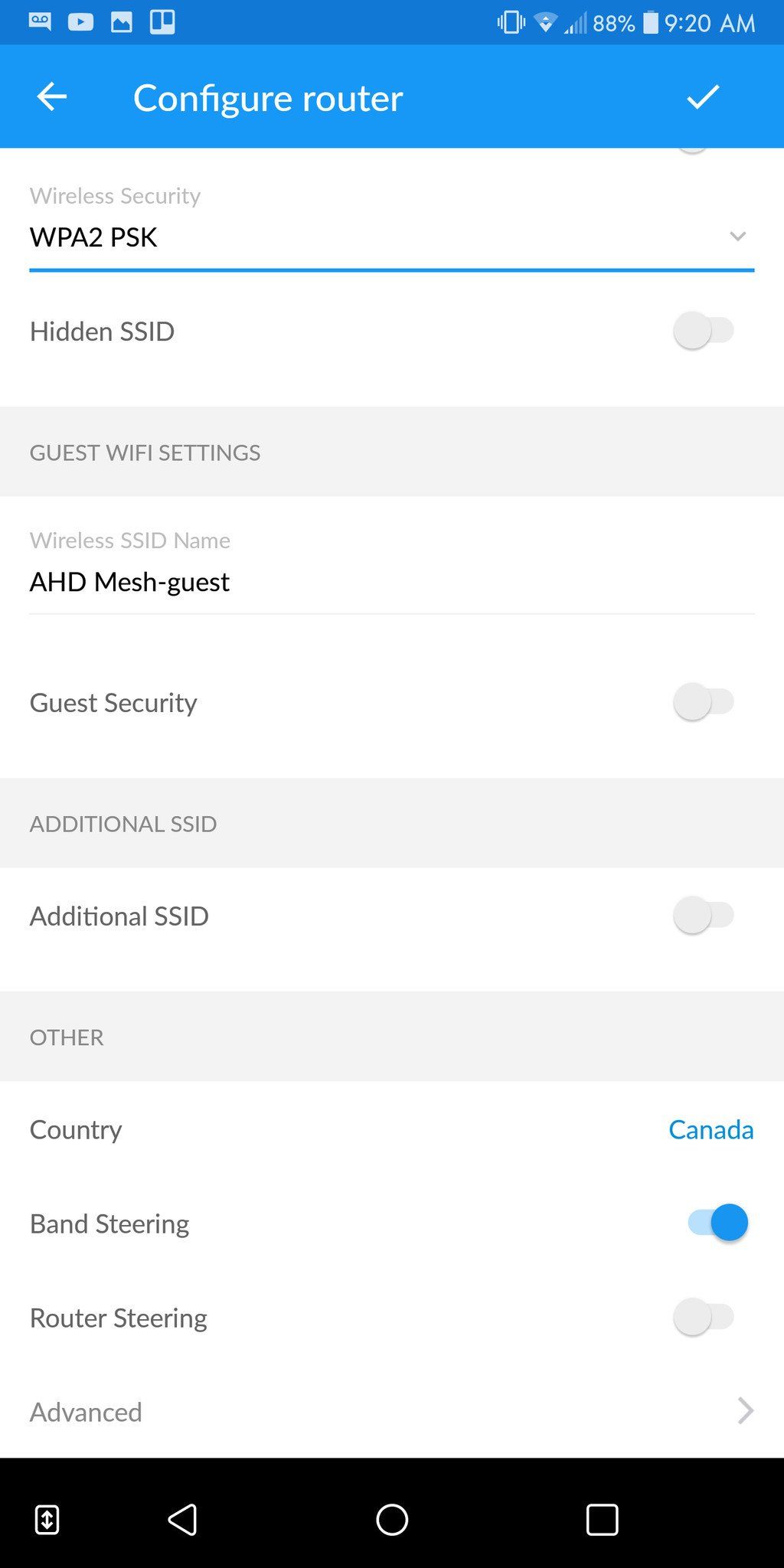

The Android app I used here is laid out well and is thus easy to navigate. At the top are five tabs. Overview gives a quick look at signal strength between MeshPoints and main router as well as how many clients are connected to the network. From here you can tap a node or router to bring up a sub-menu that has further settings, like the ability to set up a separate SSID on a specific radio, security protocol, guest network, and toggling band steering and router steering. Steering tells the MeshPoints to connect back to the router if at all possible even if the signal is weaker). You can also tweak DNS and toggle IPv6, as well as toggle Bridge Mode.
The Performance tab contains a live graph of throughput and usage, and you can perform a quick ISP test to see what speeds are coming through the wall. The Guest tab lets you set up an additional guest network with a specific number of guests allowed, and the Family tab has a toggle for pausing internet on all devices as well as a list of devices currently connected to the network. Tapping a device brings up a sub-menu where you can set priority from standard to either gaming or streaming. As far as quality of service (QoS) goes, that's about it.
Finally, the Diagnose tab will let you know if something's wrong, and you can attempt to fix the problem(s) with the tap of a button. In my testing, I still haven't come across any issues. The router does a built-in firewall, but it's about as basic as can be. There is also no built-in VPN support.
