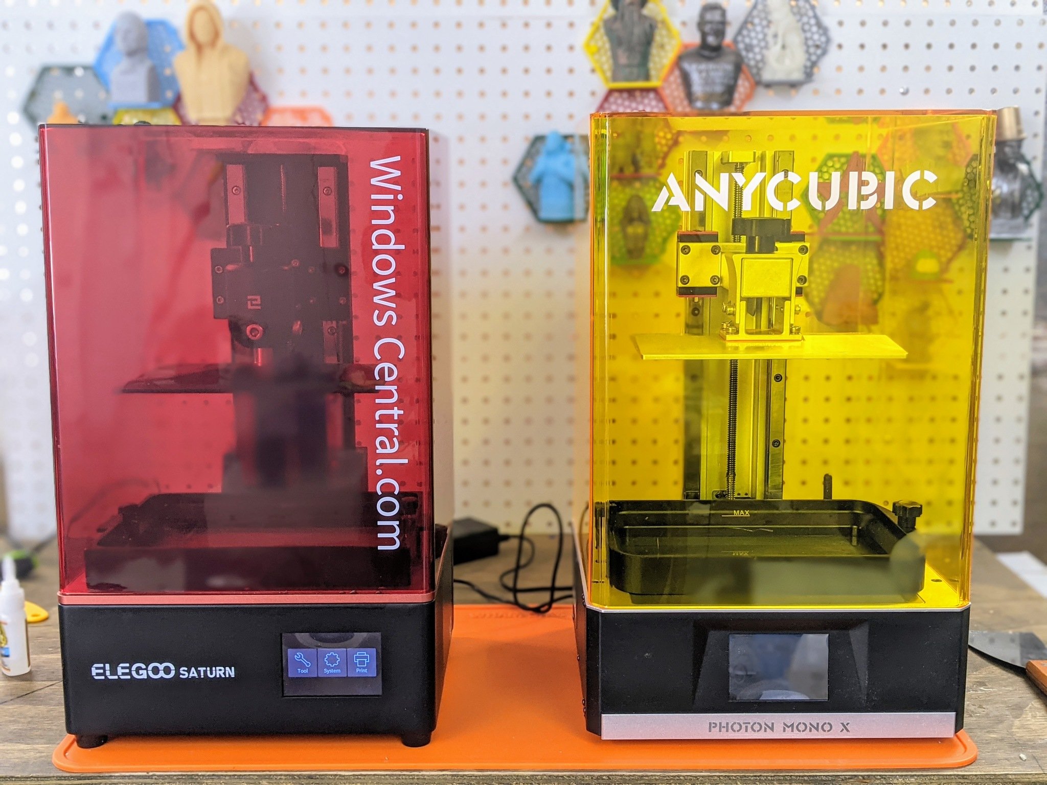

I'm not normally one to go directly for looks — after all, it's the personality that counts — but the Anycubic Mono X's design is different enough from the competition to stand out nicely. The black case with silver accents looks really clean, and the etched title bar at the bottom of the machine is a nice touch. Even the bright yellow acrylic lid is cut with angled corners that give it an industrial feel. Anycubic is also using this design language in the Wash and Cure Plus, and I like the direction it's heading.

It's good that the Mono X looks so sleep because it's big — like, really big. The build area is a respectable 192-by-120-by-245mm, giving you a little more height in the Z-axis than the Elegoo Saturn, the Mono X's biggest competitor, but it's a massive 3.5 times bigger than the Anycubic Mono SE. The Mono SE is a typical size resin printer, so you can see how much more real estate you get with the Mono X.

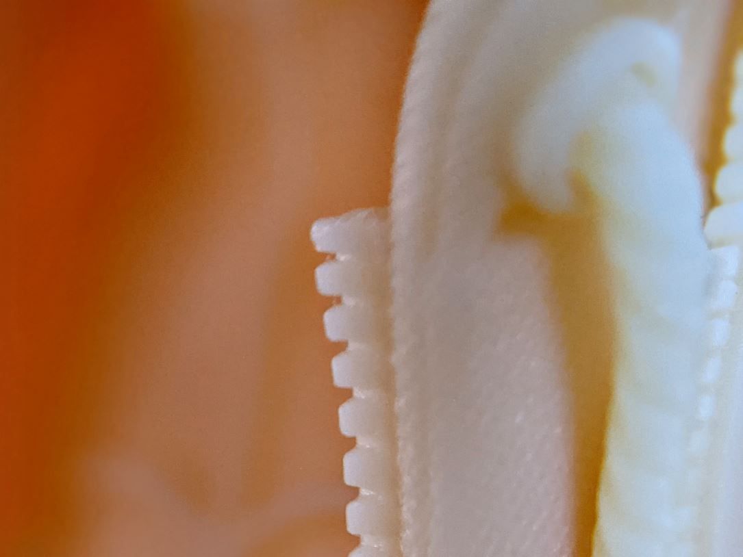

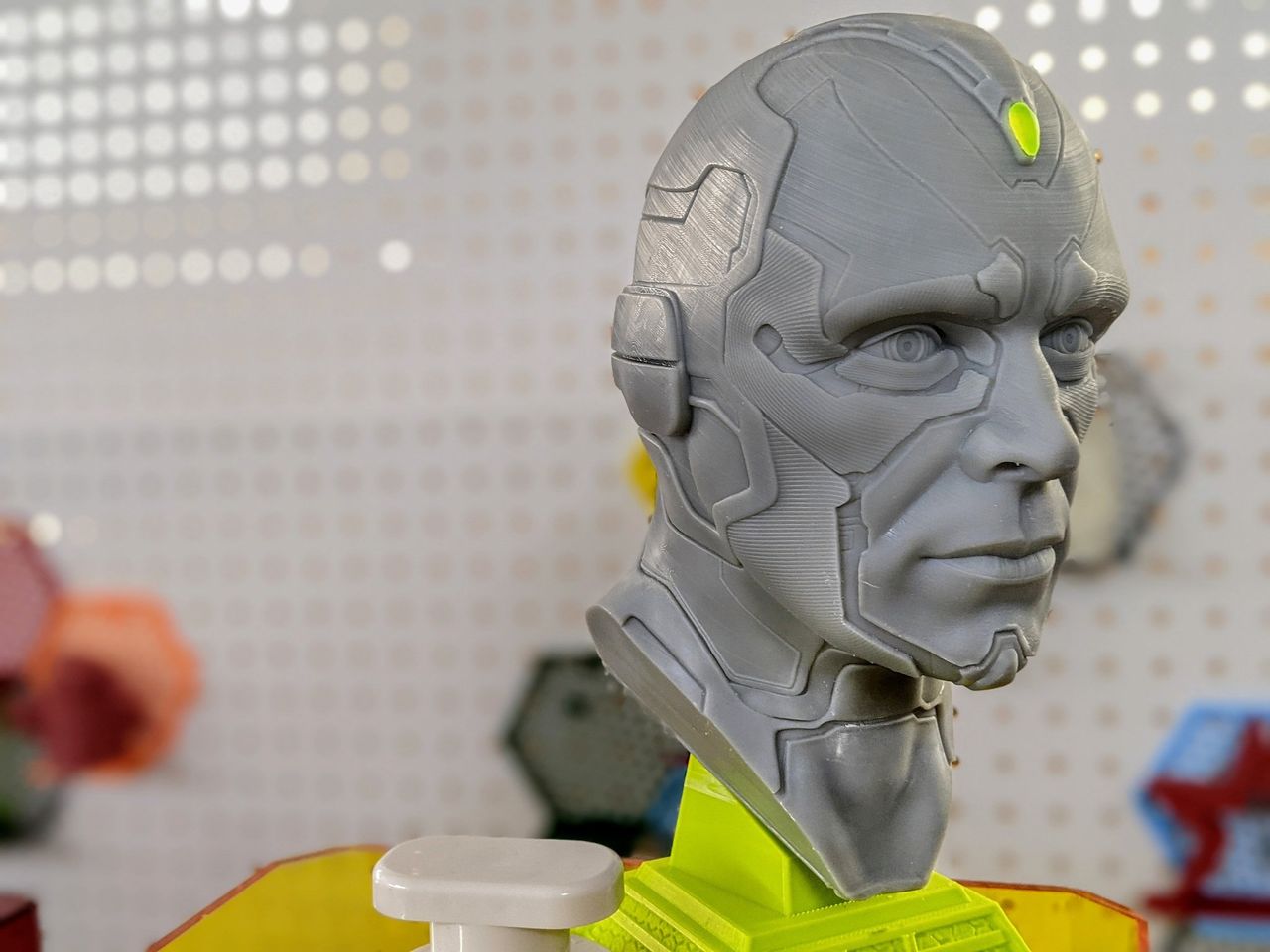

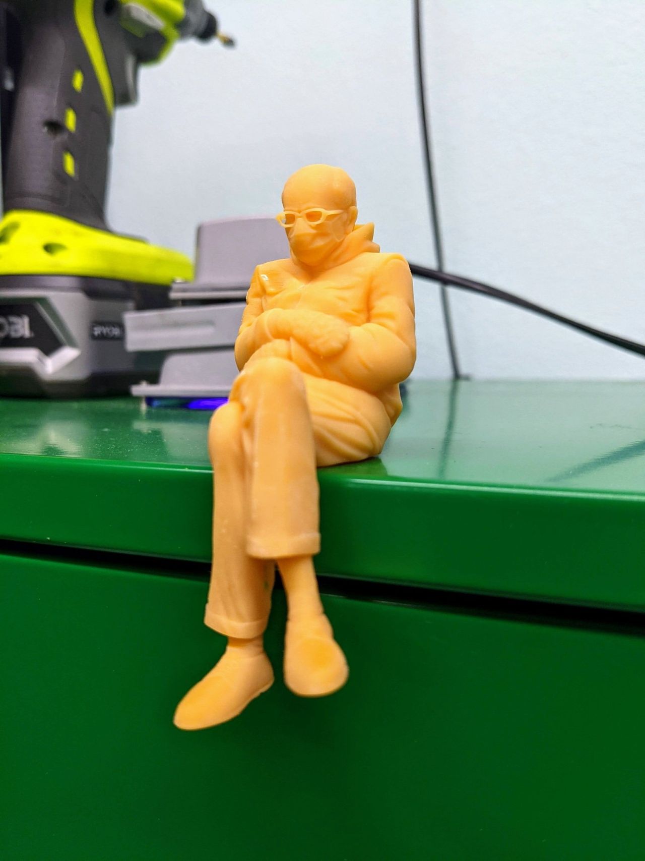

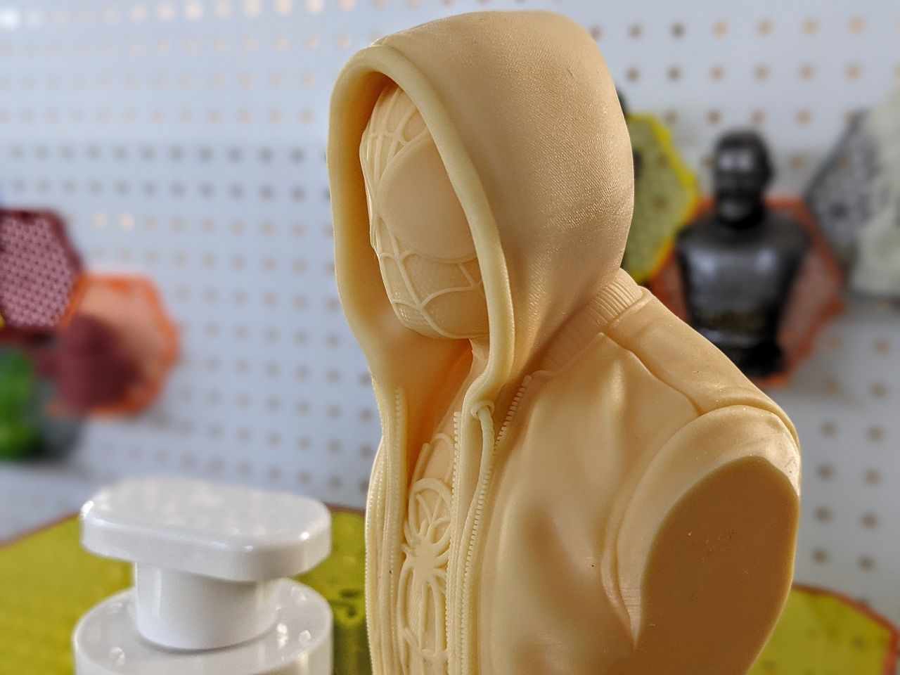

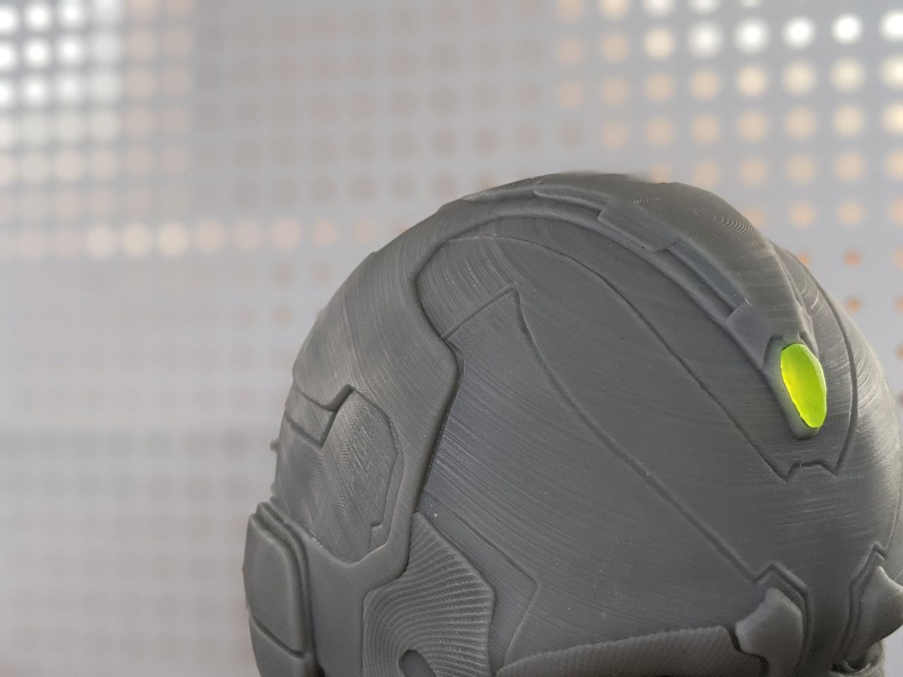

As you can see from the images above, the Mono X is capable of some fantastic prints. While you can see some banding on the Vision bust from Fotis Mint, that was mainly my fault since I didn't support the model correctly, Even so, it's still a beautifully detailed print, and you can see the detail the Mono X is capable of. The Miles Morales Spider-Man is even more detailed, with each tooth on the zipper visible. There are even strands on the pull strings. Even smaller prints like the Bernie meme from Chaos Core Tech didn't lose definition, and the glasses that are always difficult to print came out really well.

The Mono X mono screen allows you to print considerably faster — around 1.5-2 seconds per layer, which considerably reduces your print time. Even against other mono screened printers, 1.5-second layers are impressive. I printed the Vision bust on two different printers; one took 12 hours, while the Mono X only took eight.
