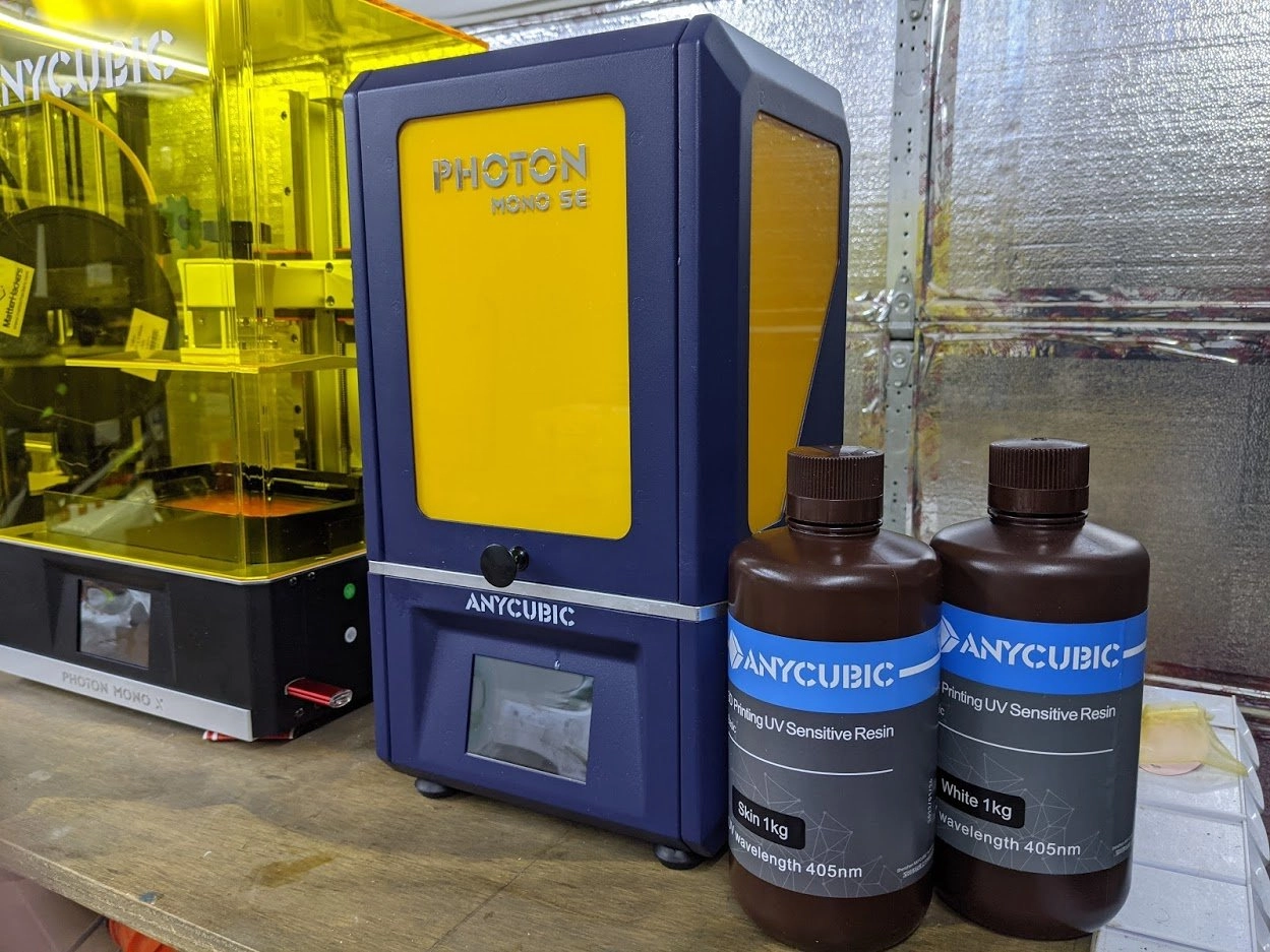

Anycubic has been making some of the best 3d printers for years. Ever since the Anycubic Photon released, I have been a fan of the resin printers they produce, and the Photon Mono SE is no exception. I've spent a lot of time with a Mono SE that Anycubic sent me, and I really like what I've seen so far. A few issues make it harder to recommend, though, so let's dig in.
Bottom line: Anycubic has released multiple printers aimed at different markets, and while some are for the hobbyists, the SE is aimed directly at commercial businesses. It's really great for that purpose too.

One of my favorite things about the Anycubic Photon line is the metal body. It makes the printer feel like a premium product, and while the yellow UV protected screens are supposed to be transparent, I opted to keep them with the protective cover on. It makes the printer look amazing and protects against the sun. The feeling of strength runs all through the Mono SE, and that solidness helps create some excellent detail in the prints. The dual linear rails and lead screw work really well to keep the build platform stable, and the bed has a leveling system that keeps everything locked in place print after print.

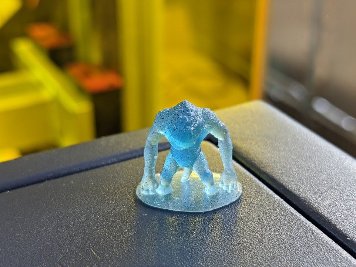

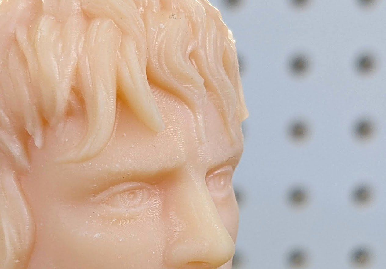

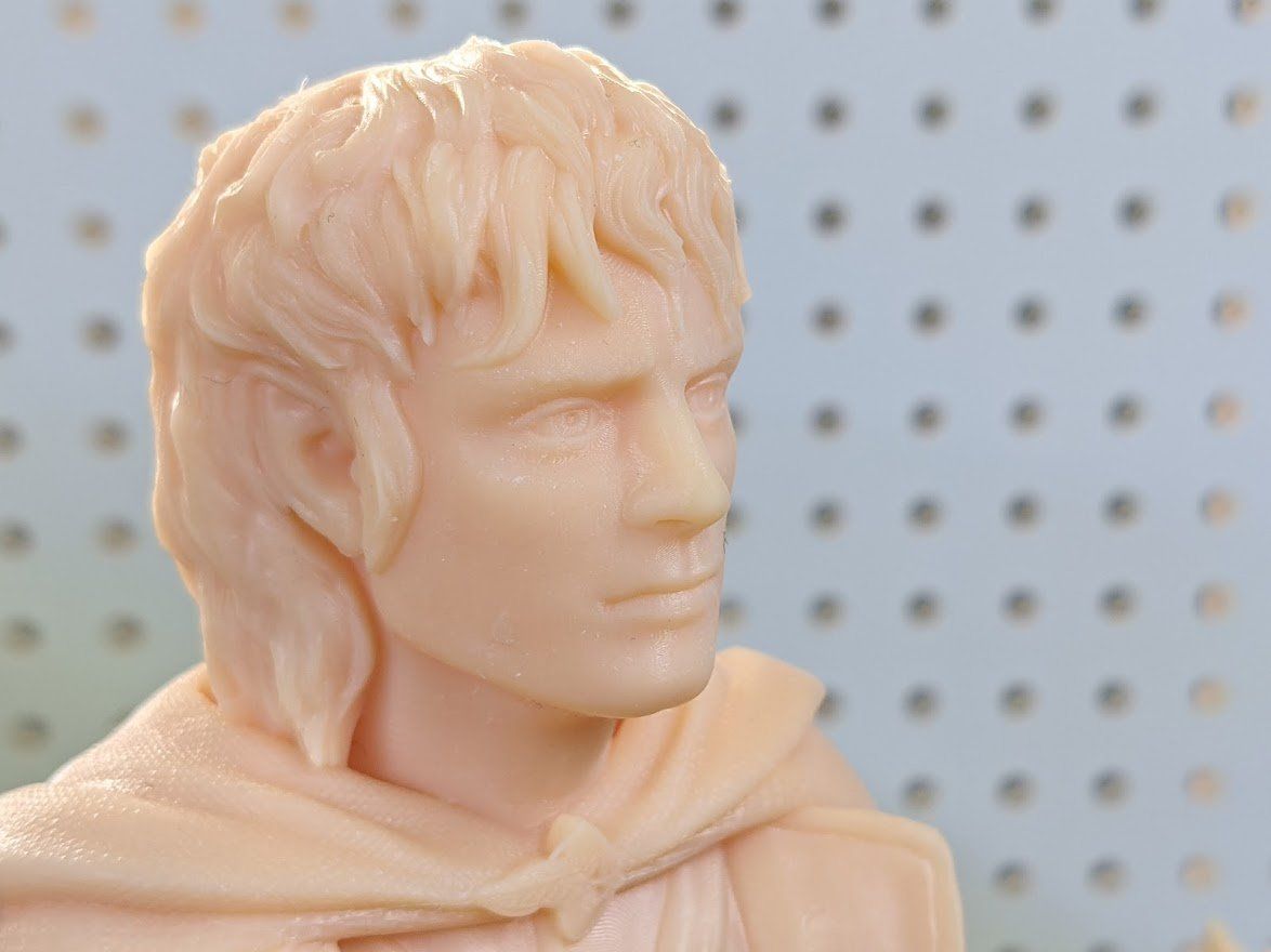

The print quality on the Mono SE is exquisite. I know that almost all resin 3d printers have excellent model quality, but all of the Mono SE enhancements make even the smallest details stand out. When printing the Frodo model from Fotis Mint, you can see every detail, including the tiny lines in Frodo's iris. This level of detail is extraordinary. I had a lot of fun trying to get as much detail as possible from the Mono SE, including printing this Rancor from ChaosCoreTech as small as I could get it. It is hard to see in these photos, but you can see every little bobble on its skin and each claw on its hand with the naked eye. It is an amazing model, especially when it is an inch tall!

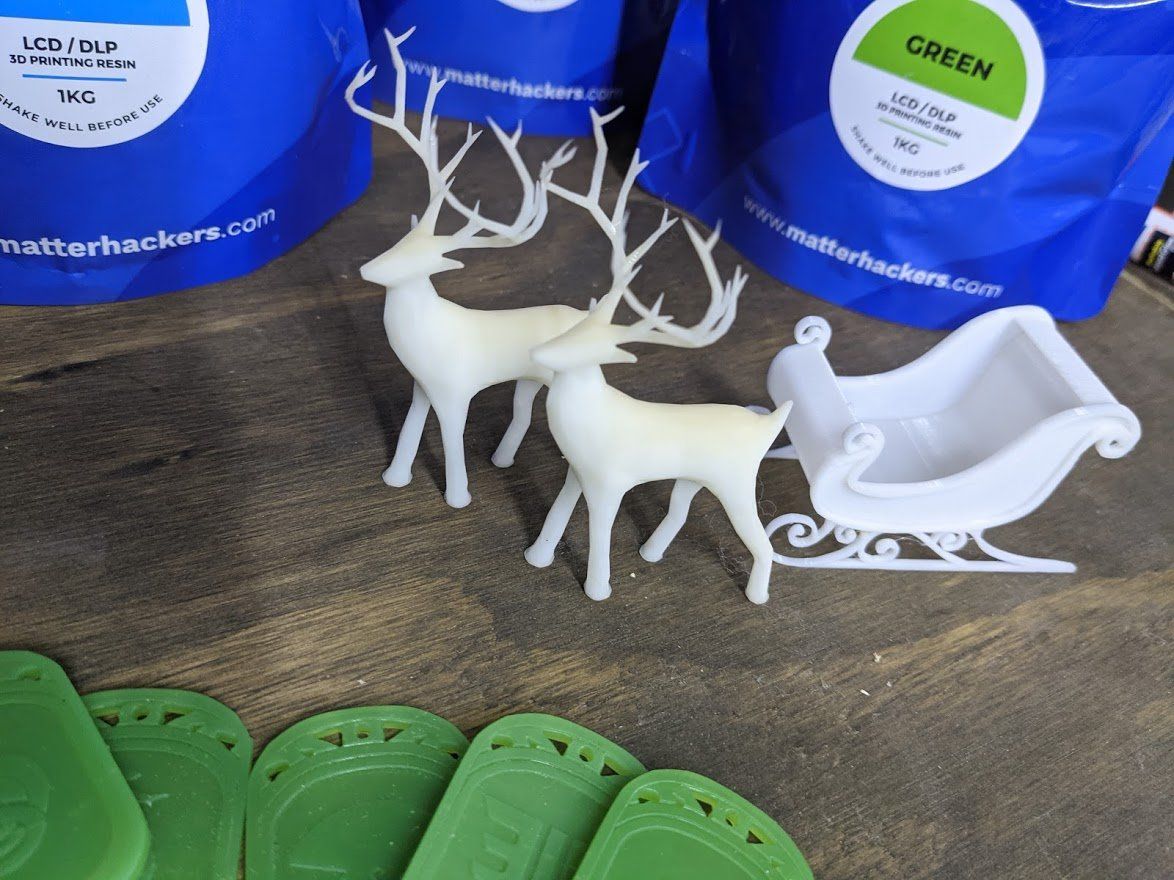

Because the Anycubic Mono SE has a monochrome LCD, it can achieve incredible speed for a 3d printer. Like its baby sister, the Anycubic Mono, the SE can print at layer speeds of 1.5-2.5 seconds depending on the resin. In practical terms, that means you can print the same model in about 60 percent of the time a regular LCD screen would take. That's a pretty huge saving, especially if you are a small business making models for profit. In fact, the Mono SE excels at the type of detail that a dentist or ring maker would need to complete their work to a high standard. The Mono SE feels like it is aimed at those people, rather than the casual hobbyist that would be better served with the more affordable Photon Mono. The internet connection is another boon for professionals as it allows you to monitor when a print has finished so you can use your time more efficiently. You can also load your prints onto it via Wi-Fi, but be careful to make sure you don't have an old print on there first!
