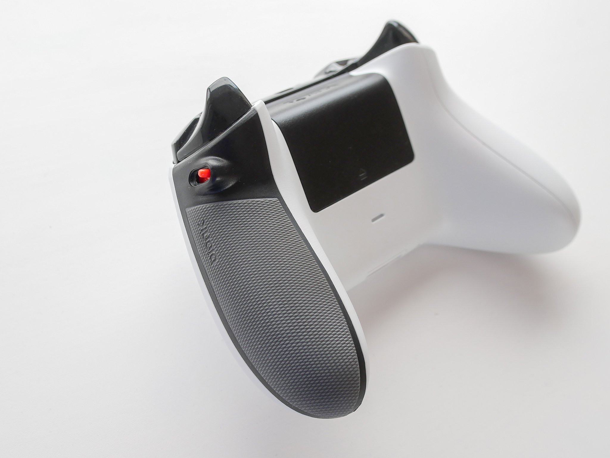

That's it. Inside the Quickshot kit, you get a plastic pry tool which will help you remove the old grips and put the new ones on. I've tried this on the newer Xbox One controller that launched with the Xbox One S, but there's no reason to think it wouldn't also fit the original model.
Applying the Quickshot is really simple.
- Use the plastic pry tool to prise one of the rear grips away from the controller. It's best to start at the top by the triggers as you have an easier edge to get into.
- Once the grip has popped away, firmly pull away from the controller body. It's connected by plastic lugs, but they're pretty sturdy and you'll have to be firm.
- Repeat steps one and two on the other side.
- Firmly push down each Quickshot grip until they click into place. There should be a seamless fit with the controller, so make sure to push down along the whole edge.
That's all there is to it. You now have fully functioning trigger stops on your standard Xbox One controller. To turn them on, just slide the orange latch across and you'll immediately feel the benefits of less travel in your triggers.
