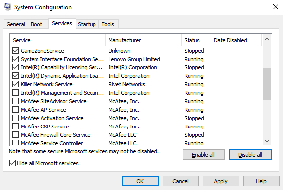

  1. Type msconfig and hit Enter on your keyboard.
  2. Click Services.
  1. Click the checkbox next to Hide all Microsoft services.
  2. Click Disable all.

Once your PC restarts, only the essentials will boot. If you were having issues with a program or update, try to launch or install while in the clean boot environment. If the problem persists, you'll know that you don't have a software conflict and the problem lies elsewhere.

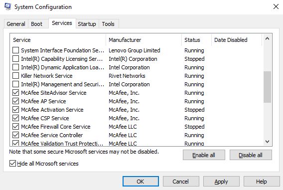

If the problem doesn't show up while in a clean boot, you can now attempt to find the offending program or service. The best way to do so is to repeat steps 1-5 above, but re-enable half of the services.
Re-enable the top half of all non-Microsoft services (anything crucial to Windows should be hidden by step 5). Once you restart your PC, test to see if the software conflict is back. If it isn't, repeat steps 1-5 again, but this time try re-enabling the bottom half of all non-Microsoft services instead. Restart your PC, and if the conflict is back, you'll know that the problem lies with one of the services in the lower half.
Whether the conflict lies in the top half or the bottom half of the services, you can now start to narrow down the search. Keep unchecking services and restarting your PC. Once you find that the issue is gone, you should be able to point directly at the problem.
