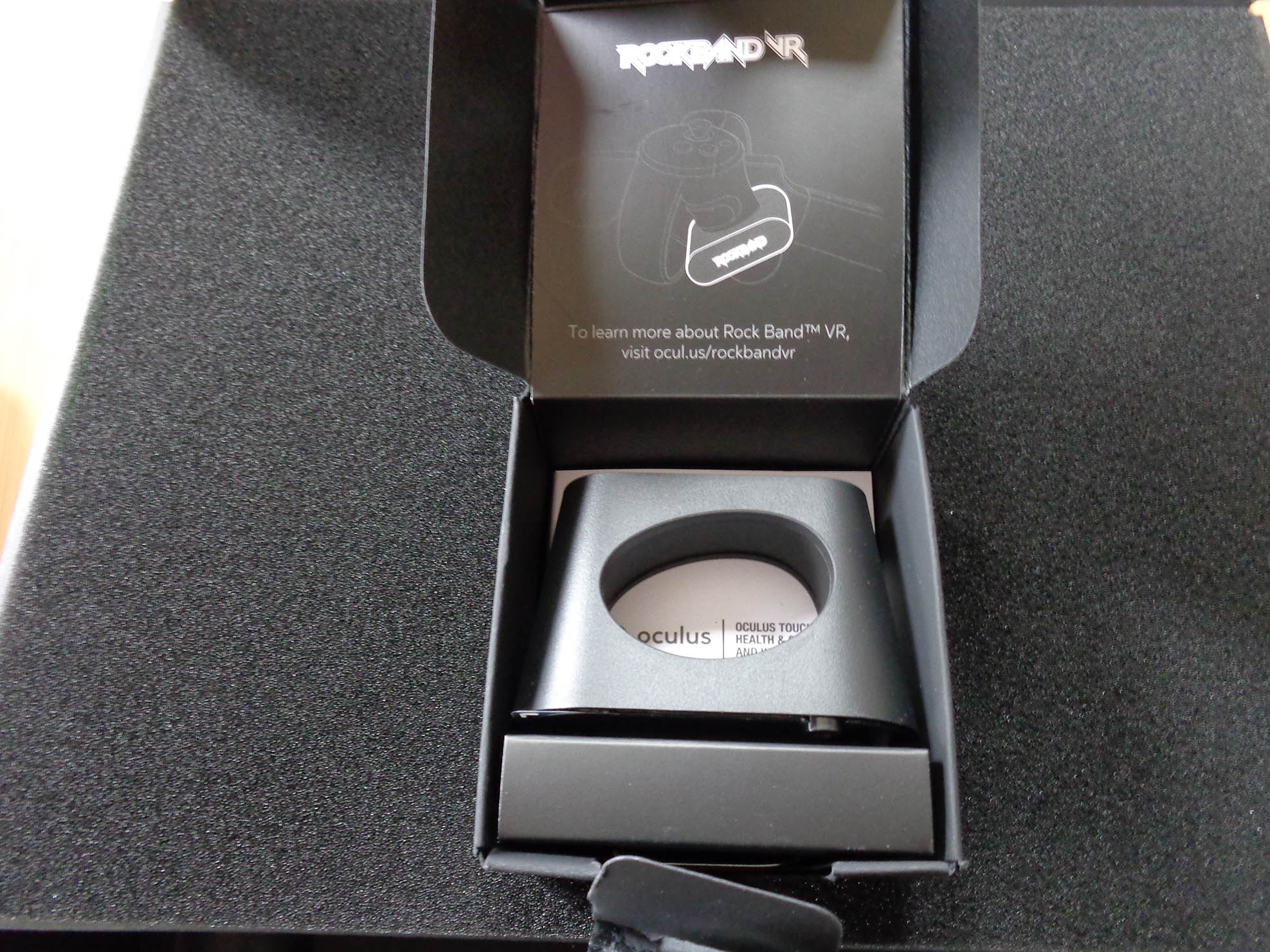

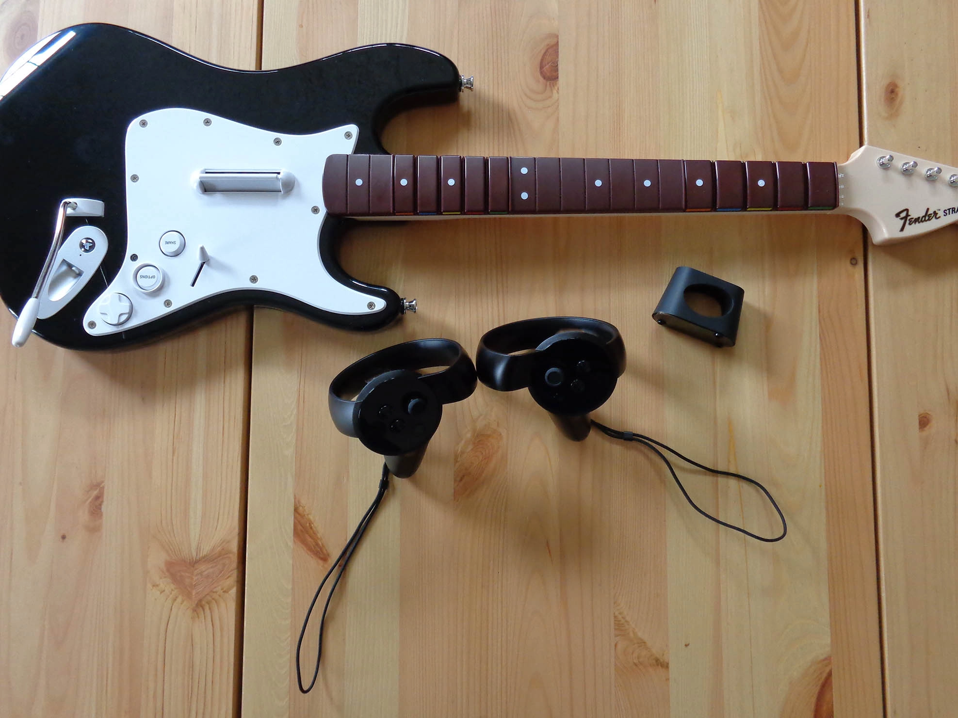

Other than the guitar controller, you'll also need Oculus Touch controllers and the connector for the guitar controller. The connector came with your Touch controllers and can be found in the small box on the inside lid of the Touch case.
To recap, you need:
  • Rock Band guitar (PlayStation 4 or Xbox One compatible)
  • Oculus Touch right-hand controller
  • Oculus Touch Rock Band connector
  • Microfiber cloth

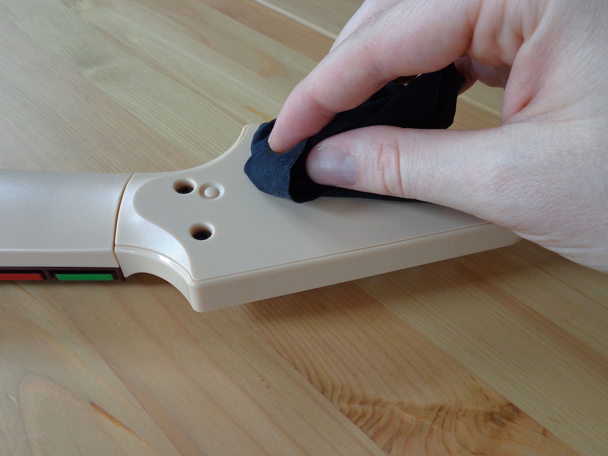

  1. Wipe the back of the guitar's head with a microfiber cloth to remove any dust or oils.

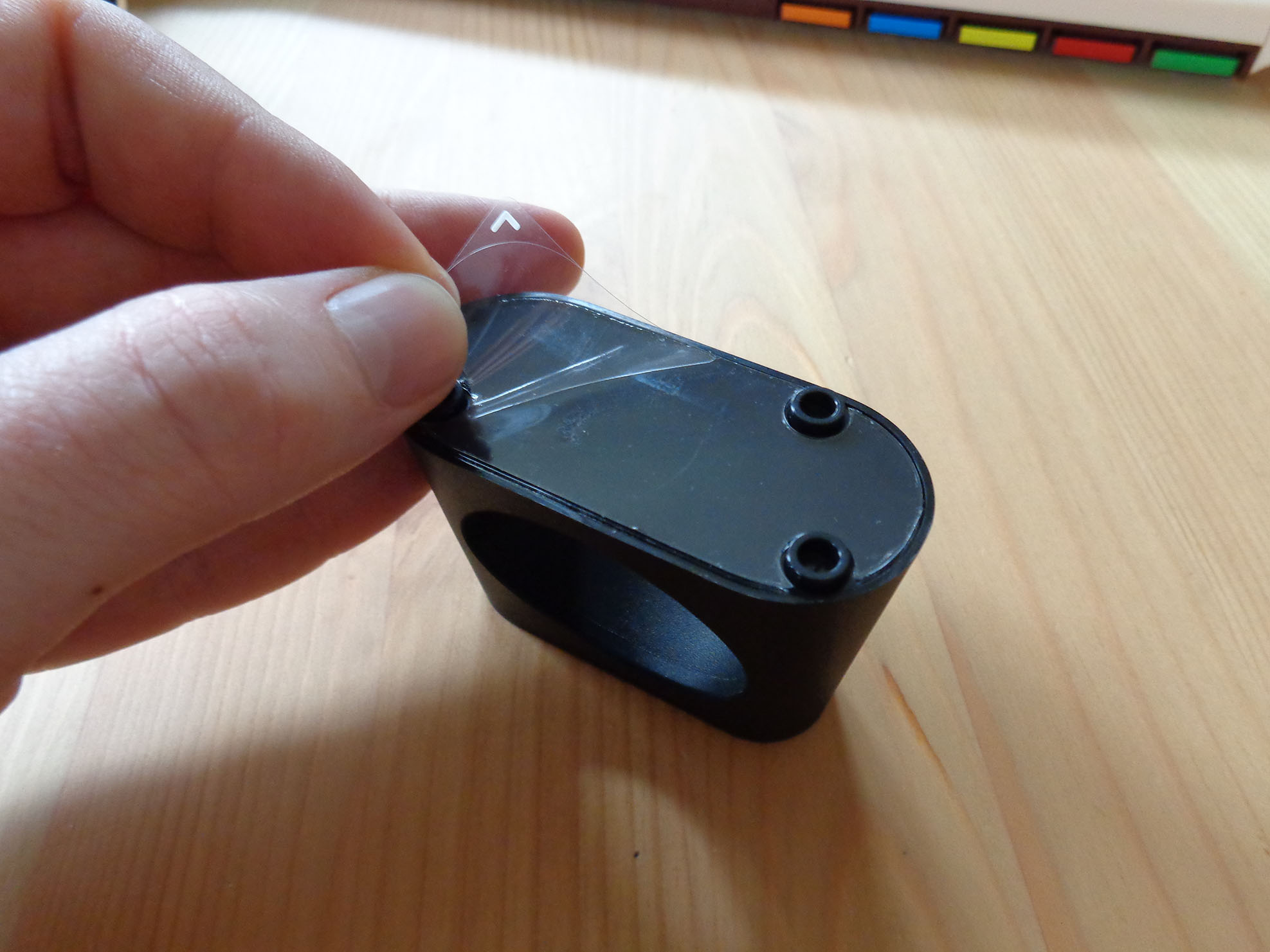

  1. Peel the sticker backing off of the Touch connector.

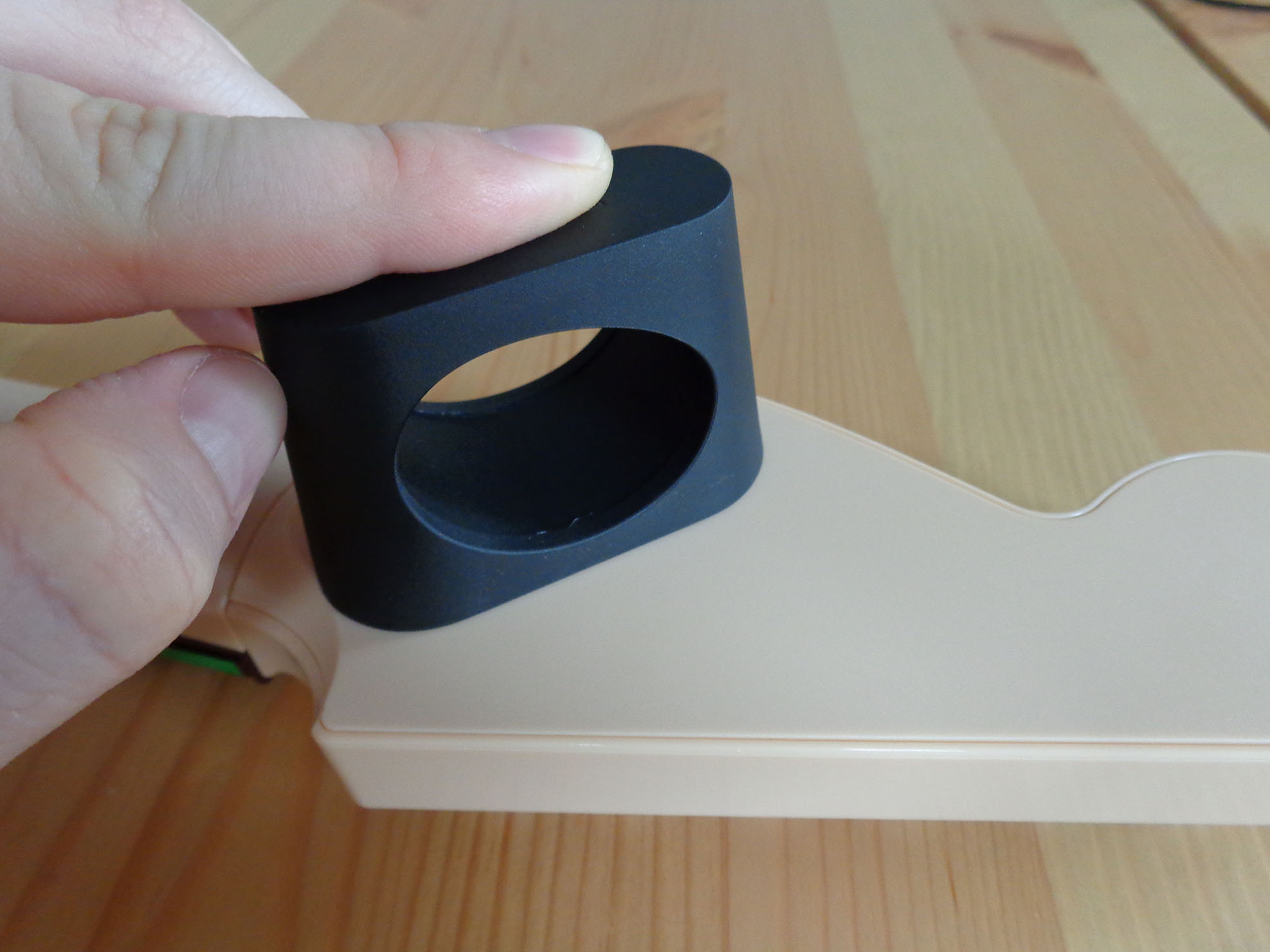

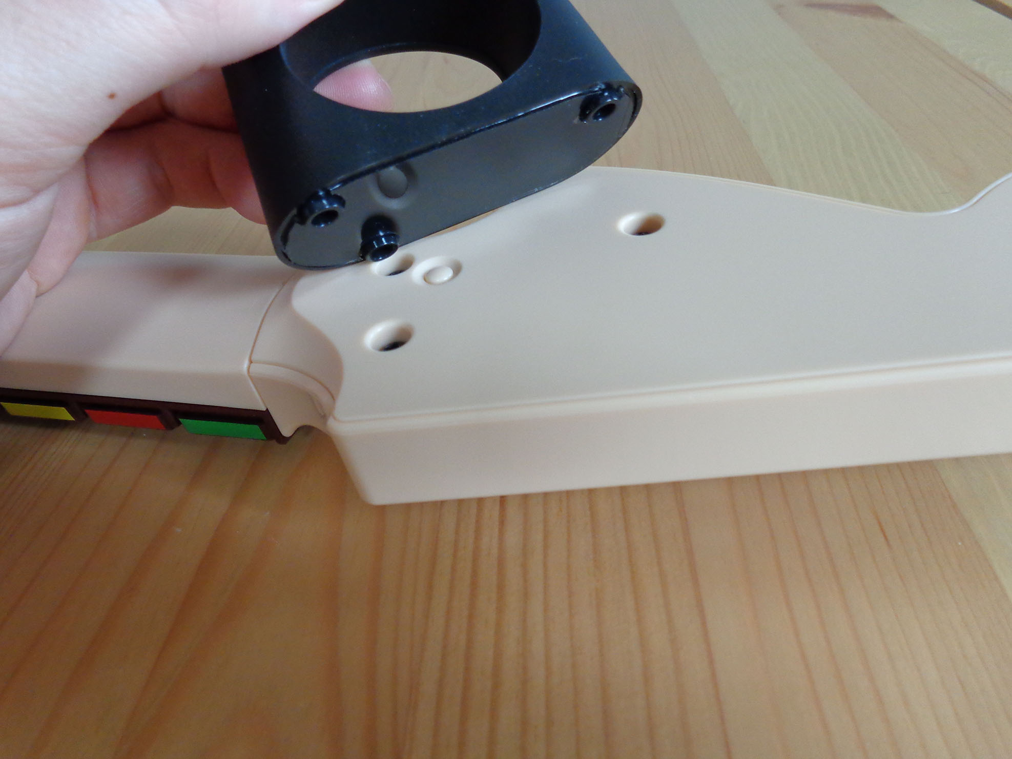

  1. Line up the holes on the guitar with the nubs on the Touch connector.
  1. Apply pressure to the connector so that it sticks in place.

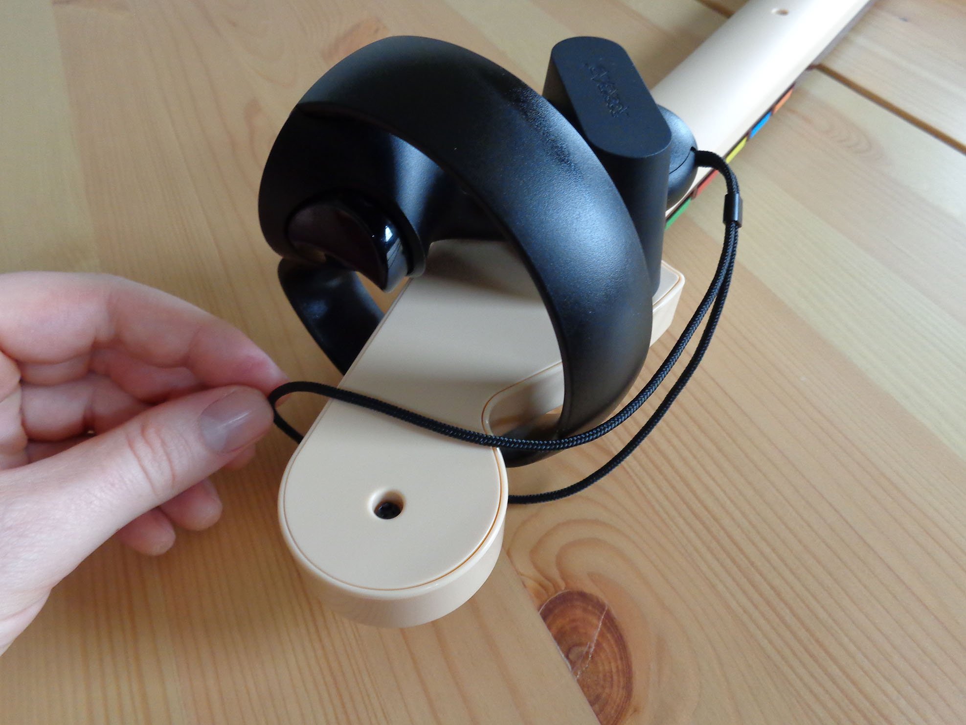

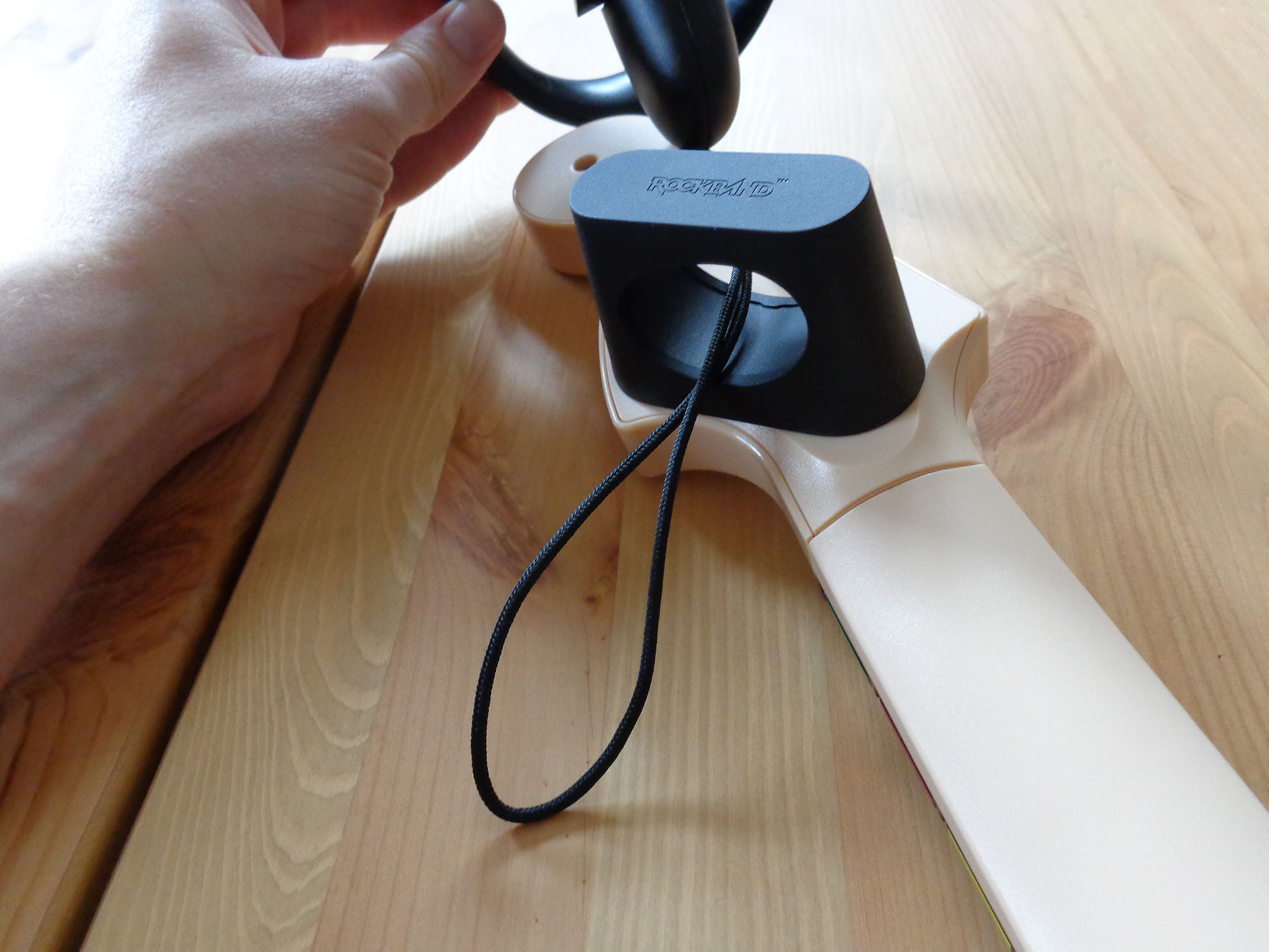

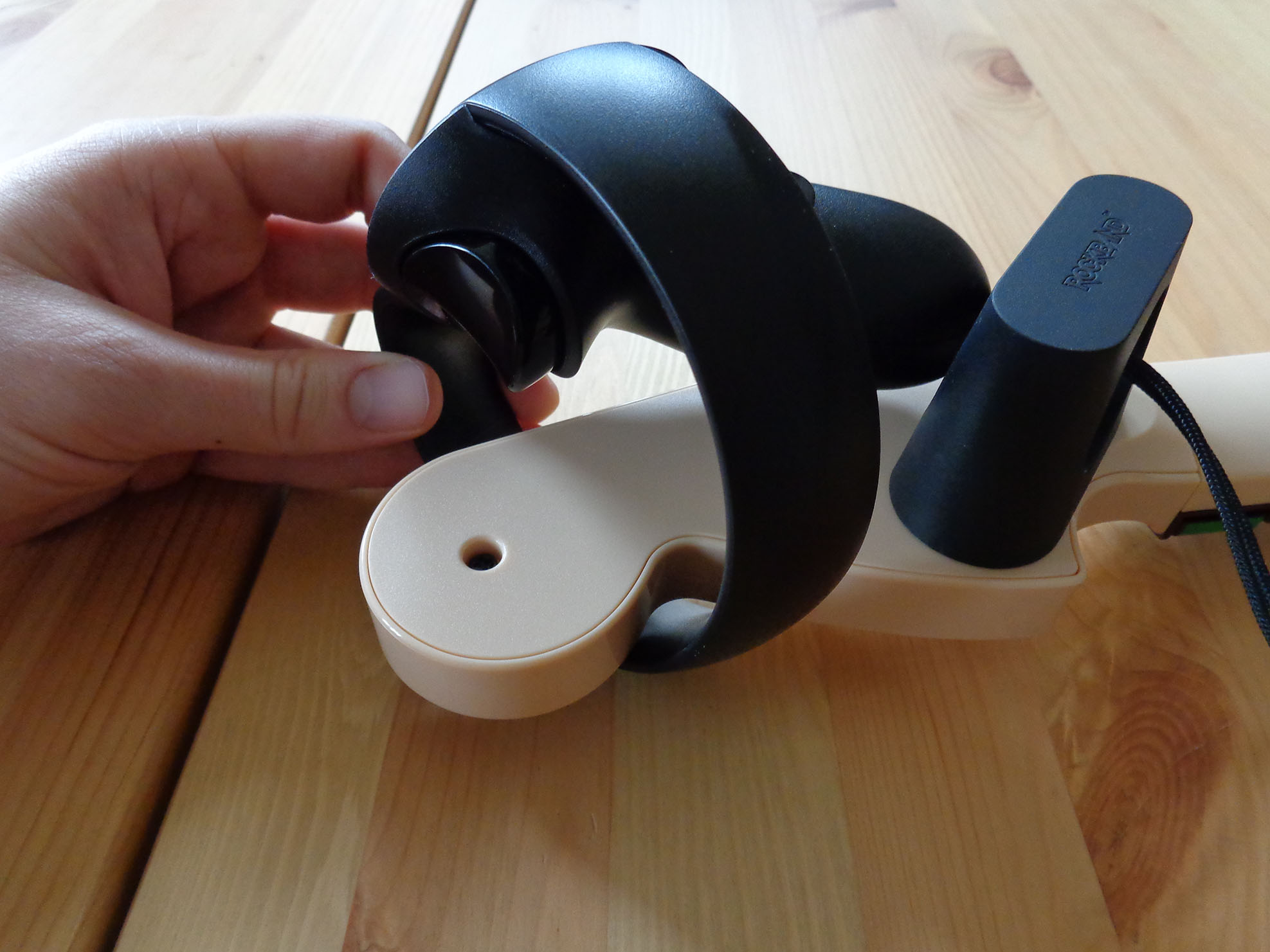

  1. Pull the right-hand Touch controller's lanyard through the connector.

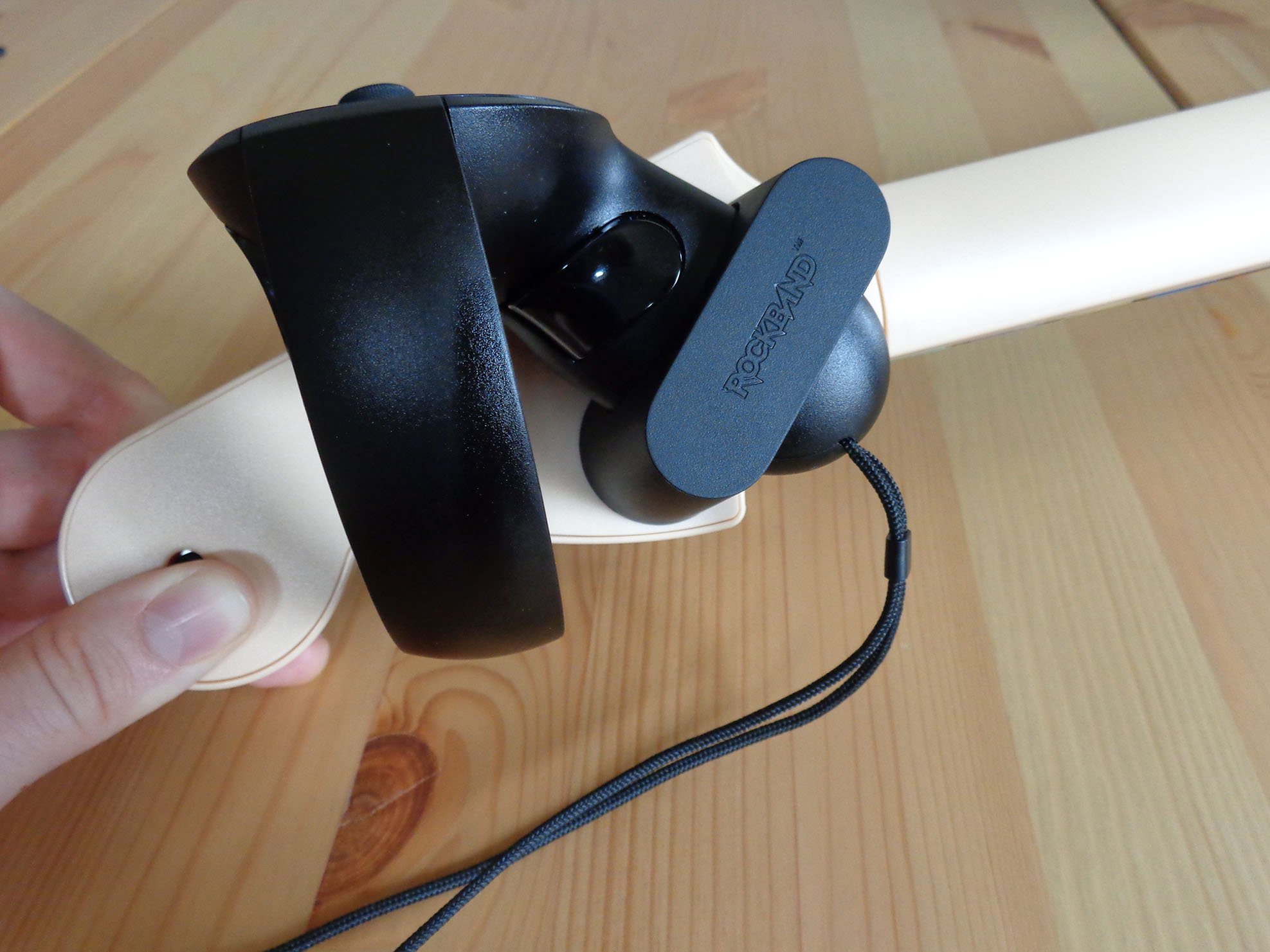

  1. Slide the right-hand Touch controller's ring over the head of the guitar.
  1. Secure the right-hand Touch controller in the connector.

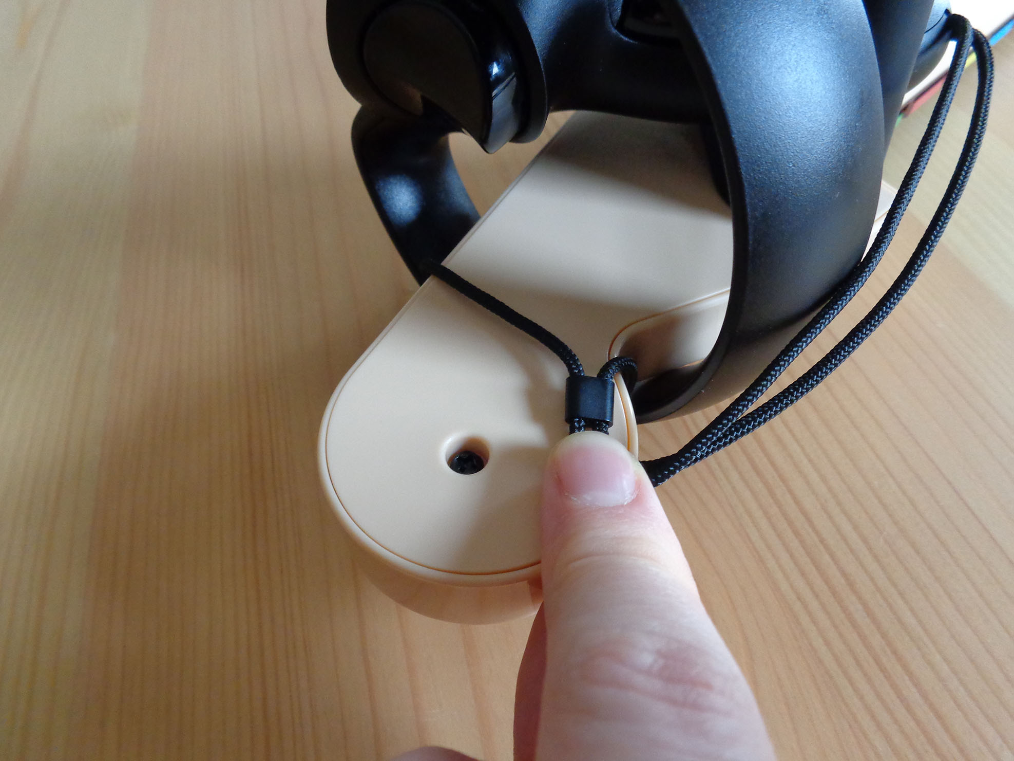

  1. Place the lanyard around the head of the guitar.
  1. Tighten the lanyard to ensure the controller does not fall off.
