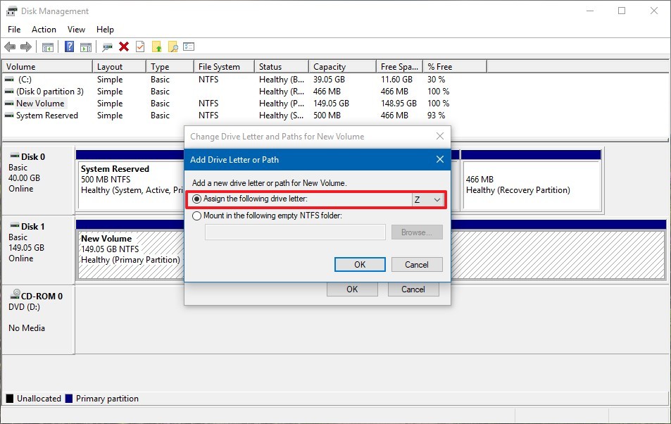

Resolving letter missing
Unless you're mounting the drive as a folder, it'll require a letter to be accessible from File Explorer.
If the letter is missing from the drive, you can assign a new one using these steps:
  1. Open Start.
  2. Search for Create and format hard disk partitions.
  3. Click on the top result to open Disk Management.
  4. If the drive doesn't have a drive letter next to the name, right-click the volume and select the Change Drive Letter and Paths option.
  1. Click the Add button.
  2. Select the Assign the following drive letter option.
  3. Use the drop-down menu from the right and select any of the available letters.
  1. Click the OK button.
After completing these steps, the storage should be accessible in File Explorer.
