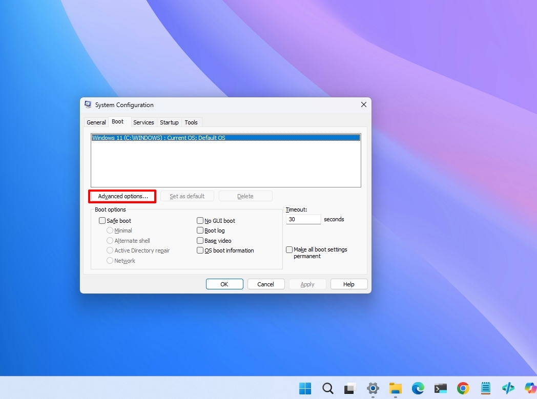

  1. Open Start.
  2. Search for System Configuration (or msconfig) and click the top result to open the app.
  3. Click the Boot tab.
  4. Select the current Windows installation (if applicable).
  5. Click the Advanced options button.
(Image credit: Mauro Huculak)

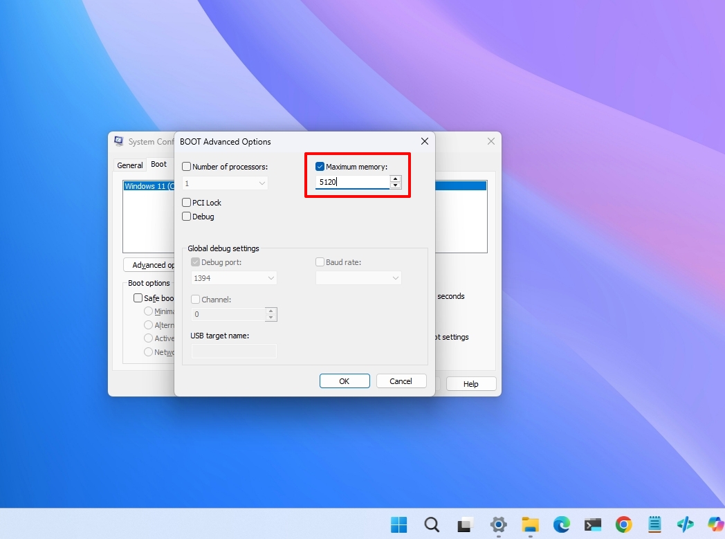

  1. Check the Maximum memory option.
  2. Confirm the amount of memory you want Windows 11 to use (in megabytes).
(Image credit: Future)
  • Quick tip: Since you have to enter a value in megabytes, use 4096 (4GB), 8192 (8GB), 16384 (16GB), or 32768 (32GB).

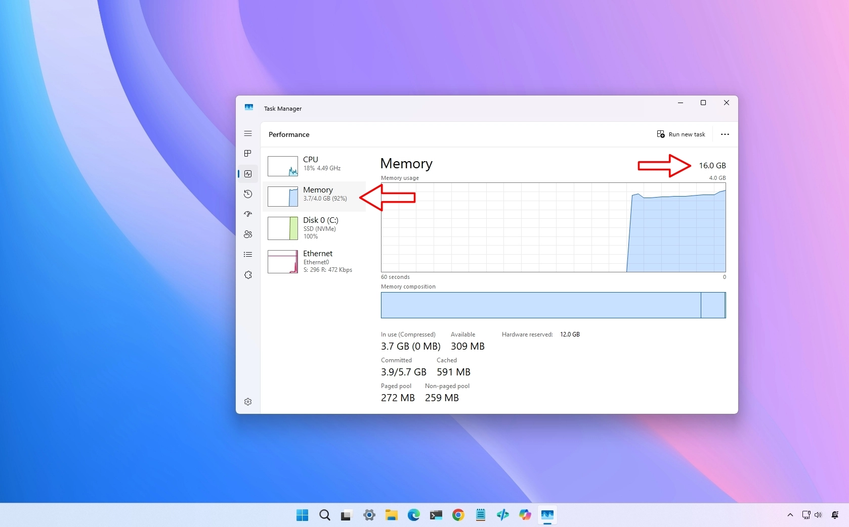

After you complete the steps, Windows 11 will only use the amount of memory you specified. Any remaining installed RAM will be ignored until you remove the restriction.
While I was testing this configuration, I noticed that Task Manager reported 3GB when I set the memory to 4GB, because the operating system doesn't get the full 4GB, as part of the physical address space is reserved for other components.
If your goal is to test the operating system with exactly 4 GB available, you may want to reserve an extra 1GB. For example, 5120 (5GB) to see 4GB in Task Manager. However, depending on how much memory you want to allocate, you may want to try different sizes.

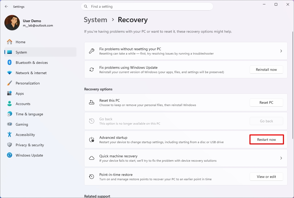

  1. Open Settings.
  2. Click on System.
  3. Click the Recovery page.
  4. Click the Restart now button under the "Advanced startup" section.

  1. Open Settings.
  2. Click on System.
