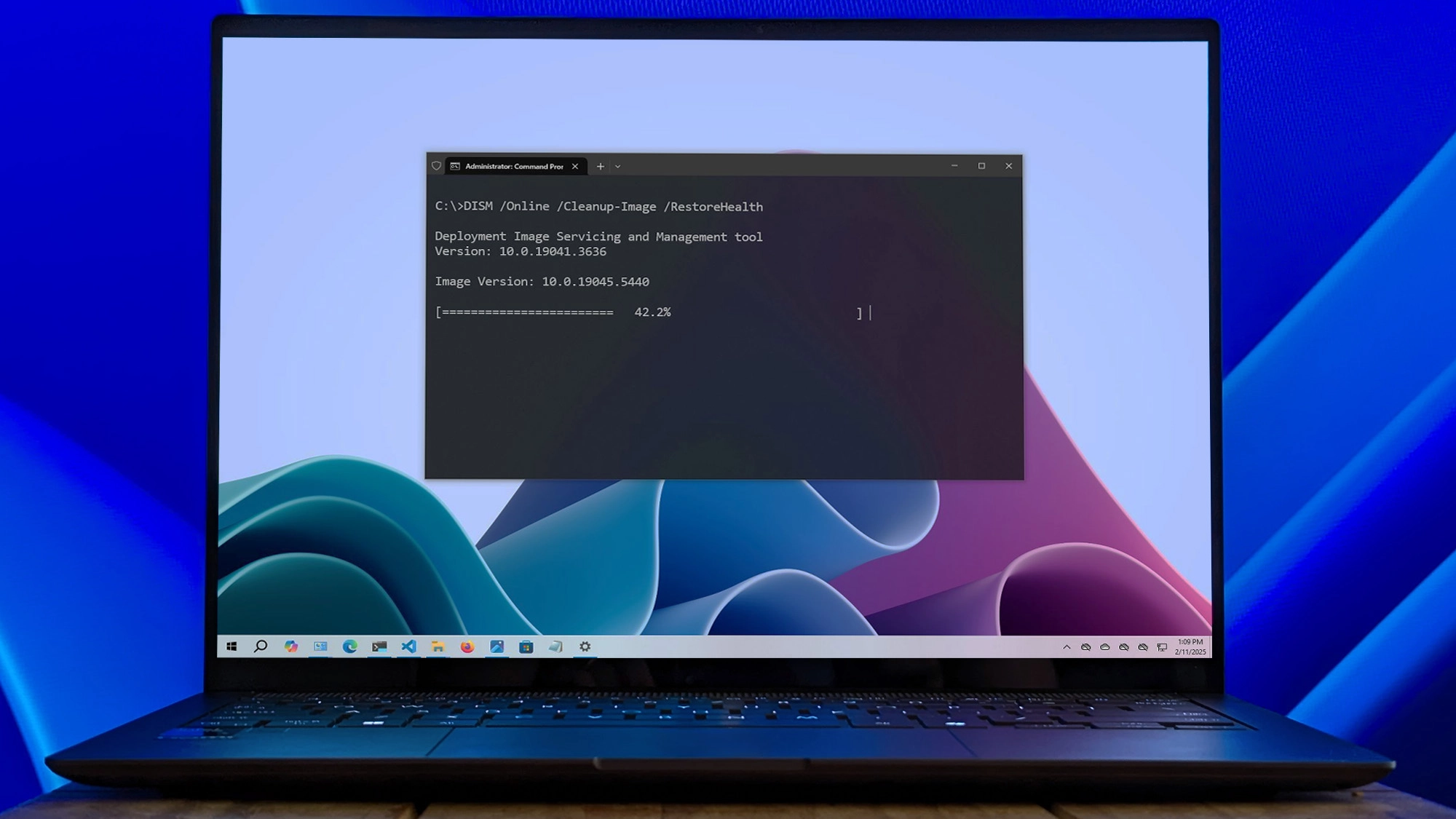

How to use DISM command tool to repair Windows 10 image
Windows 10 DISM settings displayed on a laptop
You can use the DISM command tool with the System File Checker (SFC) to fix problems with the installation. (Image credit: Ben Wilson | Windows Central)
Deployment Image Servicing and Management (DISM) is a command-line tool built into Windows 10 that allows network administrators to prepare, modify, and repair system images, including Windows Recovery Environment, Windows Setup, and Windows PE (WinPE). However, you can also use the tool with the local recovery image to fix most system problems.
When you try to fix a specific error, figure out why the computer stopped booting correctly, or resolve performance problems, the System File Checker (SFC) is one of the best tools to replace missing or corrupted system files using the recovery image. The only caveat with this approach is that if one or more system files in the local image are damaged, the SFC command won't work. In this scenario, you can use the "install.wim" image file with DISM to repair the image and then use the SFC tool to fix the setup without reinstalling the operating system.
In this how-to guide, I will show you how, in 2025 and beyond, the DISM and SFC are the best tools for restoring a computer from a broken to a healthy working state without reinstallation.
Warning: The commands outlined in this guide are non-destructive, but since you will be making system changes, it is still recommended to create a temporary full backup before proceeding.
How to use DISM to repair image of Windows 10
The DISM command tool includes multiple features to repair a system image, including "CheckHealth," "ScanHealth," and "RestoreHealth," and you want to use them in that order. Also, depending on the issue, you can use the "RestoreHealth" option to fix the locally available image using different source files.
DISM command with CheckHealth option
The "CheckHealth" option with the DISM determines any corruptions inside the local Windows 10 image. However, this option does not perform any sort of repair.
