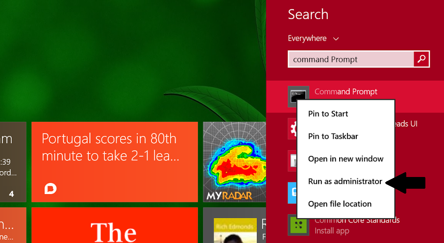

You'll also need to run Command Prompt from an admin level. You can do this by simply typing 'Command Prompt' in the Windows 8 search bar and then right click to bring up the context menu. Select 'Run as administrator' to get started. You'll also want to have a temporary directory created to output the report, such as C:\Temp, so make sure you have that created beforehand. Finally, just enter in 'powercfg sleepstudy' at the command prompt to produce the analysis.

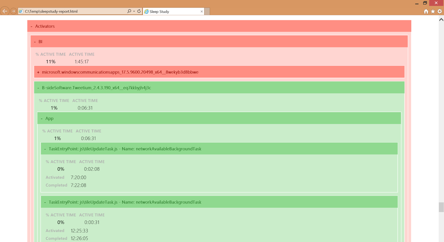

The final report is spit out into the temp directory as 'sleepstudy-report.html', meaning you can just open it in a web browser. The whole process took only seconds to generate. Everything from network information to software and hardware activity reveals itself in the report. It's even color-coded with green, yellow or red for activity level intensity.
I won't explain what the report means because it's very, very detailed, and Chin did an excellent job of explaining how to read it. So once you get started, head over to the Windows Experience Blog linked below to get all the finer details.
