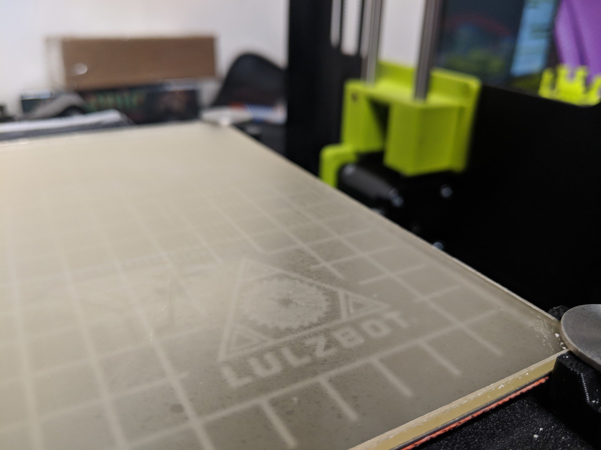

Before each print, the printer will move the nozzle to the back of the machine and scrub it over a rough material to clear any debris, then it will use the auto level points on the PEI covered bed to make sure your build surface is perfect. The PEI sheet – a type of yellow plastic that seems to stick PLA and ABS to it like glue, then release it with just a little pressure – is thick with just the right amount of roughness to help the print adhere to the bed. Of all the prints I managed to finish, only one failed due to poor bed adhesion, and a little application of Magigoo fixed that problem on the next go.
