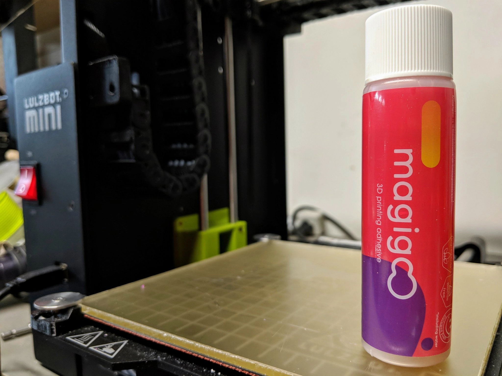

Magigoo on a LulzBot (Image credit: Windows Central/ James Bricknell)
The Magigoo Pen is the very best adhesive for your glass print bed when using ABS, PLA, or PetG. It holds your print firm to the bed then releases it easily when cooled for a hassle-free experience.

The Magigoo Pen is perfect for anyone working with the standard filaments we all use. PLA, ABS, PetG, and even TPU will stick far better with Magigoo on glass than they do with just hairspray or even Elmers glue. Magigoo even works well on PEI, though it is specifically designed for glass. The only surfaces it definitely doesn't work on is blue tape and Kapton tape so avoid those if you can.
What makes it so special?
I've been using Magigoo for about two months now and I cannot imagine going back to just hairspray or any other build plate adhesive. Every time I use it, the print holds to the bed perfectly. Then, when the print is finished and the bed is cold the model just pops off with a twist — I haven't used a palette knife in weeks — it really is that simple.
I cannot imagine going back to any other build plate adhesive
The applicator itself is extremely helpful. It makes sure you apply just what you need where you need it. No more spraying hairspray over your smooth rods trying to get it evenly on the bed. Just spread the Magigoo one way then the other and it's done. The bottle says it can do over 100 applications but I only apply it to the exact place the print will be, not all over the bed, so it has lasted way over 100 prints.
And the final icing on the cake? It washes off your build plate and your print with just warm water. No need for chemicals to remove the residue, it just comes off ready for another coat. So simple.
