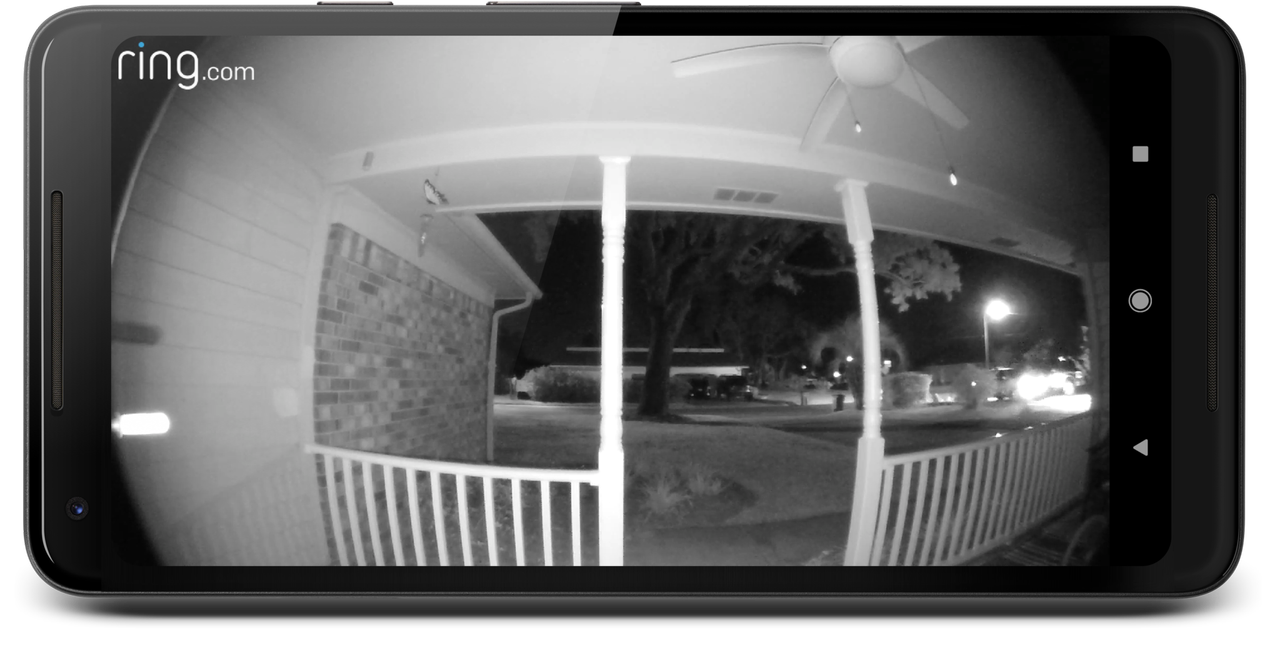

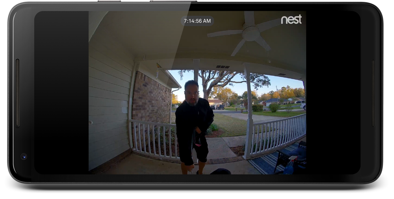

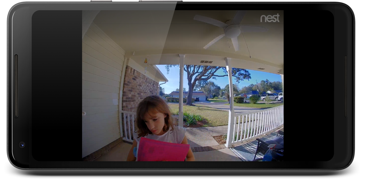

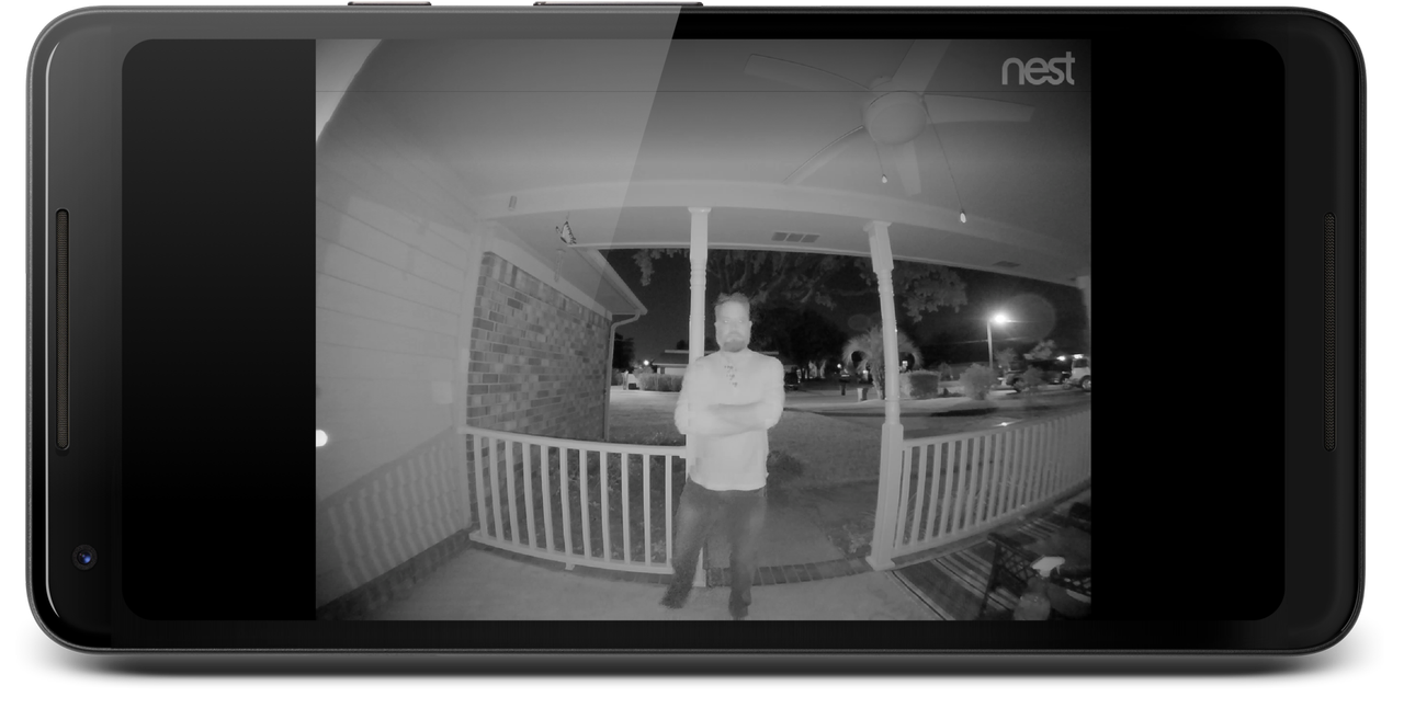

All that's great, though. But what's really sold me on Nest Hello is that it just looks so much better than anything else I've used. It touts having HDR baked in, and there's definitely a noticeable difference, especially on a front porch that's often backlit. Night mode is just fine, too.
Damn, it's just better ...
