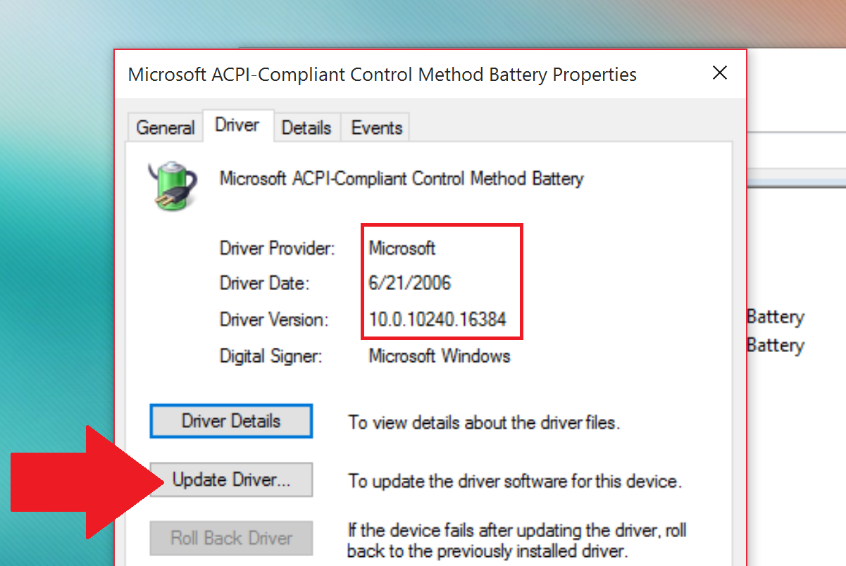

1. Device Manager
Right-click on the Start menu and choose Device Manager
2. Battery
Double-click ACIP-Compliant Control Method Battery. (Note: Surface Book owners will have two of these as there are two batteries to update on that device)
3. Driver
Under the battery's properties choose the Driver tab. Here you should see the current driver installed, and it likely says Microsoft and is dated 6/21/2006.
4. Update Driver
If your driver says 2006, just hit the Update Driver button
5. Search
Choose Search automatically for updated driver software. This tool uses the Microsoft database to install the proper driver for that hardware. This is not a 'hack', but a legitimate way to update system drivers. Usually, Windows Update catches them, but not always.
6. Installed
You should see a Windows has successfully updated your driver software message. You can then hit Close and verify the driver as **NEC Personal Computers, Ltd., dated 6/20/2013 and version number 1.0.0.5.
Remember, if you are on a Surface Book, you need to do this process twice. The AC Adapter will not have a new driver, so just choose Battery.
7. Restart
With new drivers, it is always good to restart the OS.
