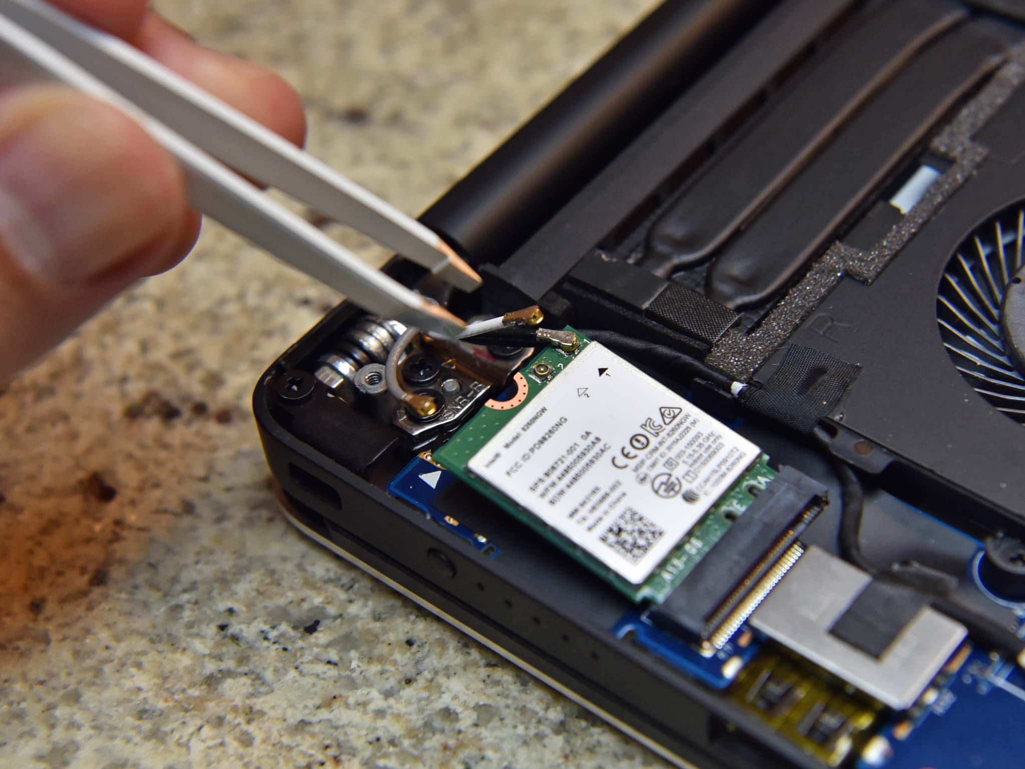

Changing the Wi-Fi card is very easy. You only need a single Philips Head screwdriver and optionally a pair of tweezer or small pliers to handle the antennas.

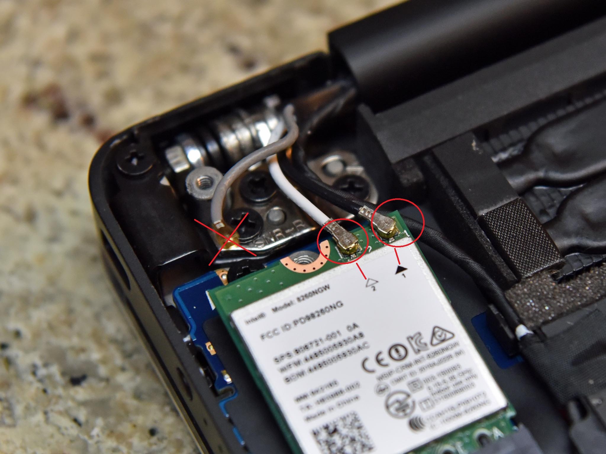

The seemingly tricky part is the antenna cables. They simply snap on like little buttons and are not soldered. You just pop them off and can push them down again to reconnect making the change out easy.
- Remove the Philips head screw and put it to the side.
- Pop off the three antenna cables with tweezers.
- Gently lift and pull the old Wi-Fi card out at a 45-degree angle.
- Replace with Intel 8260 (or whatever you bought) by sliding into the slot at a 45-degree angle.
- Snap the Black and White antenna cables back to the new Wi-Fi card (note the matching arrows).
- Tuck the gray wire to the side or put it just under the card.
- Screw the holding plate back on from Step 1.
