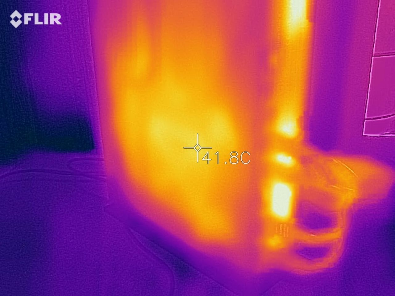

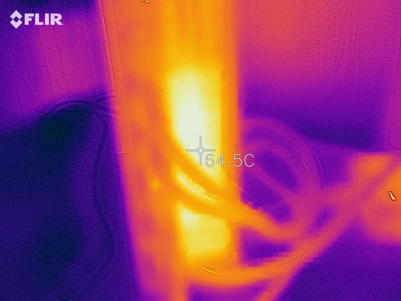

For actual numbers, the images below show where each console is hottest and the temperatures they each reached.
In our Xbox One X review we found it ran at 68C (155F) at its hottest point, and in my own testing that's about the same. The exhausts on the rear get pretty darn hot, with my own test clocking in at around 65C (149F).
The top and bottom of the console weren't nearly this warm, coming to 42C (107F) and 36C (97F) respectively at their hottest points. In neither case is the console too hot to touch, but you'll need to keep it ventilated for sure in an entertainment center.

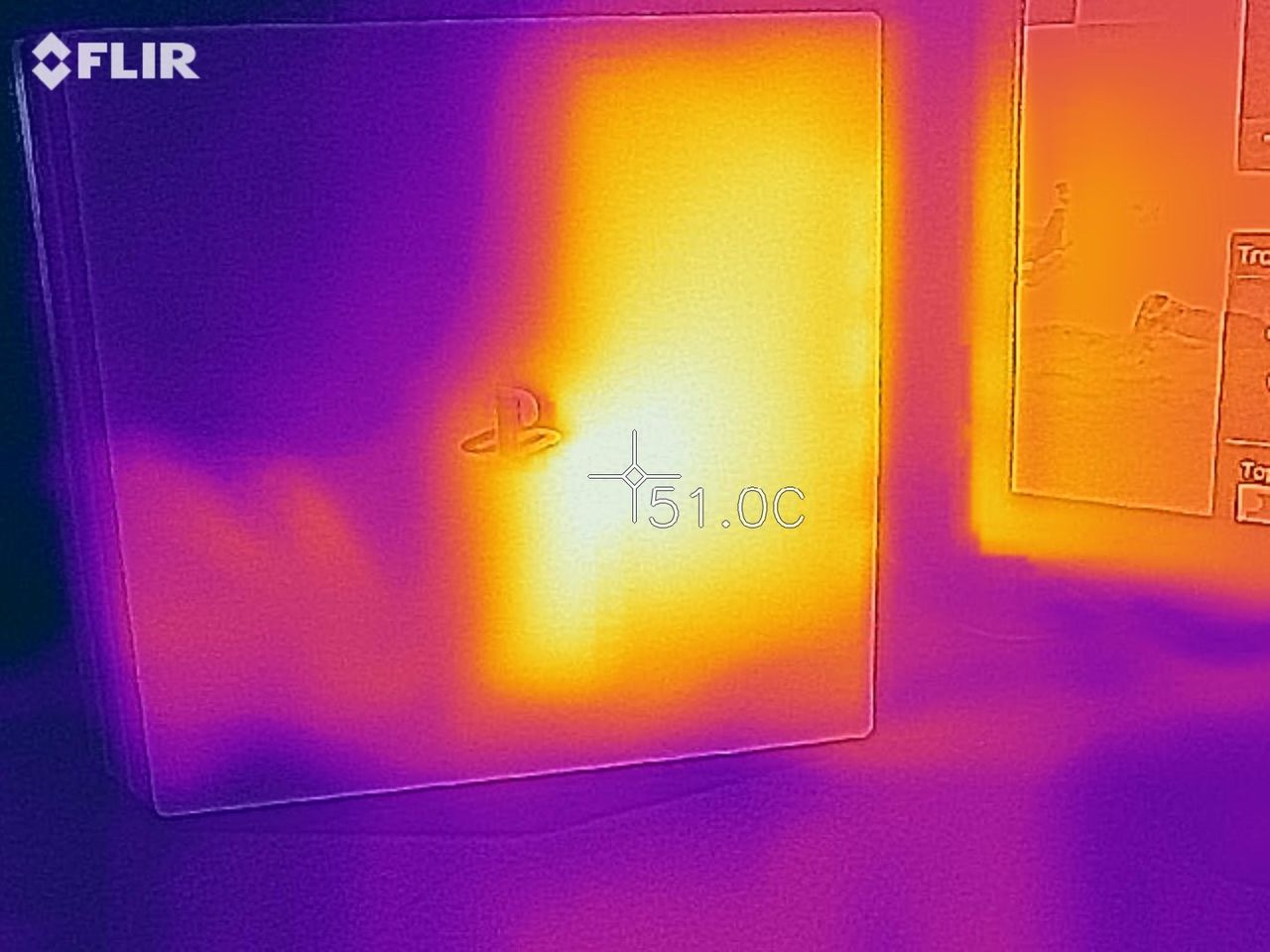

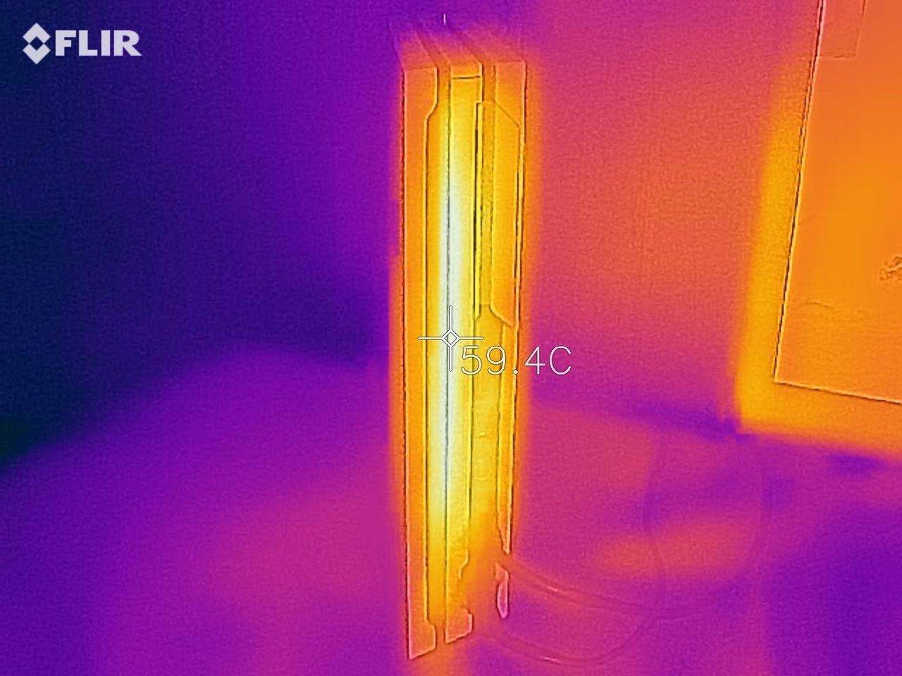

The PS4 Pro gets very hot in two areas in particular. The exhaust vents are all on the rear, so as you'd expect that's where things are hottest. On the top of the console, however, there's a patch in one corner where the most intense heat lies. So don't put anything on top of it, maybe.
Numbers-wise around the back temperatures touch 60C (140F) in the specific area the heat escapes. That's pretty warm and you'll want to make sure there's ventilation if the console is inside an entertainment unit.
The top and the bottom of the console aren't as warm, approaching 44C (111F) at its hottest point on the bottom and 51C (124F) on the top.
