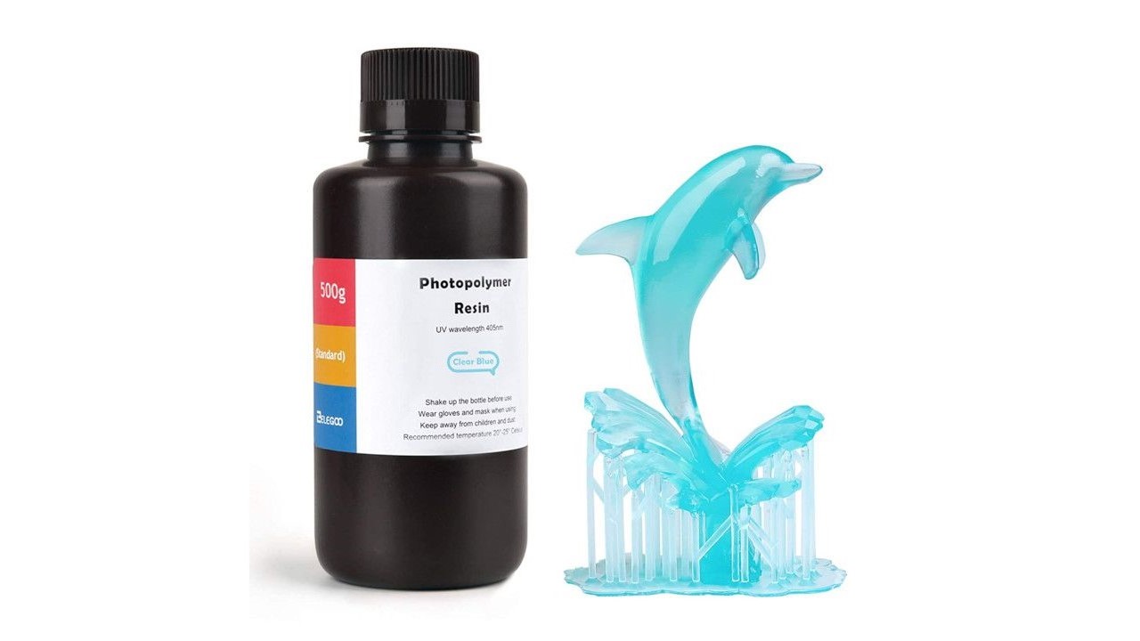

Elegoo ABS-Like Resin
Reasons to buy
Reasons to avoid
Elegoo's ABS-Like resin is an excellent mix of properties, not as stiff and brittle as others, with a wide range of colors, including this fetching translucent Cyan. Whether it be for D&D miniatures, cosplay props, or some masters for silicone molds, this is a tremendous all-around resin.
This general-purpose resin from Elegoo is perfect for those who want to try different printing applications instead of drilling down into something specific. Its decent tolerance to heat and seemingly magical ability to bring out details even when it's overexposed gives you a chance to experiment without every print failing spectacularly.
Unless you have a particular use case for your resin — metal casting, for example — then the general-purpose resin is an excellent choice for all your needs.
