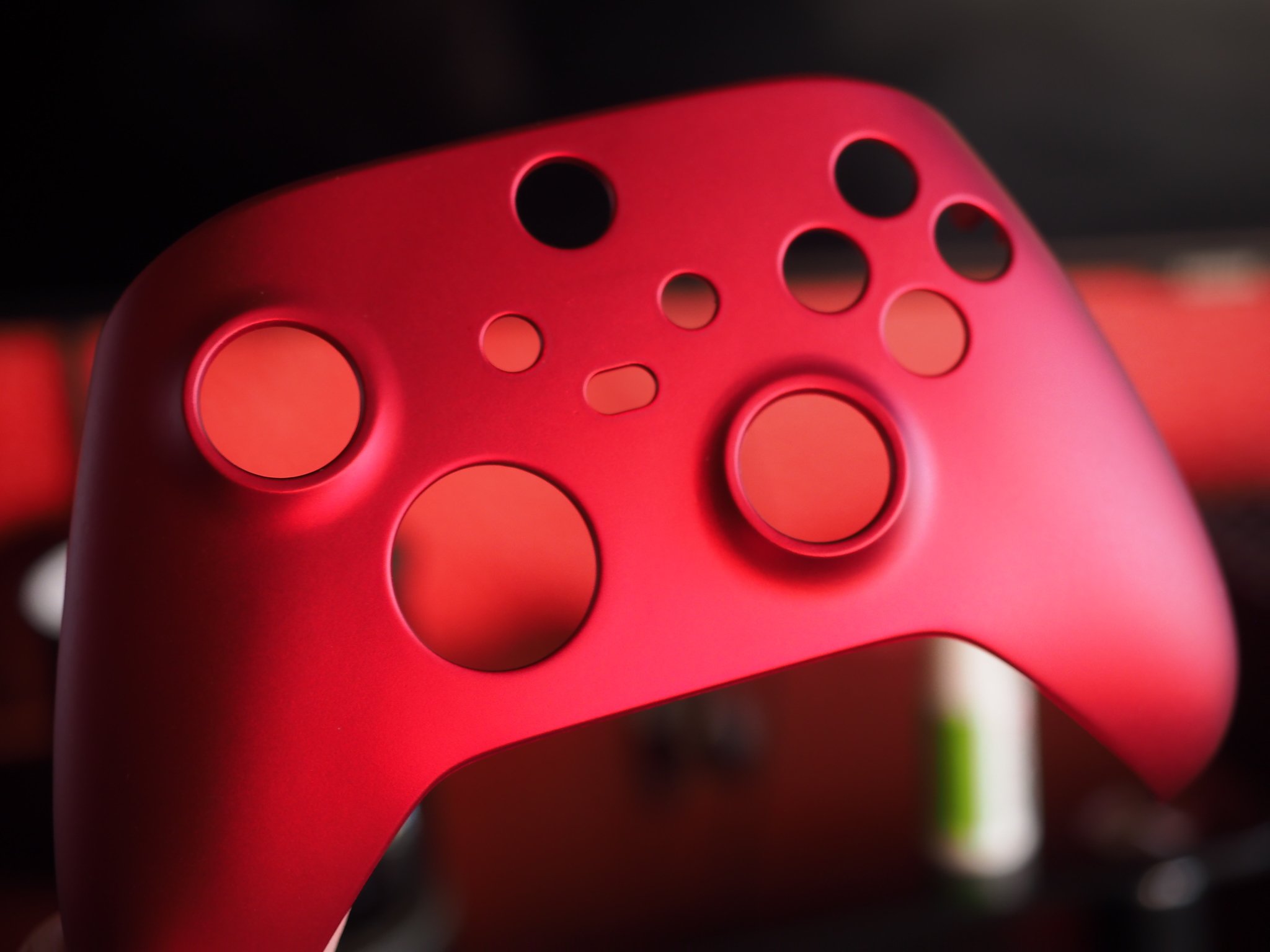

In the box, you're given three shell parts, some replacement screws, a pry tool, and a T5 security screwdriver. There are no instructions in the box, but there's a card with a YouTube link if you're unfamiliar with taking apart Xbox controllers. You can also take a look at our own guide over here: how to take apart an Xbox controller.
Set up is relatively easy, but does require a bit of elbow grease and time. The grips are the first parts you'll need to remove, and they're held in place by a row of teeth-like connectors that have to be prized up, using the pry tool. Sliding the thin part between the seams and then levering up can feel risky, but it's unlikely you'll break the plastic itself. In fact, I found that the pry tool was a bit flimsy for this task, getting bent quite easily. You may need to apply a bit of force, but once some of the teeth come loose, the rest will follow.
Extremerate Controller Shell (Image credit: Windows Central)
Source: Windows Central
Once you have removed the grips, the next step is to remove the five T5 security screws in each corner. One is also hidden behind the sticker, inside the battery door.
With your controller now naked (ooh, lala) you need to be careful not to drop dust or other small objects into the controller, as it might hinder the action on the triggers or buttons. From here, it's a simple case of adding the new faceplate and then snapping the grips into place, applying force to the teeth and connectors so that they get properly housed. It can be a bit fiddly to get the screws back into their sockets, mind. The controller interior has grooves designed for you to rest the screw on, to help guide them into place. However, the magnets on the rumble motors inside the triggers can interfere with your screws if you're not careful.

Once set up, the ExtremeRate Xbox shell feels great in the hand. The one I got has soft-touch plastics, complete with an attractive shimmering color finish that looks great. The shape and fit of the pieces are absolutely perfect down to the micrometer, making it feel as though it could've come straight from Microsoft itself.
The modern versions have cutouts for the new Xbox share button and don't replace the textured grips on the back, so you still get the same modern Xbox controller experience. If you place and position all the parts correctly, you shouldn't have any issues whatsoever. I saw some comments online that said the ExtremeRate shell caused issues with buttons or parts, but in my experience taking apart and repairing controllers, this only happens if you allow one of the parts to shift inside, or get something stuck in the controller that shouldn't be there. After getting up, I went and played Overwatch and Little Nightmares without any problems.
