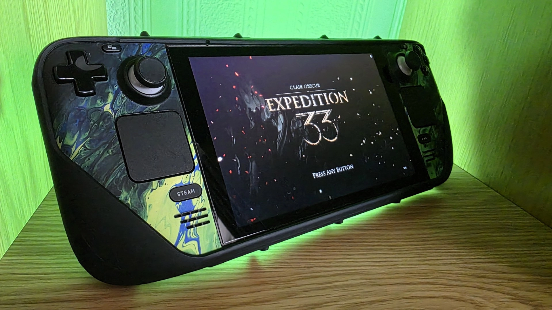

I've lost a Steam Deck to a broken screen before; this is not my first rodeo. Though I'll add, this second time was not actually my fault. This second Steam Deck has been treated like a newborn, kept in its KillSwitch case at all times, and I've even resisted the temptation to crack it open and install hall-effect sticks. It is untouched inside by human hands, and yet, inexplicably, it broke on me.
As simple as it sounds, my battery died playing copious amounts of Blue Prince one day, and after plugging the Deck back into charge, it would not switch on. Well, the haptic pads responded, and I heard the boot-up sound, but the screen remained black. Not even a backlight.
I plugged the Steam Deck into my external monitor to find it was indeed alive, in its own way, and it was just the screen on the Deck not working. But how? I hadn't abused it this time at all? I tried multiple fixes I found online via Reddit and YouTube, but nothing worked, including the 'battery drain' method so often touted as a fix-all for Steam Deck issues.
Having accepted my fate of probably having to pay for a repair, I reached out to Valve customer service. My Steam Deck is long out of warranty at this point, and I was willing to pay for them to fix it, but we went through some troubleshooting first, and my wallet is thankfully intact, as with Valve's help, I managed to get the Steam Deck screen back on and functioning.
