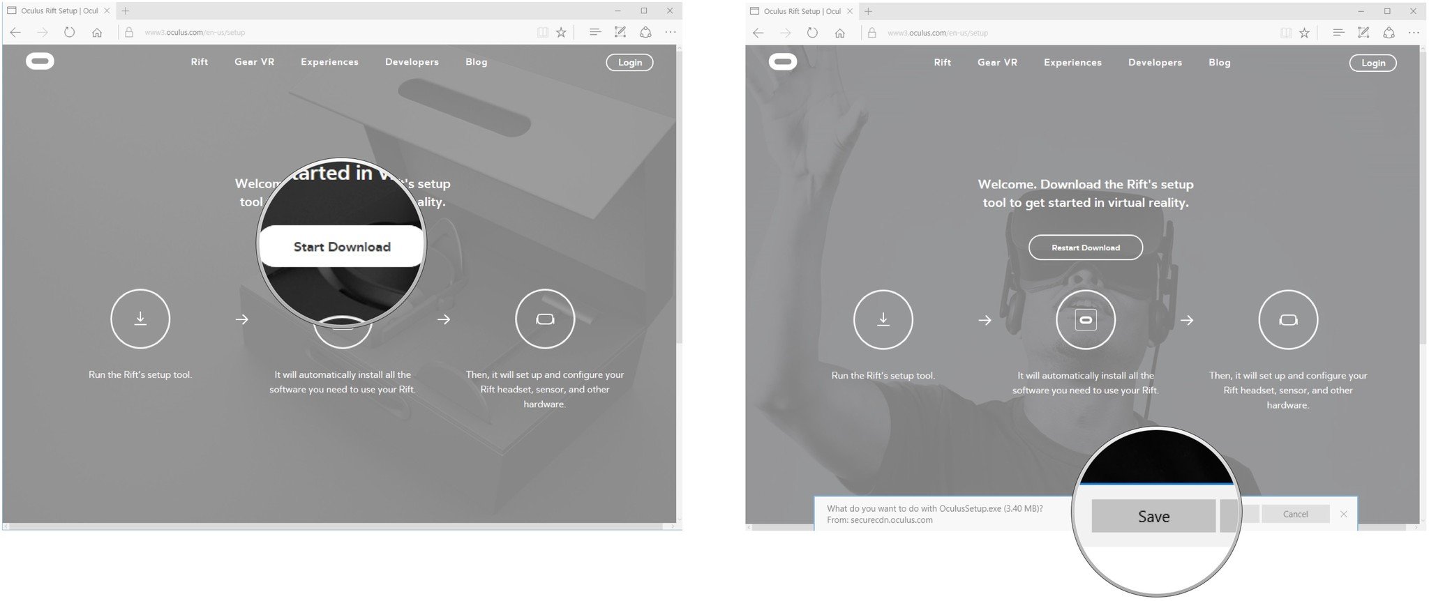

How to download and install the Oculus app
Before doing anything else, you need to download and install the Oculus app. There is an important process to follow so that you don't get stuck in a setup loop that requires you to actually have a Rift available — if you have an Oculus Rift, you don't have to worry as much.
- Navigate to the Oculus app download page.
- Click Start Download.
- Click Save.
- Click Run.
- Click Let's Go.
- Click Agree.
- Click I Understand.
- Click Next.
- Click Install Now. The required files will now be downloaded.
- Click Next.
- Click Rift.
- Click Next.
- Click Next.
- Click Skip Setup.
- Click Skip Setup.
