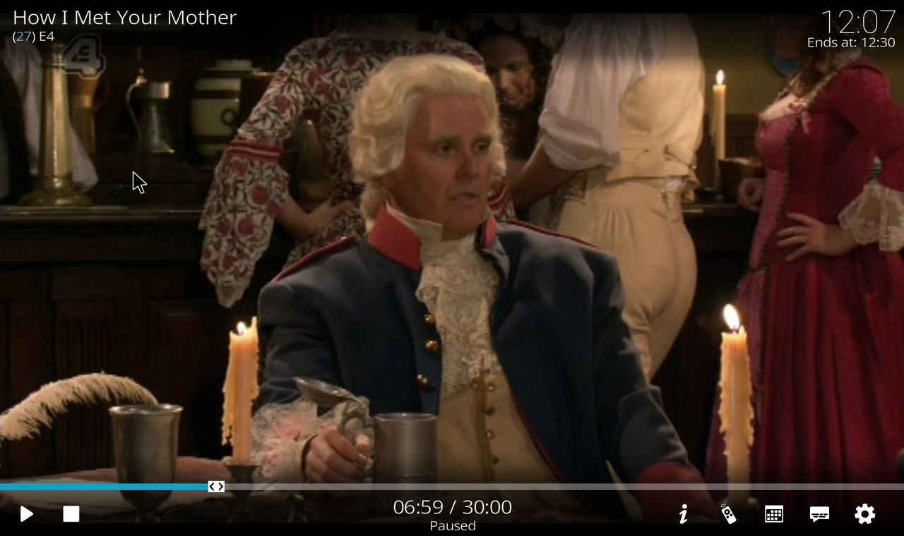

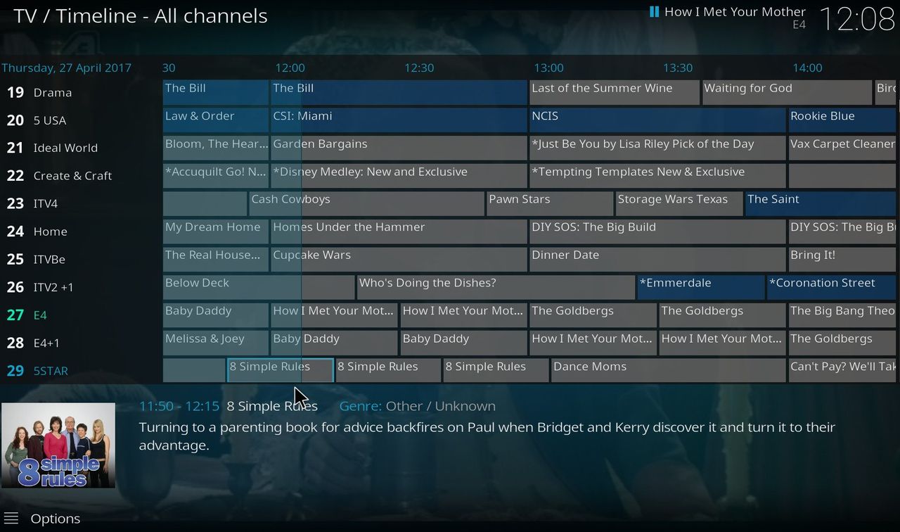

All of your channels have been pulled into Kodi's main interface, and it's pretty damn slick. When you first go into your TV section in Kodi, it'll pop up a list of channels on the left of the screen with currently playing shows. To see more channels you just scroll.
There's also a neat TV guide for viewing everything that's on now and upcoming across your entire channel list. And whenever you're watching something live, flicking out to the full guide or even just the upcoming guide for that channel never gets rid of what you're watching. It always fades into the background.
Kodi live TV
As you watch, recent channels and favorites will begin to populate within the TV section for quicker access. The beauty of this setup is that any device you install Kodi on can integrate live TV in just a few steps using your local network. There's no additional antenna required.
