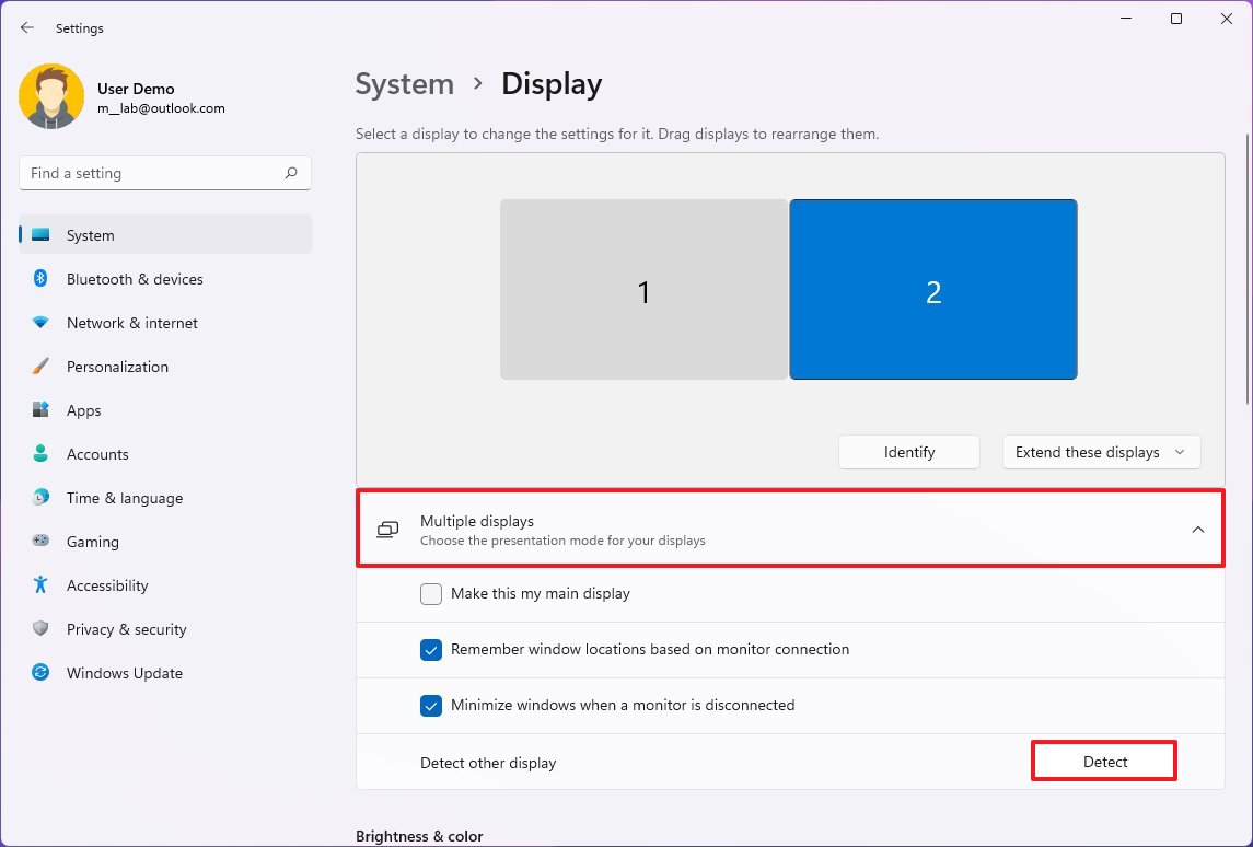

  1. Confirm all the monitors are on the settings page.
  2. Click the Multiple displays settings.
  3. (Optional) Click the Detect button to force the system to detect any missing displays.

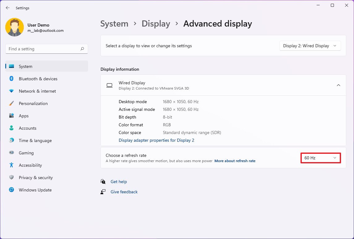

Change refresh rate
The default refresh rate (frames per second) of 59Hz or 60Hz is typically suitable for most users. However, if you have monitors that support a higher refresh rate or notice screen flickering, increasing the settings can provide a better and smoother viewing experience.
To set a different refresh rate on Windows 11, use these steps:
  1. Open Settings.
  2. Click on System.
  3. Click the Display page on the right side.
(Image credit: Future)
  1. Under the "Related settings" section, click the Advanced display setting.
  1. Select the monitor that you want to configure using the "Select a display to view or change its settings" option.
  2. Change the refresh rate with the "Choose a refresh rate" setting.
After you complete the steps, you may need to repeat the steps to adjust the refresh rate on the remaining display.

  1. Click the Multiple displays setting.
  2. Check the "Remember window locations based on monitor connection" option.
  1. Check the "Minimize windows when a monitor is disconnected" option.
When disconnecting the external monitor, all the apps will minimize in the Taskbar when using these settings. Then when you reconnect the display, all the apps will restore automatically to their original locations.

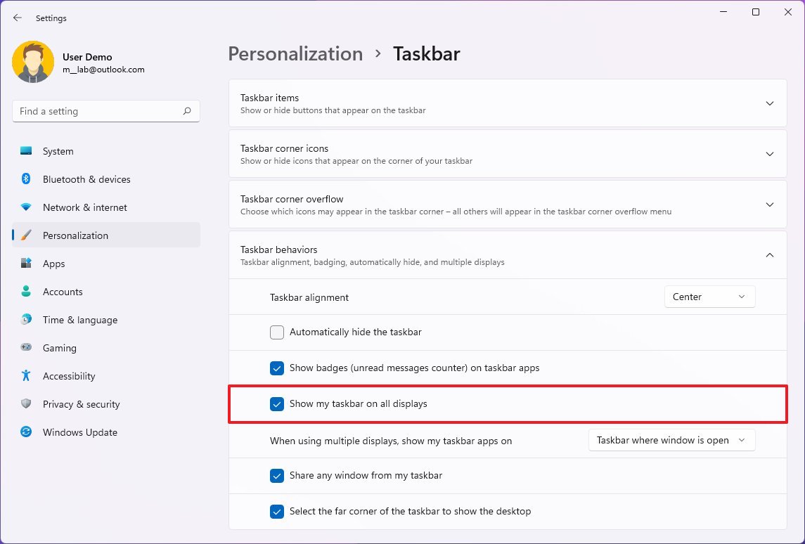

How to show Taskbar across multiple monitors on Windows 11
To show the Taskbar across displays, use these steps:
  1. Open Settings.
  2. Click on Personalization.
  3. Click the Taskbar page on the right side.
  1. Click the Taskbar behaviors setting.
  2. Check the "Show my taskbar on all displays" option.
  1. (Optional) Use the "When using multiple displays, show my taskbar apps" setting and choose how apps will appear in the Taskbar:
  • All taskbars.
  • Main taskbar and taskbar when window is open.
  • Taskbar where window is open.
After you complete the steps, the Taskbar will appear across all monitors.
Usually, a refresh rate (frames per second) of 59Hz or 60Hz is more than enough to operate a computer, though you'll want to look at the best monitors for Xbox Series X and Series S if you plan to game at higher framerates. However, if you're noticing screen flickering or if you have monitors that support a higher refresh rate, bumping the settings can provide a better and smoother viewing experience — especially for gamers.
To adjust the refresh rate of a monitor, use these steps:
  1. Open Settings.
  2. Click on System.
  3. Click on Display.
  4. Click the "Advanced display settings" option.
(Image credit: Mauro Huculak)
  1. Use the drop-down menu to set the correct refresh rate under the "Refresh Rate" section.
After you complete the steps, you may need to repeat them to change the refresh rate on the remaining monitors.
