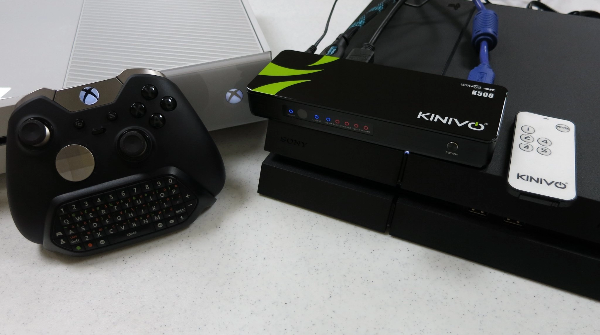

The K500 measures 7 x 2-5/8 x 7/8 inches. Its body consists entirely of black aluminum, with a high gloss finish on top and bottom and a brushed metallic finish on the sides.
The plus side to the aluminum construction is it helps combat overheating, a common problem among HDMI switches. The K500 is cold to the touch when not in use, and should not overheat during regular use.
On the downside, the glossy top and bottom show fingerprints and dirt very easily. The shiny surface looks great when clean, but you're bound to get it dirty whenever you add or remove a cable.
On the K500's front panel, you'll find a power light, an IR sensor for the remote, an output light, and individual lights for each of the five inputs. Off to the right all by its lonesome lives a manual switch button that toggles between the inputs.
The backside of the K500 offers a single HDMI output jack, 5 HDMI inputs, and a 5V jack for the power supply. Although some HDMI switches draw electricity solely from connected HDMI devices, the K500 requires the included power supply to function. That actually provides the best compatibility, as I've experienced issues with some devices like the PlayStation 4 not providing enough power for other HDMI switches to detect them.

K500 users have two options for manually switching devices: the front-panel Switch button or the included remote.
The button simply toggles between the five inputs in ascending order. This includes toggling over to inputs that don't actually have anything connected to them. So if you're only using three devices, pressing the Switch button while on the third device would switch to the unused fourth input rather than jumping straight to the first connected input. Bit annoying, but not a huge deal.
The tiny included remote proves more convenient. It has a dedicated button for each input, so you can jump straight to whichever device you want. The remote also packs a power button, the only way to turn the K500 off without unplugging it.
