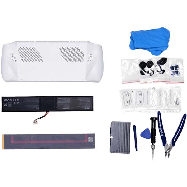

This kit gives you a new backplate for the handheld, a 65W battery, a pair of blue non-static gloves, replacement screws, joystick thumb grips, adhesive bumper stickers, a screwdriver, a flush cutter tool, a prying pick, a prying bar, and a metal thermal plate with adhesive on one side.
The important thing to know here is that this kit gives you everything you need to make the upgrade, aside from a clean surface to work on.

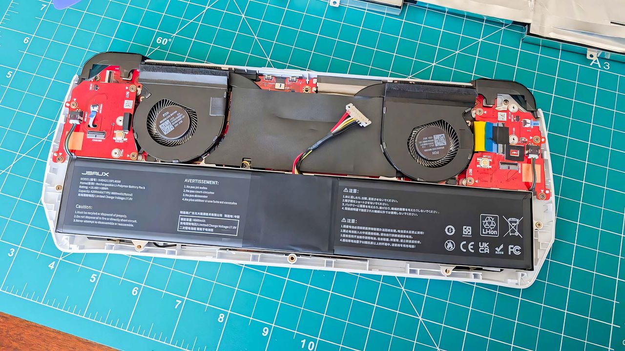

When I first opened the box, I was surprised to find that there weren't any instructions, but a JSAUX representative pointed me to a page on the JSAUX website that offers step-by-step illustrated instructions as well as a video tutorial.
I've embedded that video above.
If you're interested, you can check out my separate guide, filled with tips on upgrading the ROG Ally battery.

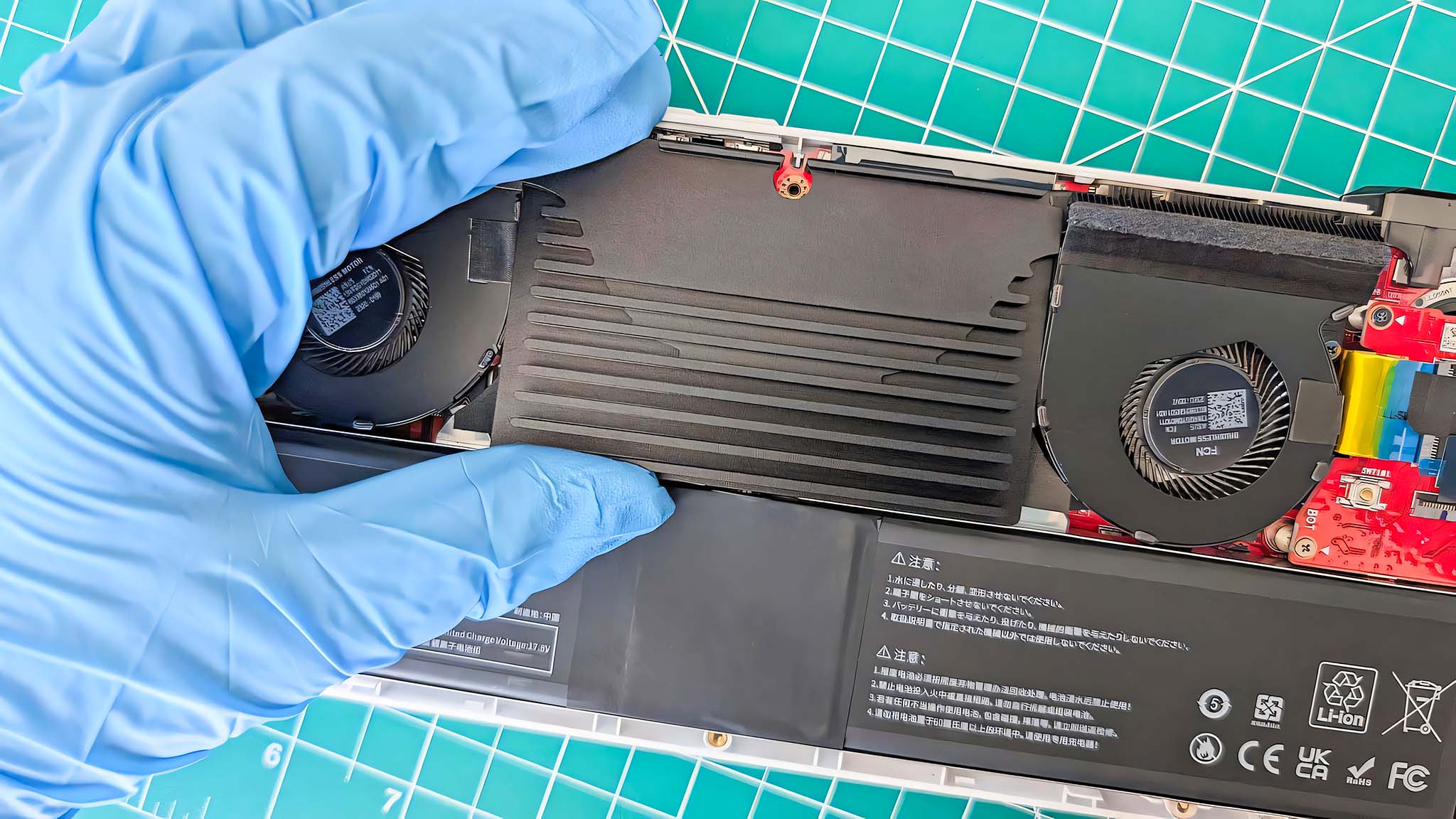

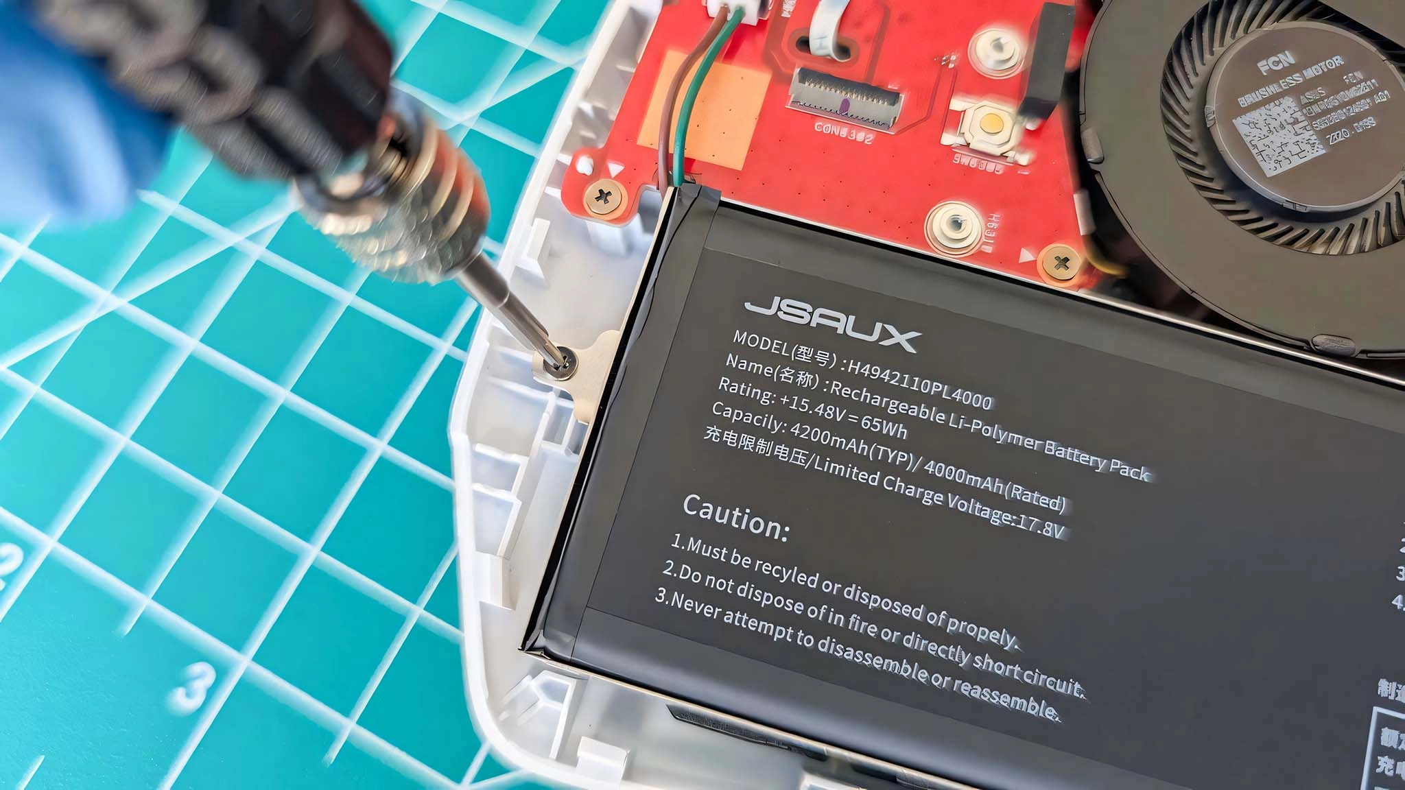

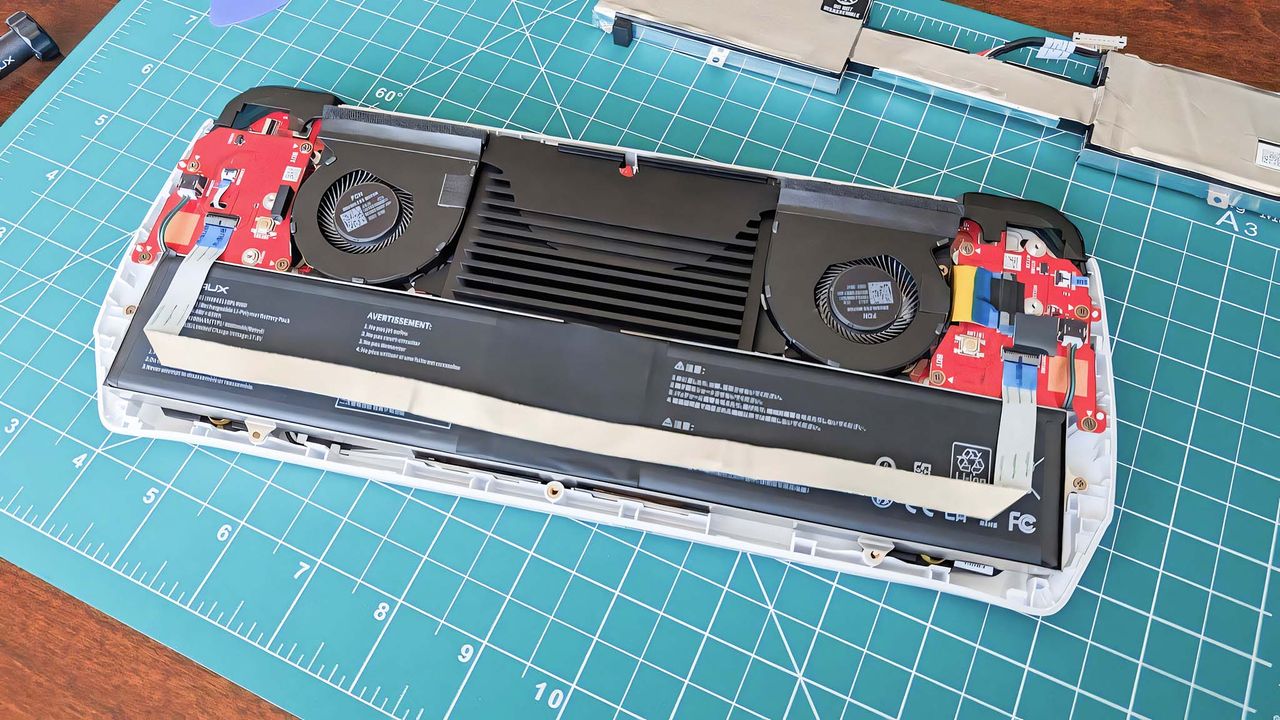

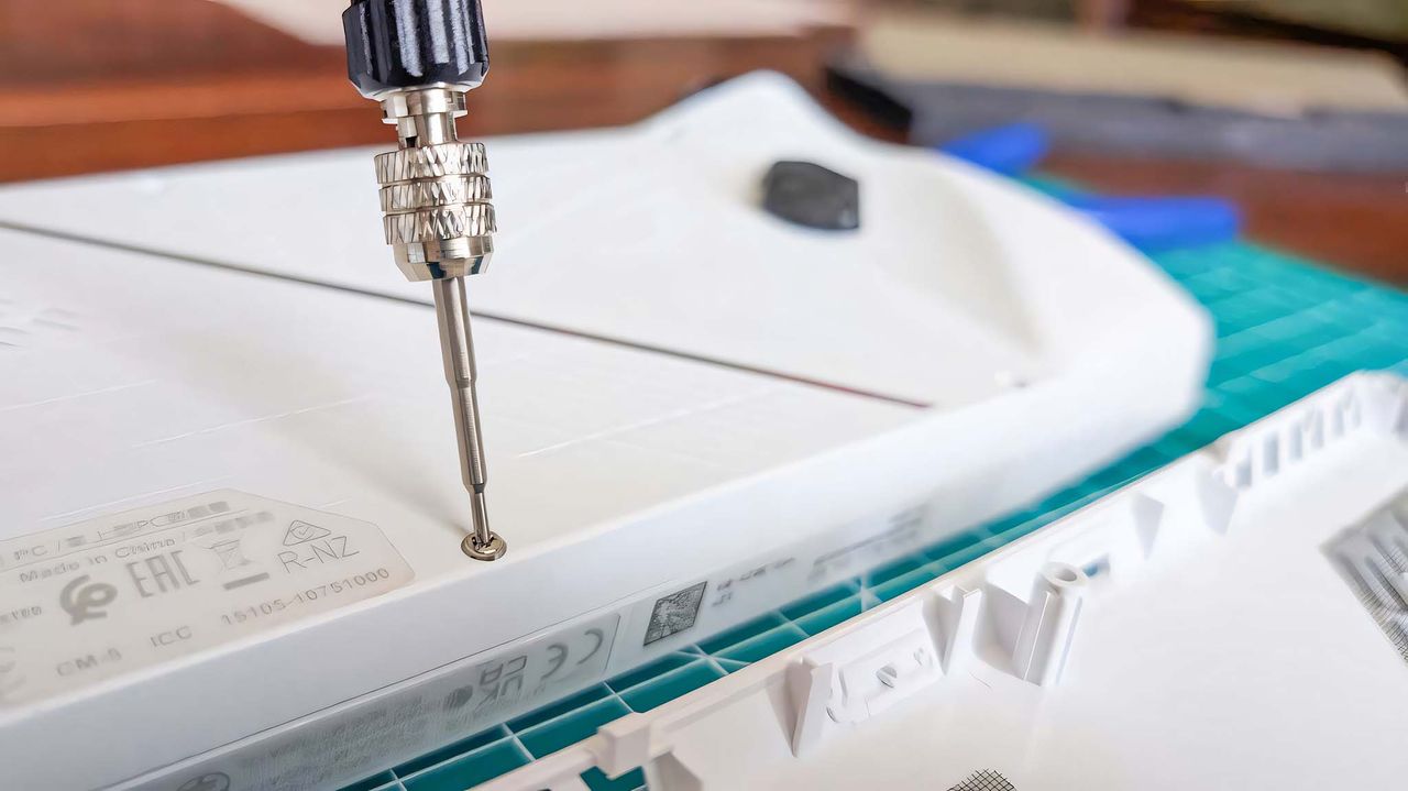

In a nutshell, the process for updating ROG Ally battery life with this JSAUX kit involves opening your handheld, moving the back buttons and triggers to the new back plate, detaching a ribbon from the motherboard, removing the original battery, pulling off some foam padding, cutting the plastic case to make room for the larger battery, putting the new battery in place, adding a thermal dissipation plate, reattaching the ribbon, and finally closing the casing.
I'm not an electrical engineer or someone who feels super confident with motherboards, but even so, between using the included tools, looking at the written instructions, and following the video, I was easily able to swap out my ROG Ally battery relatively quickly.

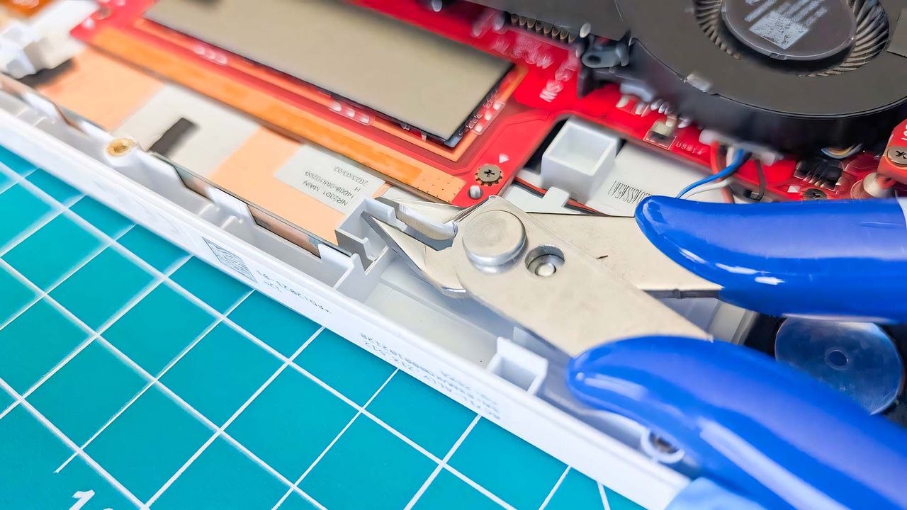

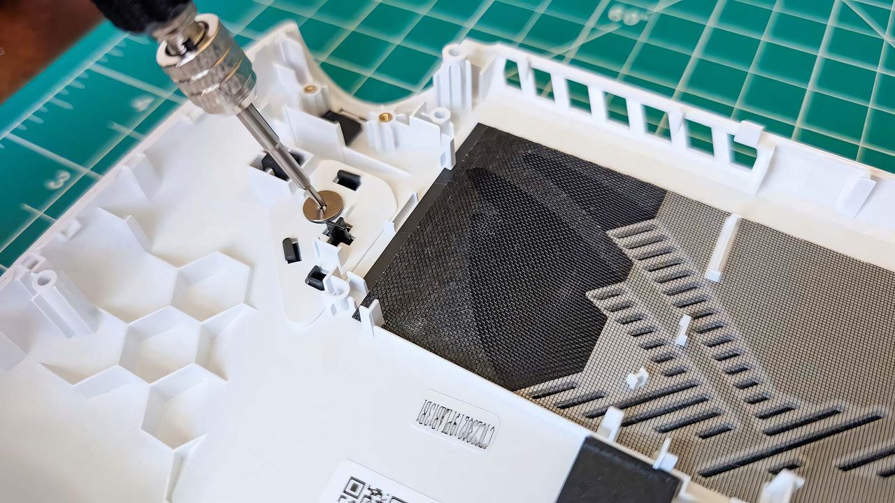

First off, as I've previously mentioned, I had to cut some of the inner plastic on my ROG Ally casing to make way for the larger battery.
I'm sure some people won't feel comfortable making these permanent changes, and that's valid, considering that performing this upgrade will void any active ROG Ally warranty you might have.
Still, I will say JSAUX made the process easy by providing a very sharp flush cutting tool that made it feel like I was cutting paper instead of plastic — I was able to make very clean cuts without any jagged edges.

The new ROG Ally back casing doesn't have any texture and feels too smooth for a good grip. (Image credit: Rebecca Spear / Windows Central)
Third, while the original back casing has textured grip areas, JSAUX's replacement backing has smooth grip areas.
I personally don't like how slippery the ROG Ally feels with this new casing in place. I could potentially fix this with textured stickers or an ROG Ally grip accessory, but only if I find one that fits.
Finally, the replacement back casing JSAUX provides is about 1mm thicker than the original back casing in order for it to fit the new battery.
This doesn't look like a huge difference and doesn't make the Ally that much thicker, either.
However, some form-fitting ROG Ally protective cases, like the dBrand Killswitch, might not fit on your Ally after making this upgrade. So you'll want to take that into consideration.
