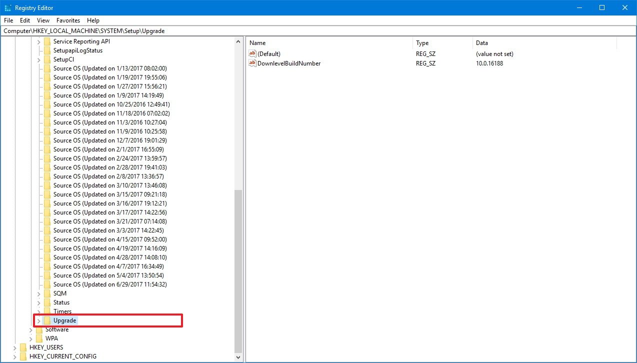

HKEY_LOCAL_MACHINE\SYSTEM\SetupQuick Tip: If you're running the Windows 10 Creators Update, you can copy and paste the path in the address bar to jump directly to the location.

Does your PC have a clean or upgrade installation of Windows 10?
Inside Setup, you'll find a number of keys (folders). If you see the Upgrade key, then your installation is an upgrade. This key could have been created during an upgrade process from an earlier version like Windows 8.1 or Windows 7, or during a feature update for Windows 10.
Otherwise, if the Upgrade key doesn't exist, then you're running a clean installation of Windows 10.

If your installation is an upgrade, you can figure out which was the original version installed on your device, or at least the oldest upgrade since the last clean installation.
Alongside the Upgrade key, you'll also notice one or multiple Source OS keys, which correspond to each upgrade your device went through. You can navigate each key to determine the version (e.g., Windows 10, Windows 8.1, and Windows 7) you upgraded from by looking into the ProductName String.
You can also determine each feature update that was applied to Windows 10 by looking into the ReleaseId String. For example, if you're running the Creators Update, one of the Source OS keys should include a String with the 1703 value. In addition, you may be able to find a key if referencing 1607 if at one point you installed the Anniversary Update, and 1511 for the November Update.
When exactly an upgrade was applied to your PC?
You probably noticed that each Source OS key has also a timestamp, this indicates exactly when the installation took place.

In the Setup key, you can quickly determine the times a Windows 10 Insider Preview was installed on your device. In addition, inside each Source OS key, you can check other pieces of information, such as the full name of the build, build number, and version by looking at the BuildLab, CurrentBuildNumber, and ReleaseId Strings.
While you can quickly determine the current version you're running by comparing the timestamp in the keys, the version you're currently running will also be listed inside Upgrade.
