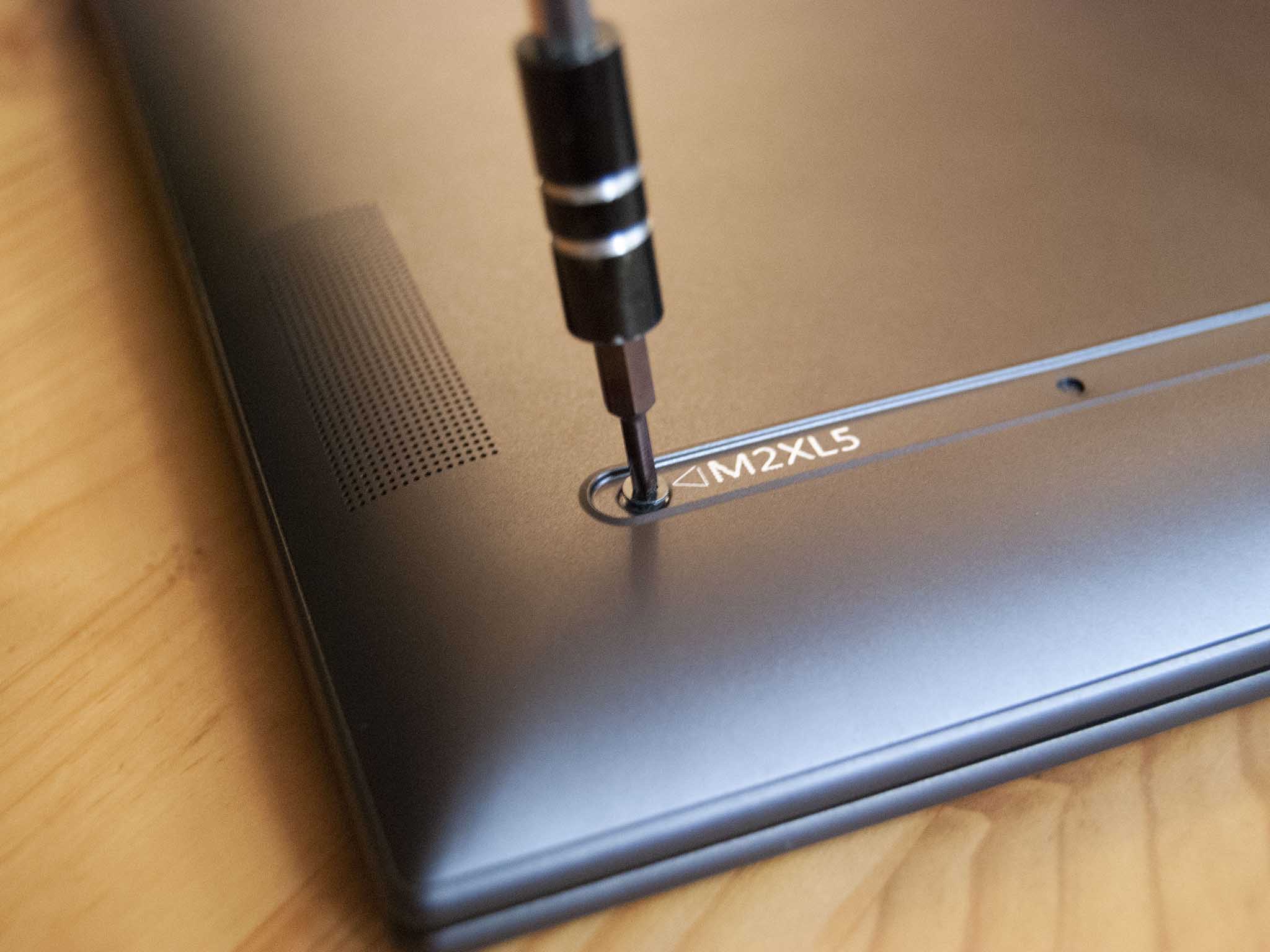

  1. Unscrew the two visible fasteners on the bottom of the laptop using a T5 screwdriver.
