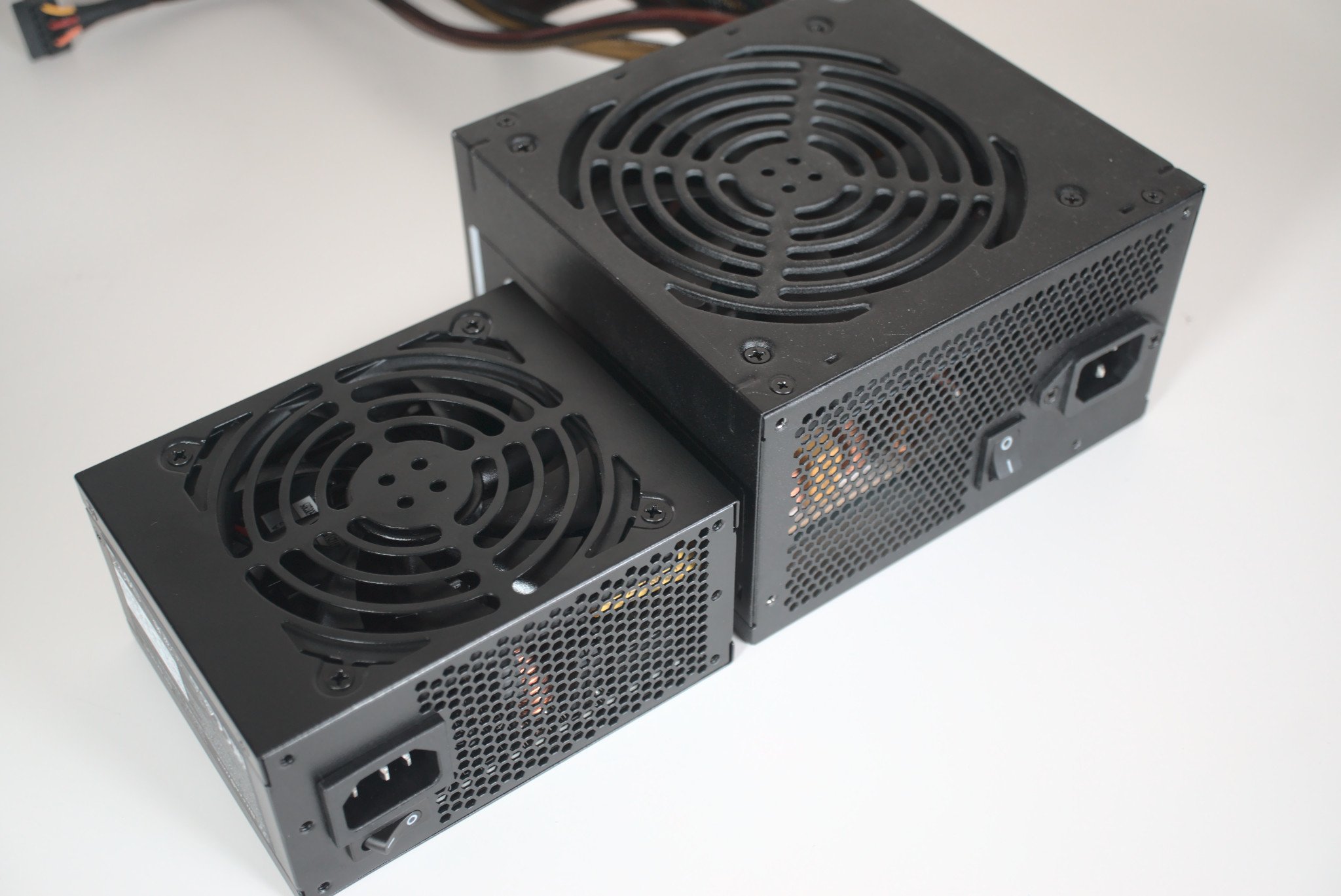

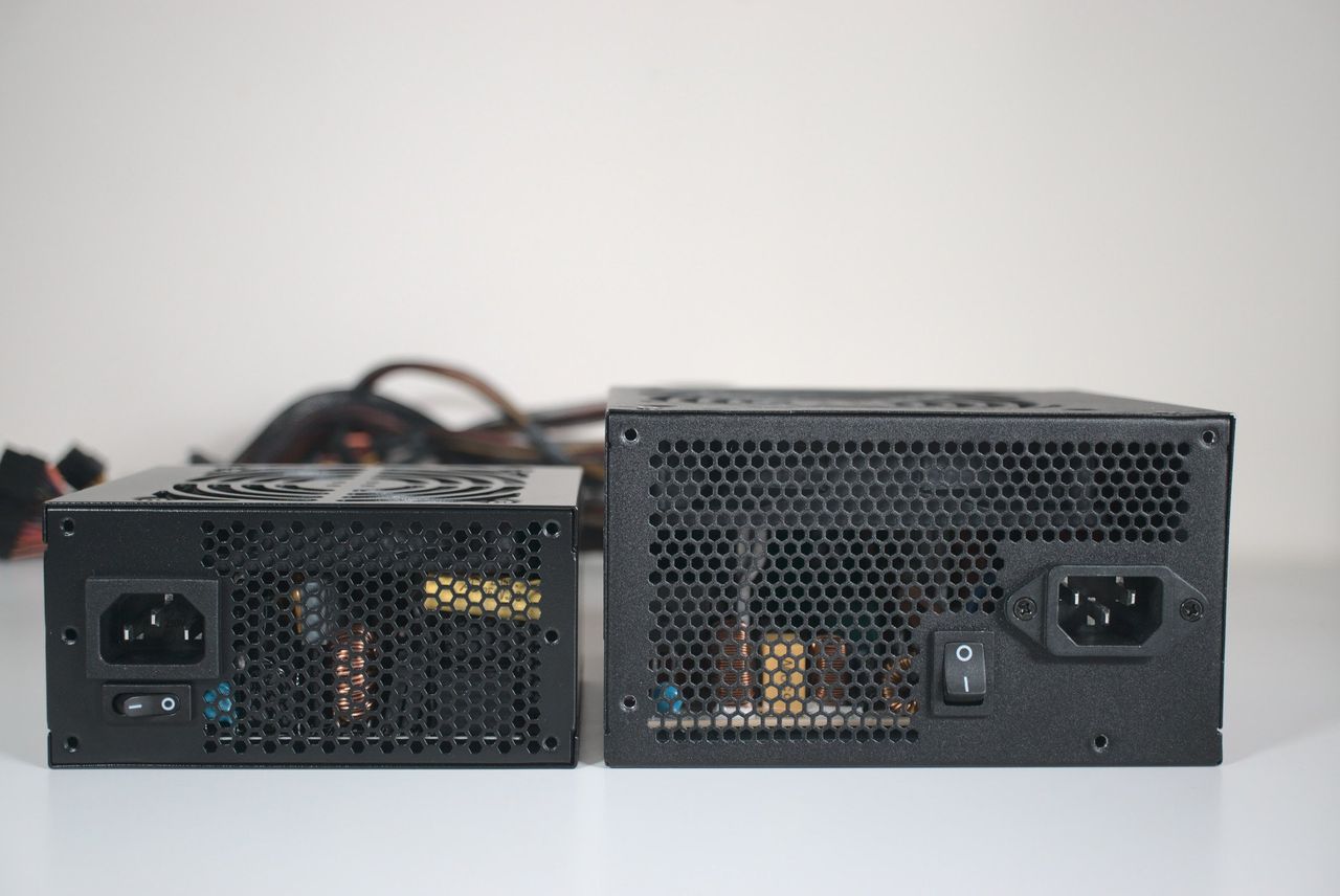

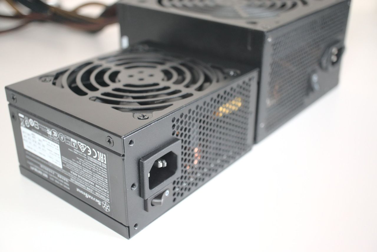

SilverStone has the SX series of PSUs that are 80 Plus Gold rated, but now the company launched a more efficient series with the SX700-PT. This unit that we received for review has a single 12V rail that's rated to handle up to 58A of power draw. There's plenty of tech packed inside this small and sleek-looking black metal box.
The SilverStone SX700-PT is a perfect addition to your compact PC build.
Measuring in at 125mm x 63.5mm x 100mm and adhering to SFX standard, you can easily cram the SX700-PT inside even the most compact PC cases. In terms of safety, which is incredibly important since this is what will be handling the conversion of electricity for all your PC parts, SilverStone implemented numerous guards.
