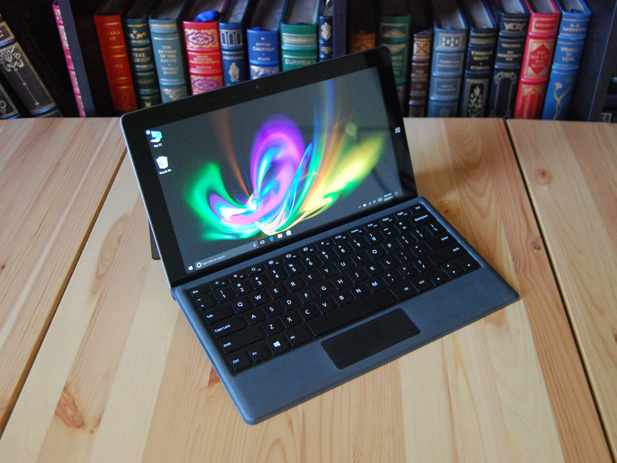

The design of the X3 Plus is immediately reminiscent of the Surface Pro. You have an 11-inch, 2-in-1 tablet that has a magnetically attachable keyboard and a kickstand on the back to keep it propped up while typing.

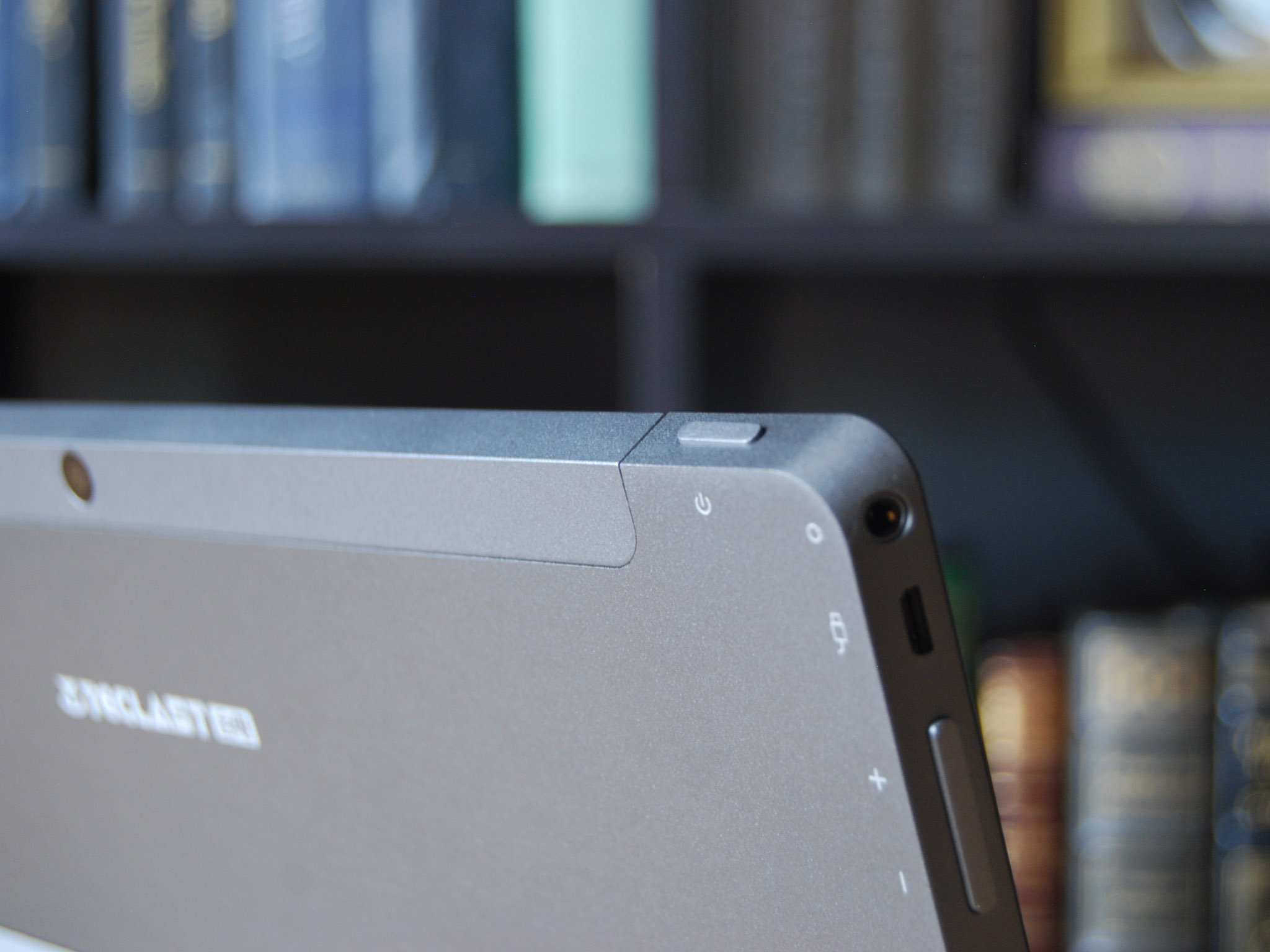

The overall build quality of the tablet is decent (we'll get into the keyboard later). The chassis is made from an aluminum-magnesium alloy, and, while quite thick (0.39 inches) for a tablet of this size, it is plenty sturdy.
The 5MP camera on the back of the tablet is a separate piece, and here you find one of the only places on the tablet where the seams don't sit flush.

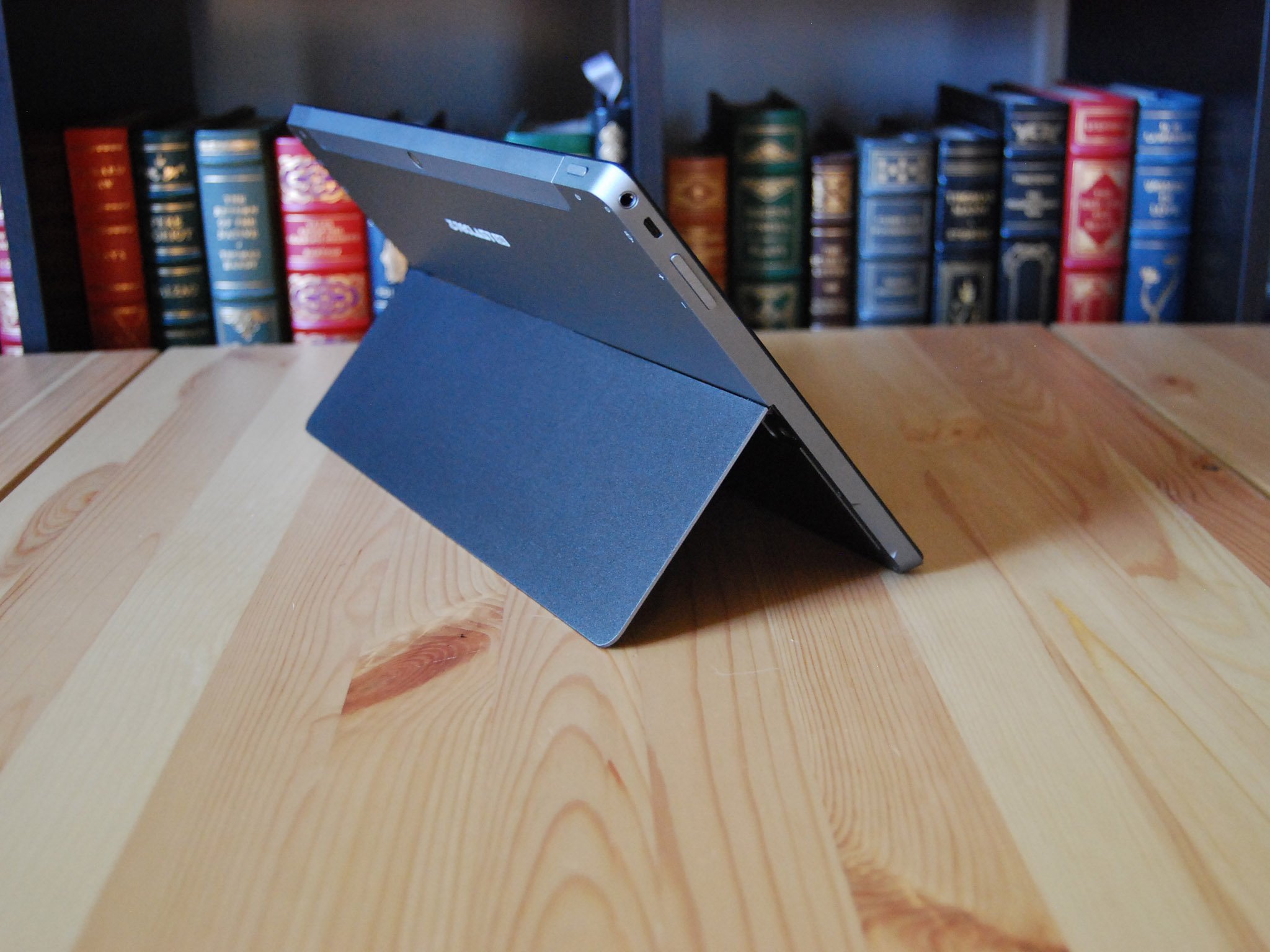

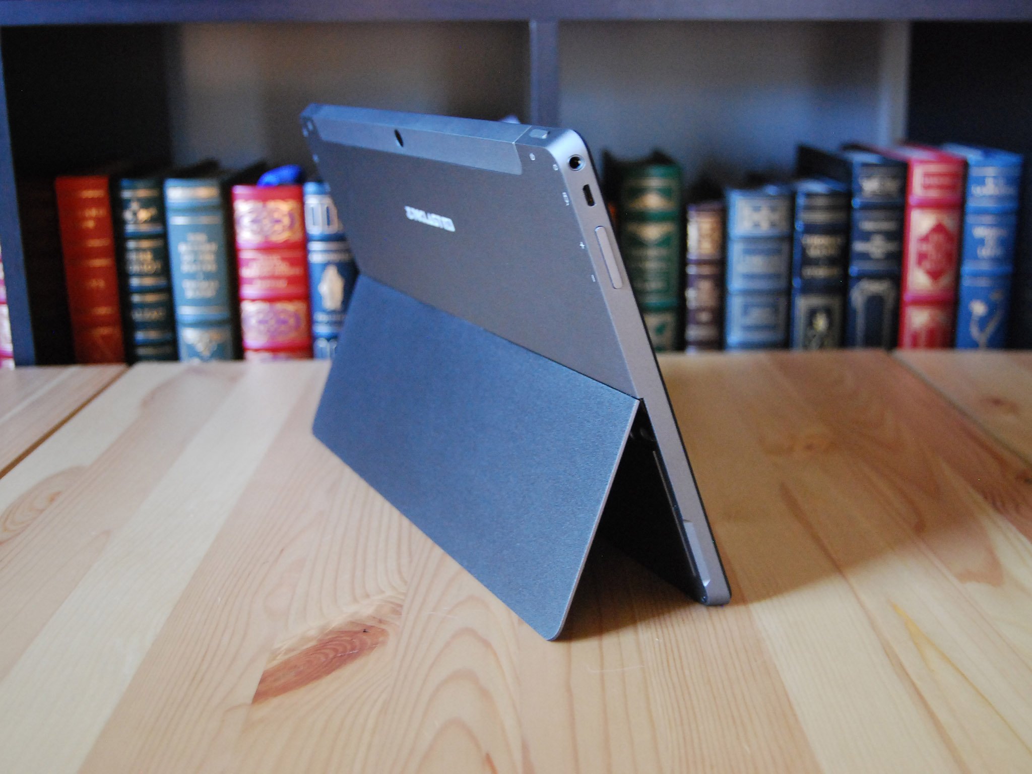

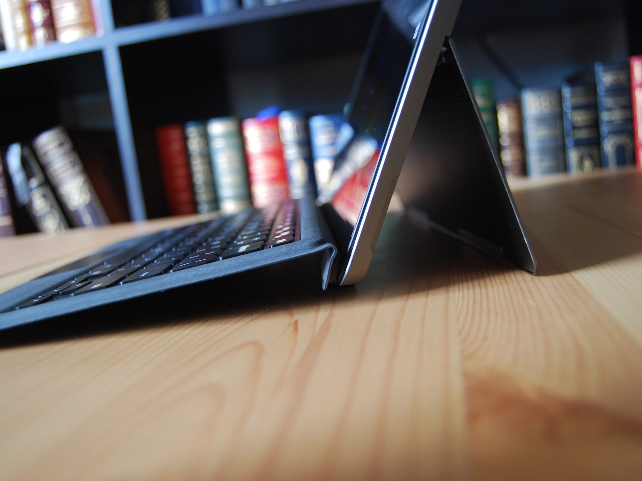

The kickstand on the back of the tablet, when closed, blends in nicely, leaving only the seam in the middle from which the hinge extends. Instead of being able to set the kickstand wherever you want, there are two set spots where it sort of clicks into place and stays — one at a 90-degree angle, and the other at a 45-degree angle from the back of the tablet. This isn't ideal, but it's designed as one angle for your lap and one for a table.
There are a decent amount of ports here — yet no USB-C — and they're spaced out enough to avoid congestion. On the left side you have Micro USB and a 3.5mm jack, and on the right side is Micro HDMI and USB-A 3.0. There is, thankfully, a physical volume button, as well as a physical power button. When using the tablet without a keyboard, the physical volume button is indispensible.

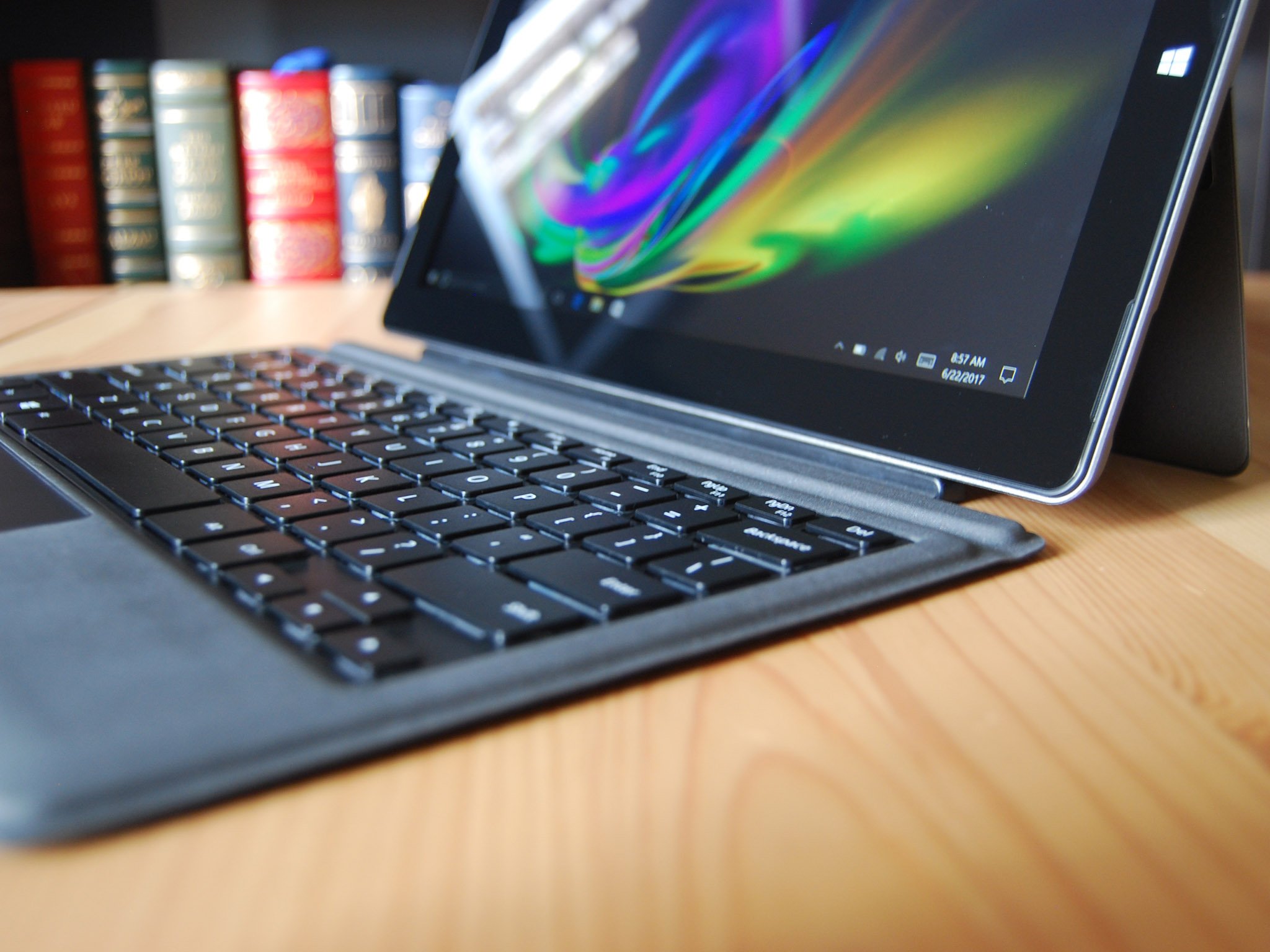

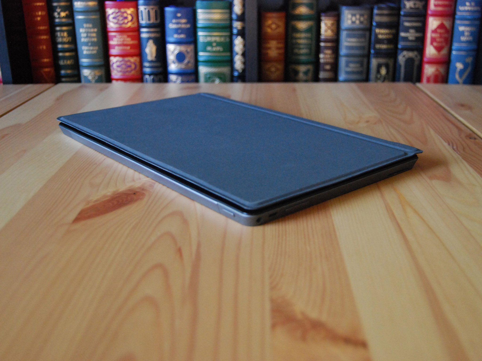

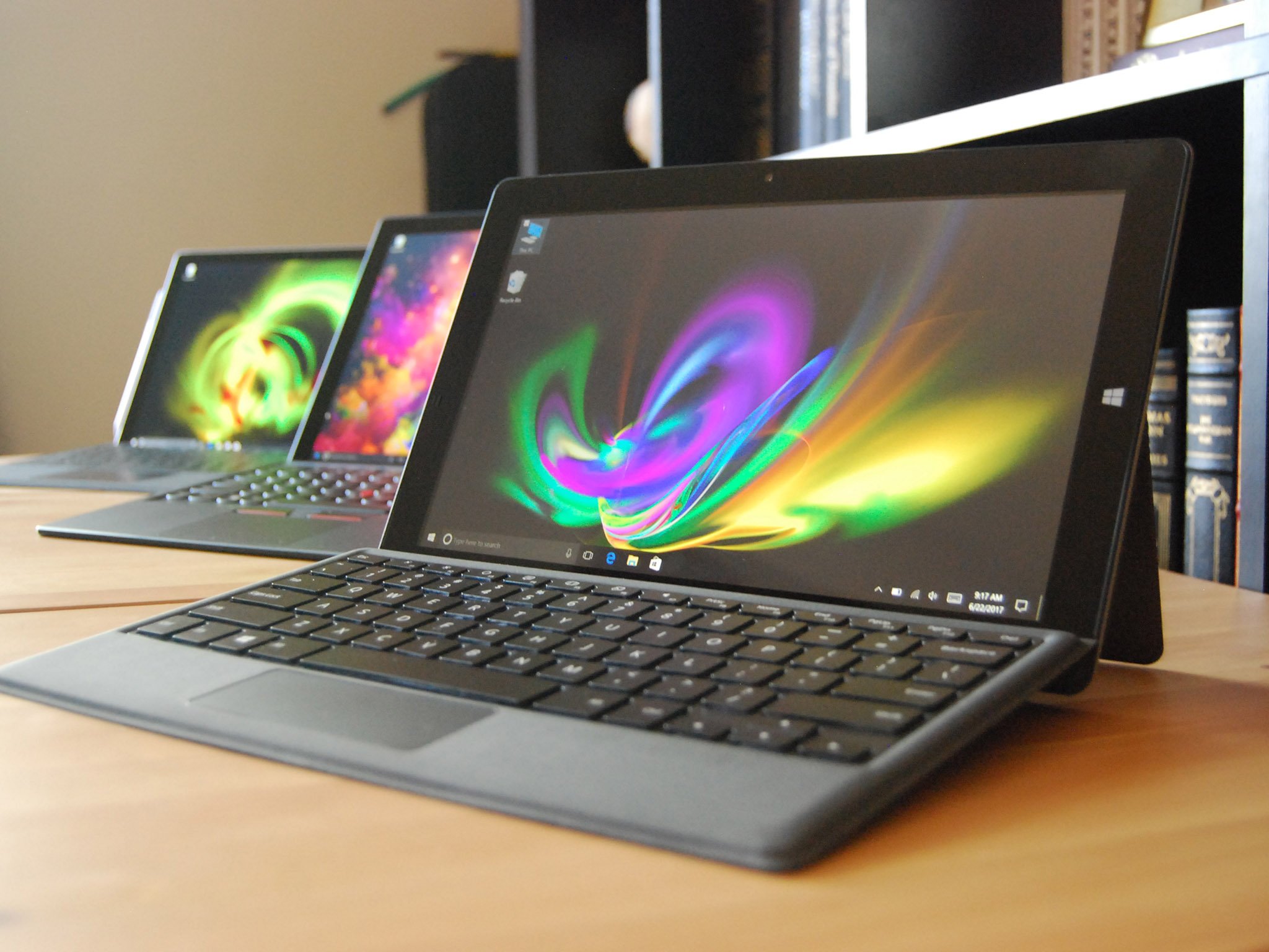

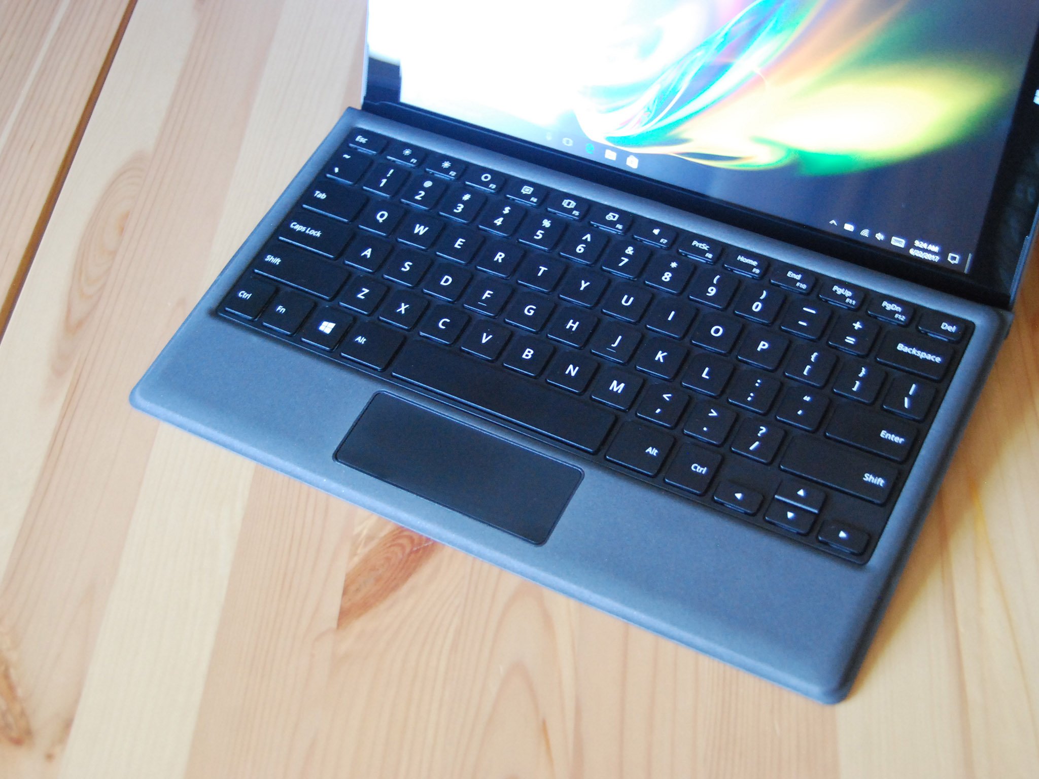

Like the Surface Pro, the X3 Plus has an optional keyboard (with touchpad) that attaches magnetically and can be folded up when not in use. The attachable keyboard is not included with the tablet; it costs an extra $50.
The material on the keyboard seems to be the same soft-touch stuff as Microsoft uses on its regular Type Covers (not Alcantara), and, when closed, it gives the tablet an appealing look.
The keyboard itself isn't bad. The keys are spaced well, there is ample travel, and a soft base means you won't feel keys bottom out when they hit the deck. There is no backlight, so working in the dark is tough.
It's a good thing the touch display works without a hitch, because I gave up on trying to use the touchpad after about 30 minutes. It's small — about 1.25 inches x 3.5 inches — and does a horrendous job of tracking. It would have been better if TECLAST had completely abandoned the touchpad and gone with a keyboard-only attachment that many iPad Pro users are used to. One other gripe is that folding the keyboard under the tablet and using it in conjunction with the kickstand isn't possible because the keys remain active; there's no sensor that tells it to stop taking input.
