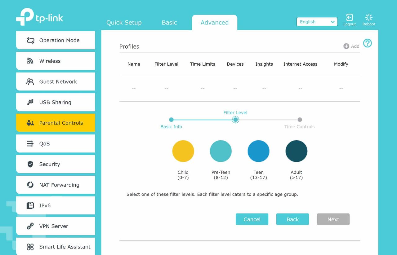

Parental control is handled per device. Find one in the connected devices list, give it a name, choose an age group, then add any categories you'd like to filter. Time limits per session and sleep times can be set to ensure the kids aren't staying up late when they should be resting. Once you've set up a control profile, you can look in on time spent online and what sites were visited for how long.

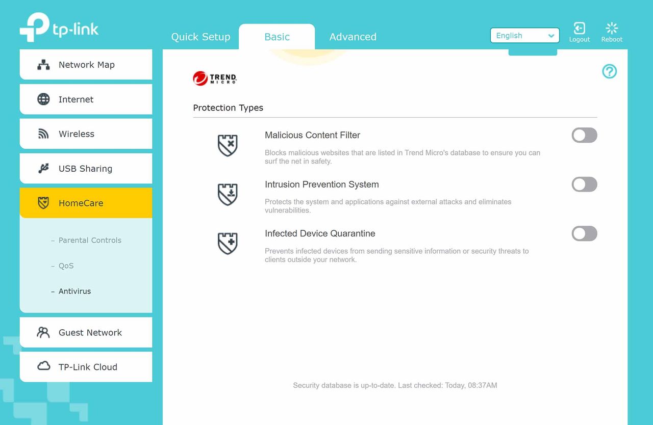

A built-in antivirus from Trend Micro can be toggled on to block malicious content, external attacks, and quarantined devices. The router also has an SPI firewall enabled by default, as well as a configurable blacklist for devices. Those looking to securely access their home network while away can configure a VPN through OpenVPN or PPTP.
