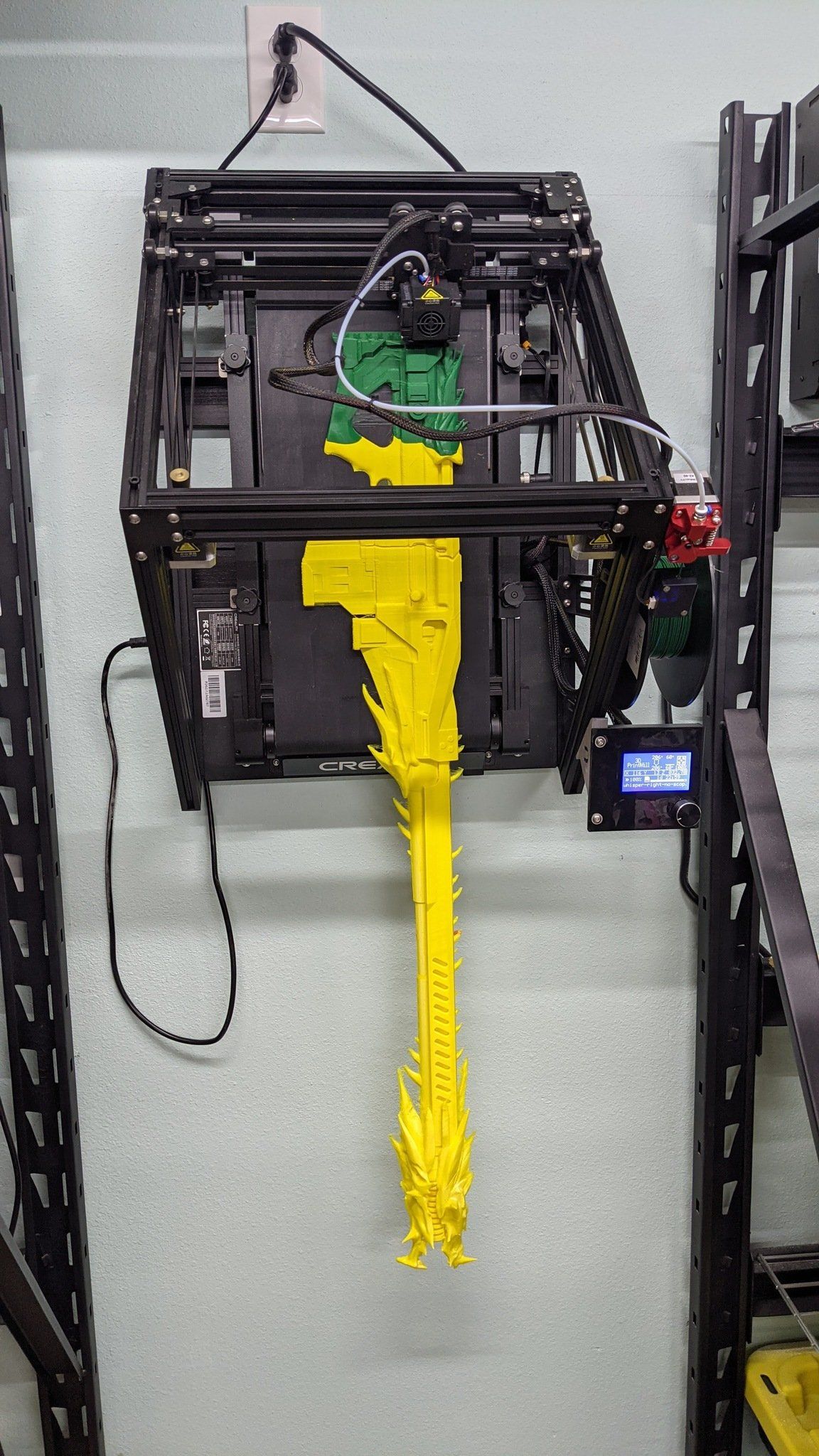

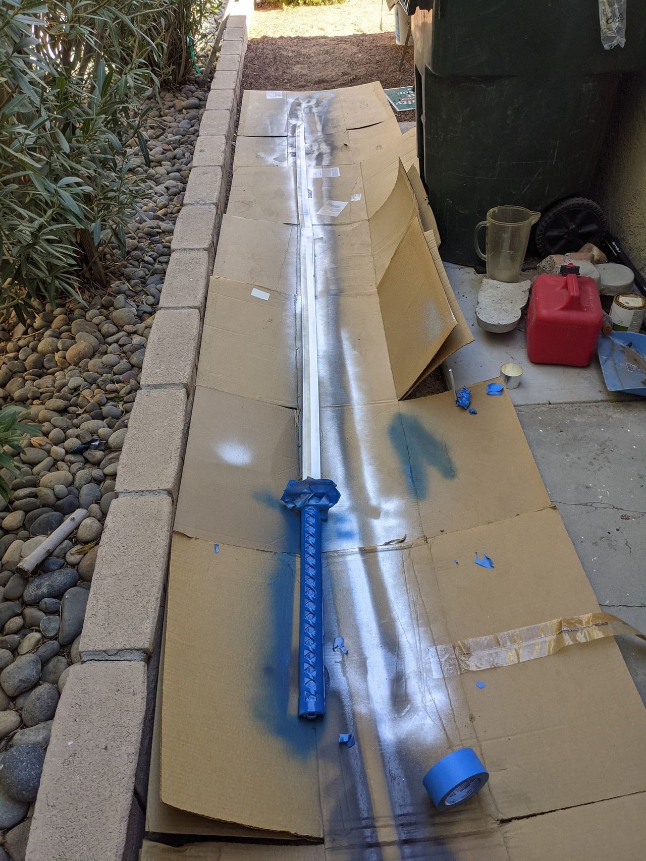

If you are anything like me, your first thought when you see the CR30 in action is how much fun it would be to print a sword, and it is, in a way that is difficult to describe. Because the printer is essentially a conveyor belt, there is no upper limit to how big you can make a model. The only limitation is the scale of the model's width. If you want to print something long, make sure it is thin too. I printed Sephiroth's Masamune from Final Fantasy VII, and it ended up being 11 feet long! Unlike smaller printers like the Prusa Mk3, where you would normally have to print a sword in multiple small sections, the CR30 lets you print two halves that can be easily attached together. This eliminates a lot the sanding and filling that would normally be required.

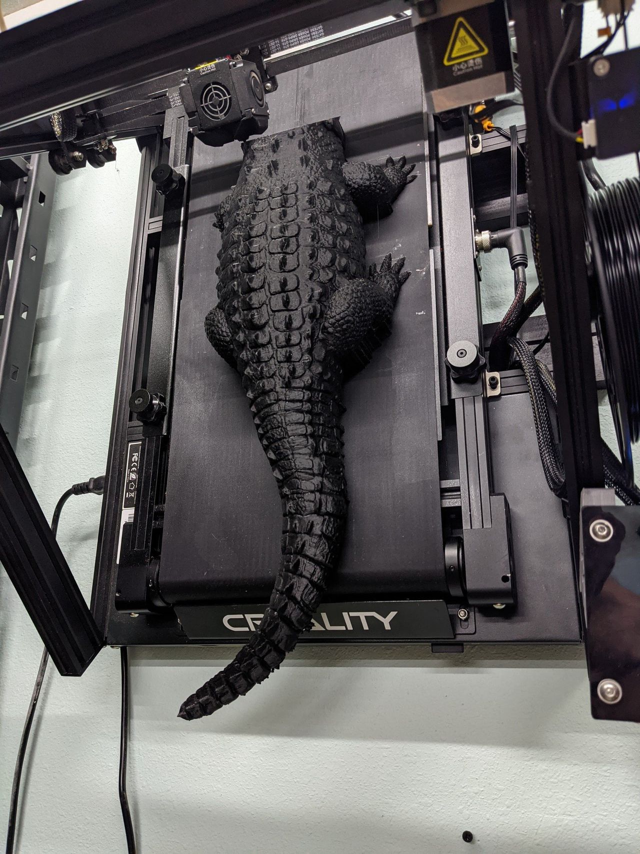

It's not just swords that can be printed either — though I have printed a lot of those — but just about any cosplay weapon you can think of can be printed with relative ease. Both the Masamune and the Whisper of the Worm from Destiny 2 were designed by Nikko Industries and modified to fit the CR30 buildplate, though I had to cut off the scope and magazine from the Whisper to get it to fit to scale. These prints take a lot of time, sometimes over 100 hours, but the end result is more than worth it. I even printed a 2-foot-long Alligator Loki, designed by Wekster and was blown away by how detailed its skin was.
