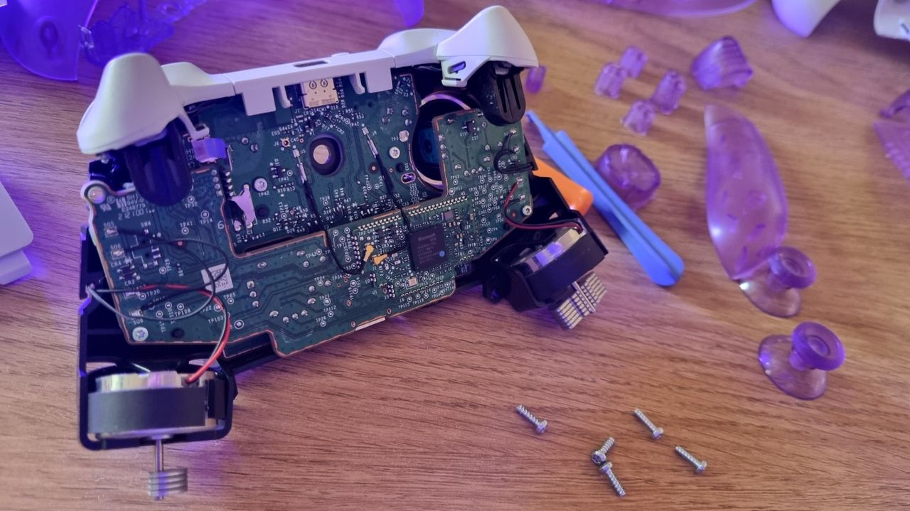

The most challenging part of the process was removing the rear grips with the prying tool. They were a tight fit and seemed integral to securely holding everything else in place. As a result, they were firmly attached and required a lot of force to pry them off. After spending some time removing the left one, I faced even more difficulty with the right one. I resorted to using a butter knife to really get under the lip of the plastic. Don’t worry, though. It was not as risky as it sounds. Eventually, it popped off with a satisfying click, and no damage was done.
The rest of the controller was much easier to take apart once this component was removed. The screws and wires were clearly visible and accessible. I followed the instructions carefully and used the tools provided to detach them.

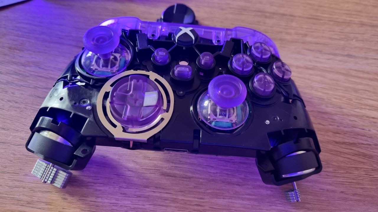

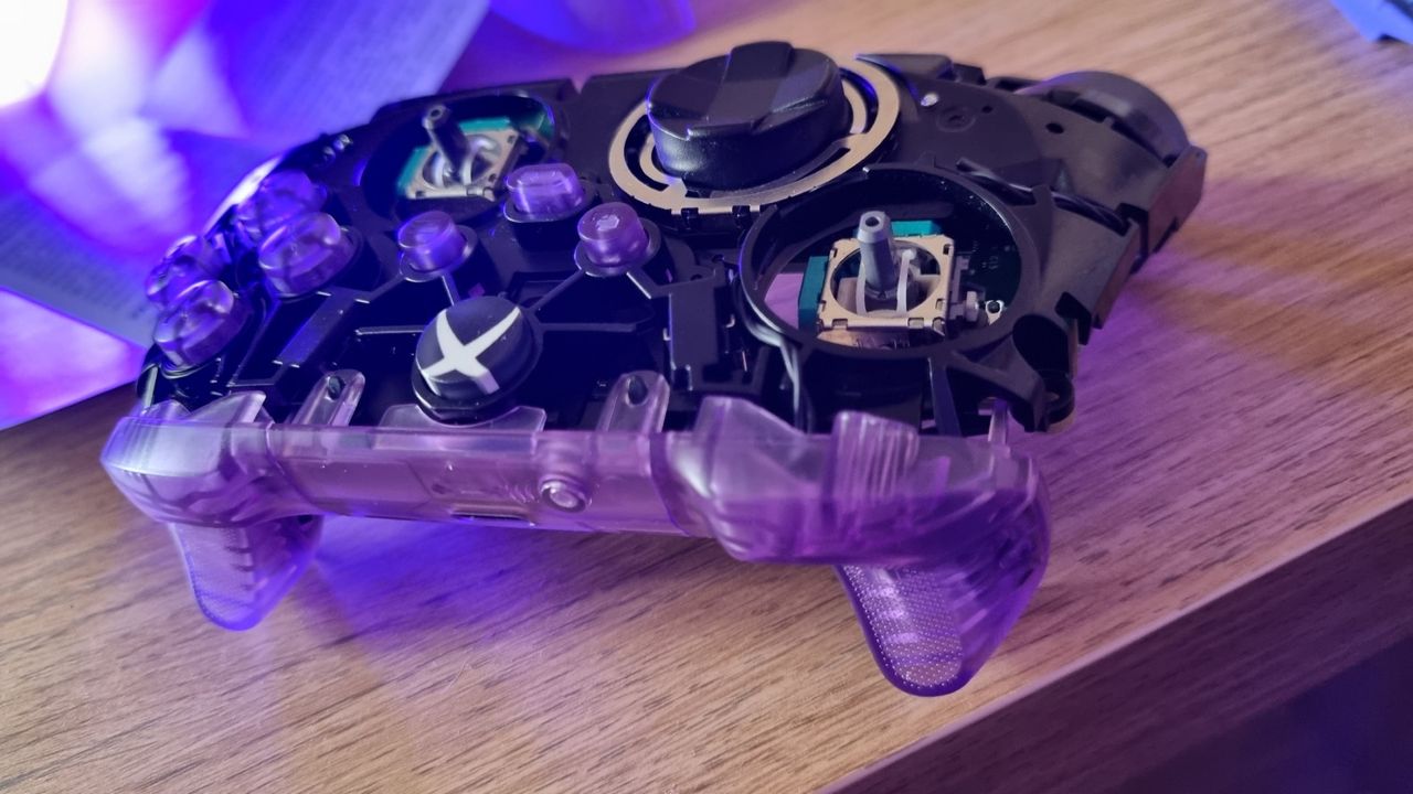

Most of the outer shell snaps off easily, but eventually you need to use the included screwdriver to further disassemble your controller. (Image credit: Jennifer Young - Windows Central)

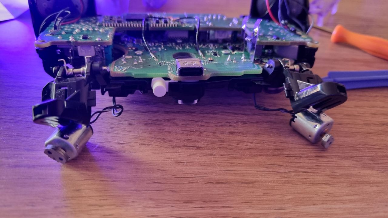

The next step in the process was to unscrew the components still attached to the controller. Thankfully, there were only two different screw sizes on an Xbox Series S|X controller, so I didn’t have to worry about mixing them up. I just kept them in two separate piles, and the Youtube video clearly explained which one went where.
After that, I was left with a rather terrifying-looking skeleton of my controller. Seeing the inner workings of the device I used so often was a strange sight. I must say it was quite fascinating to see the rumble motors outside of the casing.

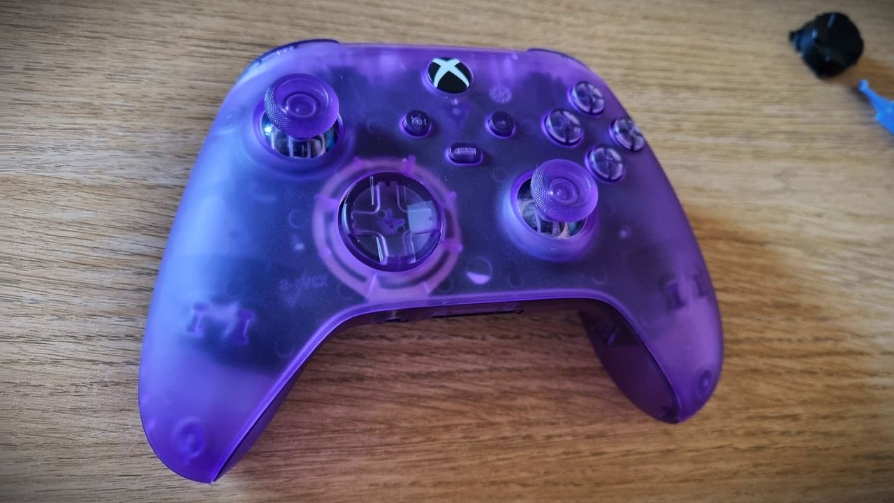

Reassembly was much faster than taking it apart, and seeing my creation come to life piece by piece was a satisfying experience, certainly giving me more accomplishment and pride than anything I could recreate by clicking some buttons on a website.
As I put my masterpiece together, it fit together like a simple jigsaw puzzle. However, I couldn’t help but feel a pang of regret for the controllers of years past that I had thrown away in the garbage due to defects with buttons. I probably could have salvaged them if I had known how easy this process was.

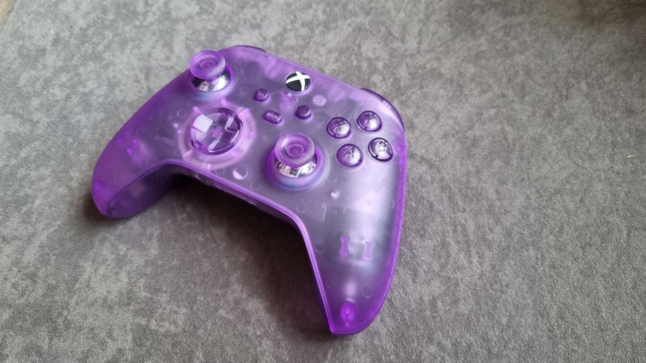

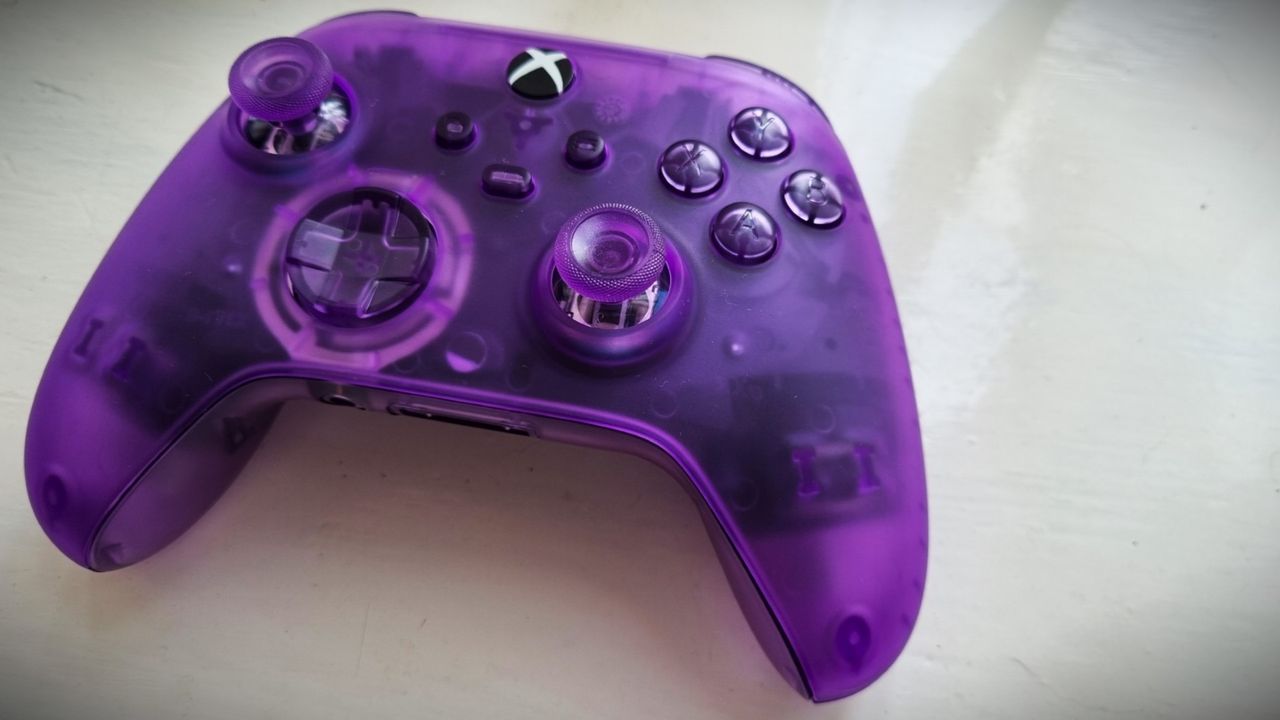

But what I did have now was a brand new Atomic Purple controller and a new skill for the bargain price of $22. The transparent shell revealed the inner workings of the device in a mesmerizing way.
Behold.

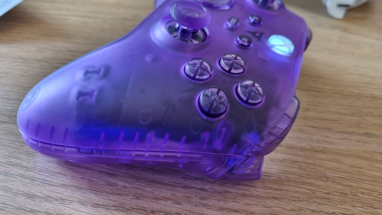

I was eager to see my new controller in action, so I quickly popped the battery pack in and pressed the power button. However, nothing happened. I felt a surge of panic as I wondered if I had messed up something during the installation. Then I realized my silly mistake. I had put the battery pack in the wrong way around. I corrected my error and pressed the power button again. This time, the controller came to life with a bright light. I felt a wave of relief wash over me and then awe as I viewed my beautiful new controller in different lights and at every angle.
Transparent accessories have always been a penchant of mine, and until now, my only gaming controller with this feature has been the GameSir T4 Kaleid, which doesn't work with my Xbox. Until now, my only gaming controller with this feature was the GameSir T4 Kaleid, which didn’t work with my Xbox. Now I can proudly say I have a wireless Xbox controller with my coveted design and that I made myself.
