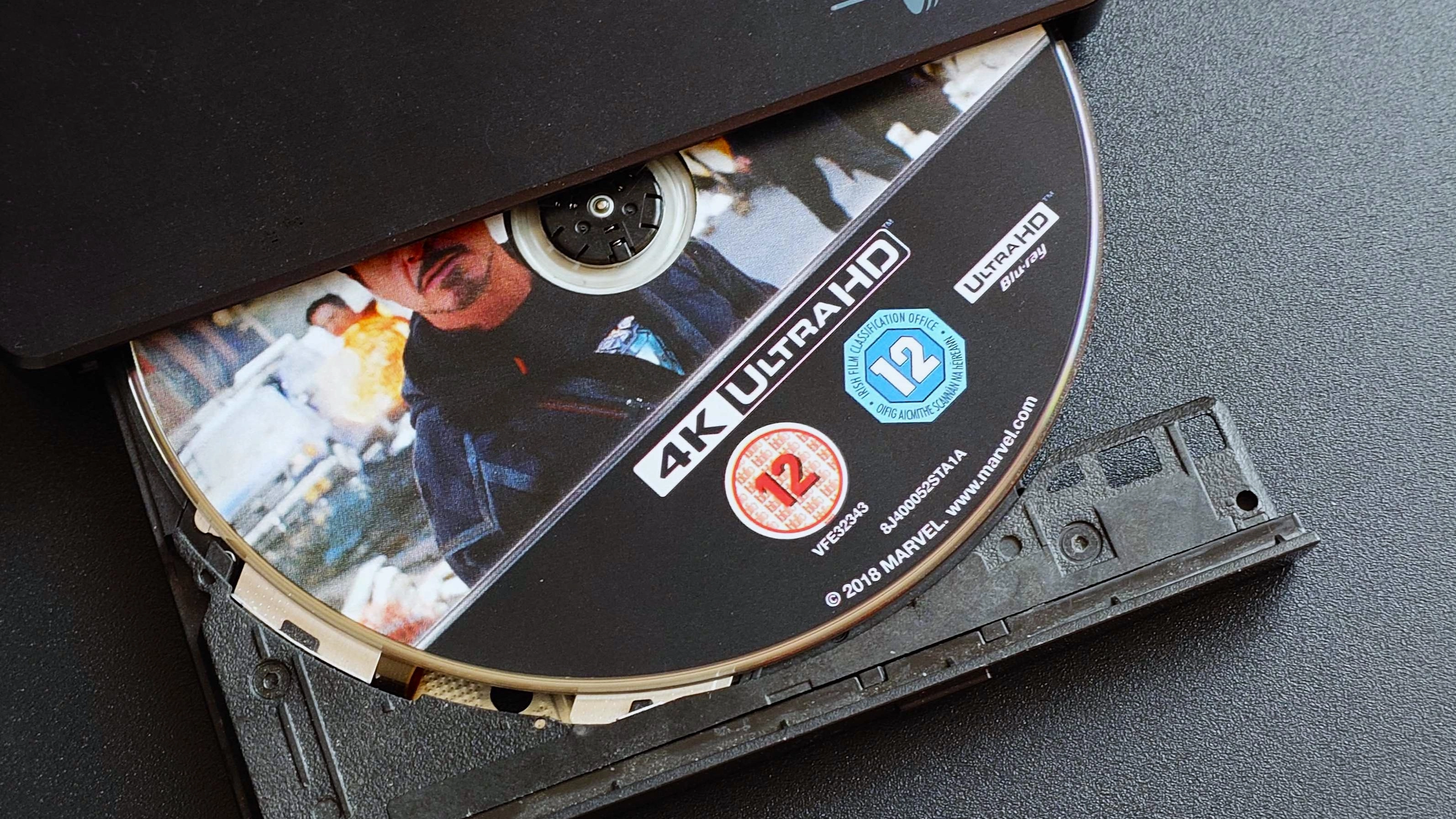

Avengers: Infinity War 4K UHD Blu-ray disc in a USB Blu-ray drive.
I don't own that many of these, but thanks to a fairly simple tweak, I can now at least digitize them. (Image credit: Windows Central)

Since my last attempt, I've acquired a number of 4K UHD Blu-rays, though, and my trusty old USB drive is only suitable for the regular 1080p kind. Or so I thought.
After stumbling on a YouTube video, I learned of a thing called LibreDrive that could, magically, make it so I could utilize this drive to digitize the 4K discs. Not expecting much, I went off and did a little digging, and whaddya know?!
With minimal effort and a little care to do things properly, I can do just that and don't need to spring for a new external Blu-ray drive. I'm a happy man.
