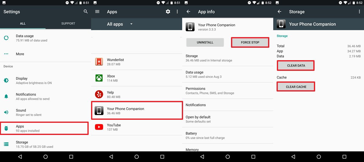

On Android, use these steps to reset the Your Phone Companion app:
  1. Open Settings.
  2. Tap on Apps.
  3. Select the Your Phone Companion app.
  4. Tap on Force Stop.
  5. Tap on Storage.
  6. Tap on Clear Cache and Clear Data.
