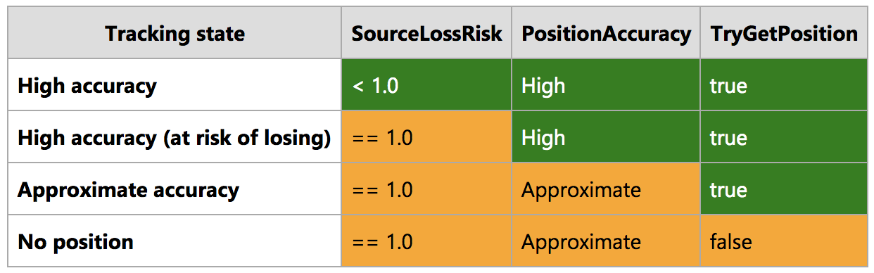

Controller tracking states courtesy of Microsoft.
While you can usually enjoy WMR without experiencing shoddy controller tracking, it will happen if one or both of the controllers leave the view of the headset's cameras for too long. When out of view, the WMR software will attempt to predict the controller's position in real time using a mix of headset position and the controller's internal orientation sensors. This is a tracking state that Microsoft calls "approximate accuracy," and is one of four states the controllers can inhabit.
Approximate accuracy will sometimes cause a bit of drifting that doesn't correspond with your hand's actual location. If the controller comes back into view of the headset before too long, it will jump back to where it's supposed to be. If, however, the controller stays out of view for too long, it might jump into a "no position" state, which means the system has no idea where it is in relation to you.
When a controller is in clear view of the sensors, it's in a "high accuracy" state. Everything works as intended, and you're able to easily point and interact. When a controller nears the edge of the sensors' view, it enters a "high accuracy (at risk of losing)" state that might affect gestures within some specific apps. Remember, most apps and experiences for WMR will continue to operate with approximate accuracy, but you won't have a very fun time until proper tracking resumes.
