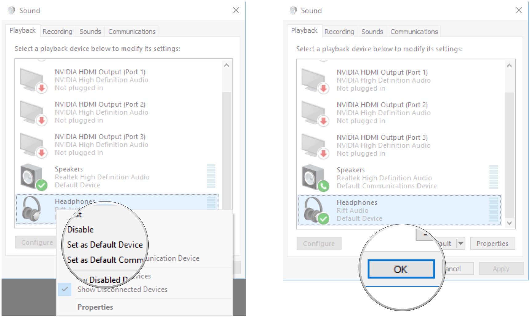

How to fix one Oculus Rift headphone not working
Some Rift users have claimed that one or the other built-in Rift headphones will stop working. While some people recommend getting new hardware, the answer to the problem is sometimes much easier.
One of the first things you want to do if one built-in Rift headphone stops working is swap the built-in headphones to see if it's a mechanical failure.
If, say, the right headphone works on the left side, you'll know it's something to do with your PC rather than your headset. In this case, your Rift probably isn't set as the default audio playback device. Here's how to change your audio settings to get that one headphone working again:
- Right-click the speaker button in your system tray.
- Click Playback devices.
- Right-click Headphone - Rift Audio.
- Click Set as Default Device.
- Click OK.
That should take care of the PC side of one headphone not working. If the problem persists, you will probably want to contact Oculus support after all, since it is likely a hardware problem.
