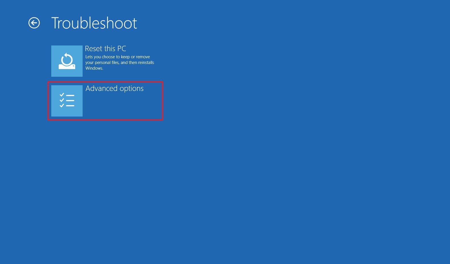

- Click the See advanced repair options button.
- Click on Troubleshoot.
- Click on Advanced options.
- Click on System Restore.

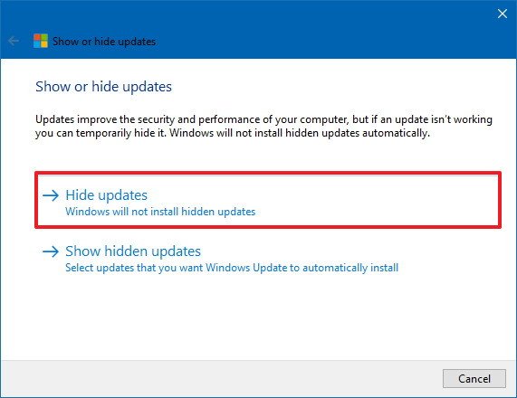

- Download the Show or hide updates troubleshooter from Microsoft support.
- Double-click the .diagcab file to launch the tool.
- Click Next.
- Click Hide updates to continue.

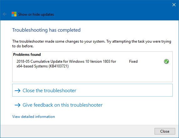

- The tool will check online and list the available updates currently not installed on your PC. Select the KB4103721 update, and click Next.
- Click the Close button.
After uninstalling and hiding update KB4103721, your Windows 10 device won't try to download and reinstall it again until there is a new update that replaces the old version.
